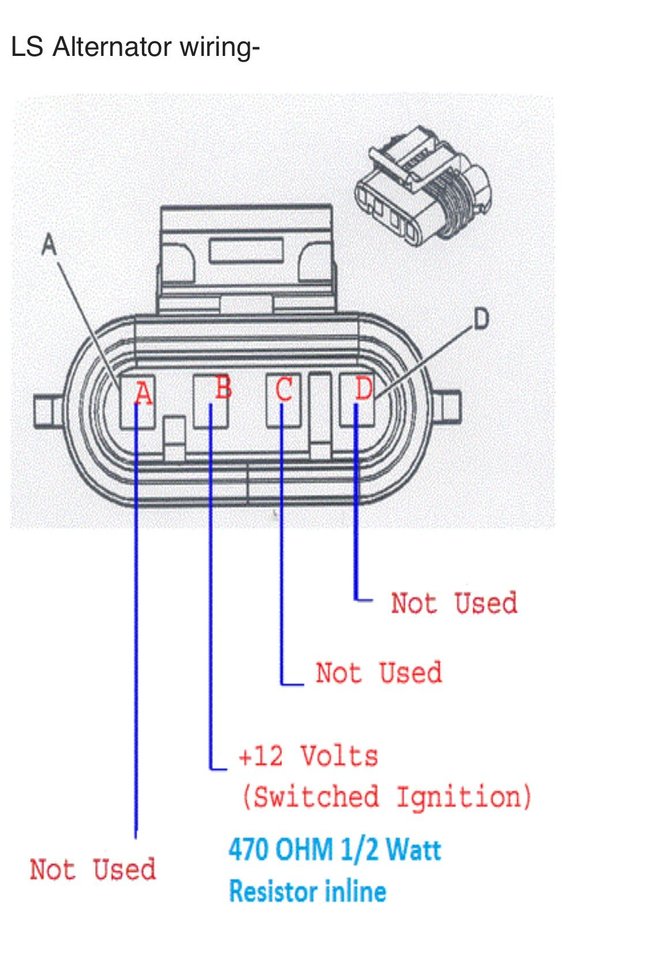

Lets state with the valeo alternator body for the C5 and the C6, are the same unit,
But,
C6 alternator voltage regulator connector,
C5 alternator voltage regulator connector,
Being that the rebuilt Duralast alternator has the one way pulley on it, that is only used for the Auto transmission models,but they are pushing it for the manual trans as well, guess which voltage regulator it may have in play as well.
Hence the reason that the unit is causing problems on the C6, its the wrong voltage regulator in play on the unit to start with.
To Service Charging System
Old Sep 20, 2023 | 08:34 AM
Choppin's Avatar
Choppin
Cruising
Joined: Sep 2023
Posts: 12
Likes: 5
But,

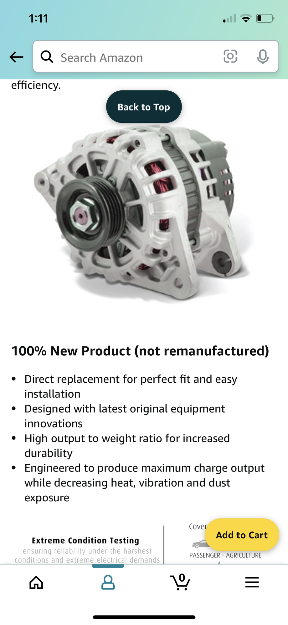

this was a super helpful illustration. Chevy tech diagnostic came back with nothing wrong. The next step on the sheet is to replace the Alternator. GM near me is on back order for an OEM alternator and it’s $900. I found a Valeo one on Amazon for $311 shipped.
https://amzn.to/46dr5Fo
will be here in a couple of days. I’ll update back once the Valeo brand has been installed.
Old Sep 20, 2023 | 10:41 AM
C5 Diag's Avatar
C5 Diag
Moderator, Tech Contributor
Posts: 15,595
Likes: 4,055
From: Cape Coral, Florida
Buying parts like this on Amazon is sketchy...most likely a reman and whether it will work is hit or miss.
