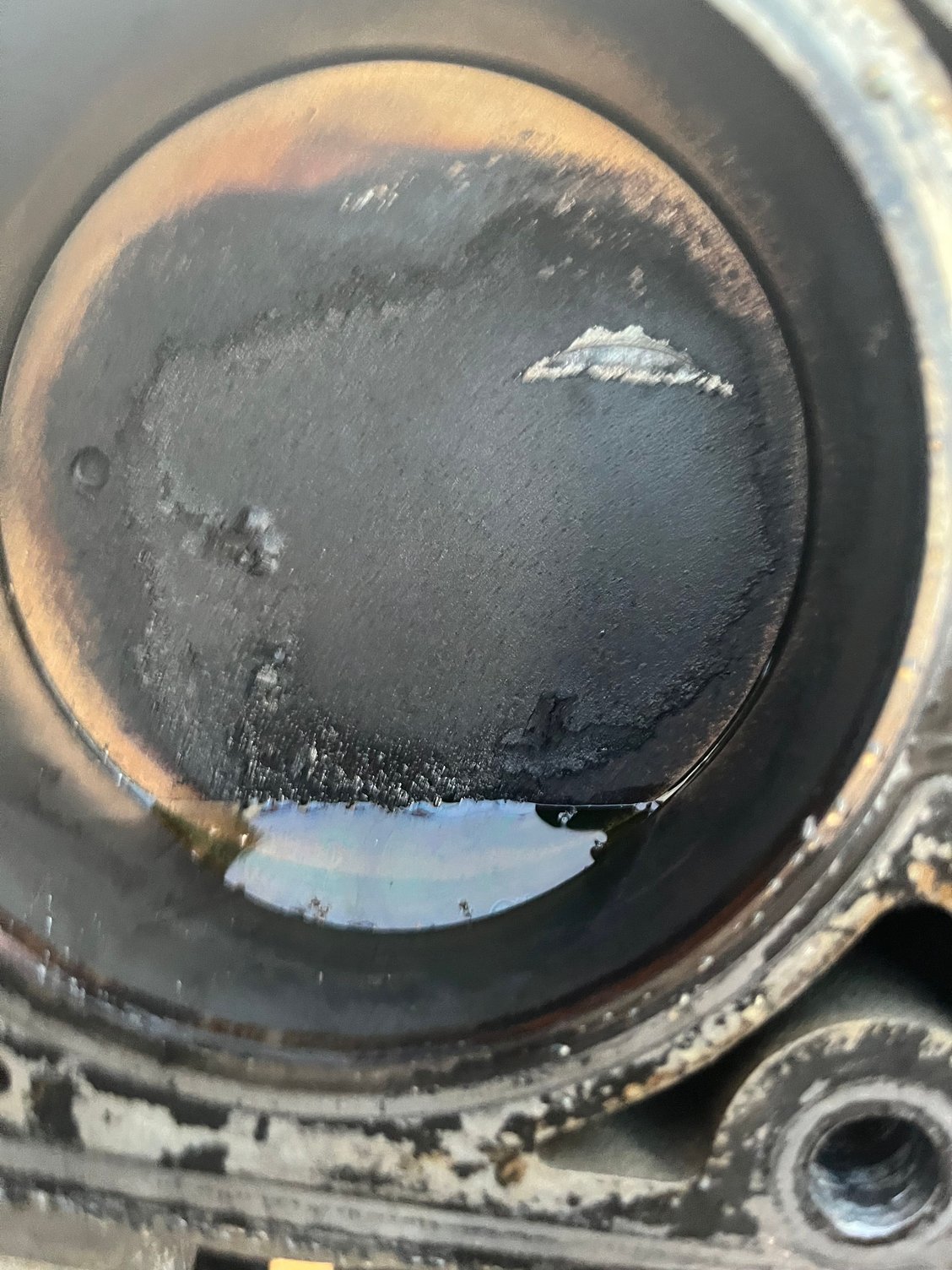

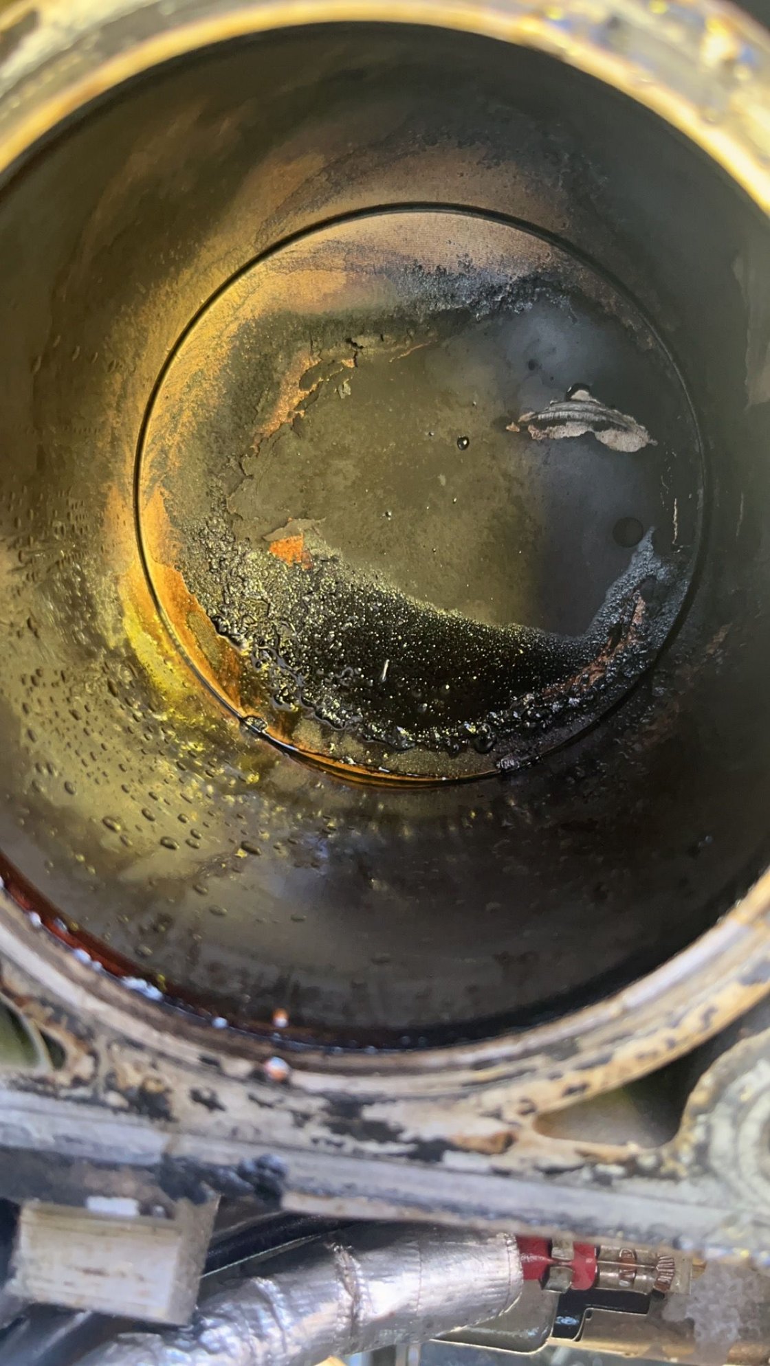

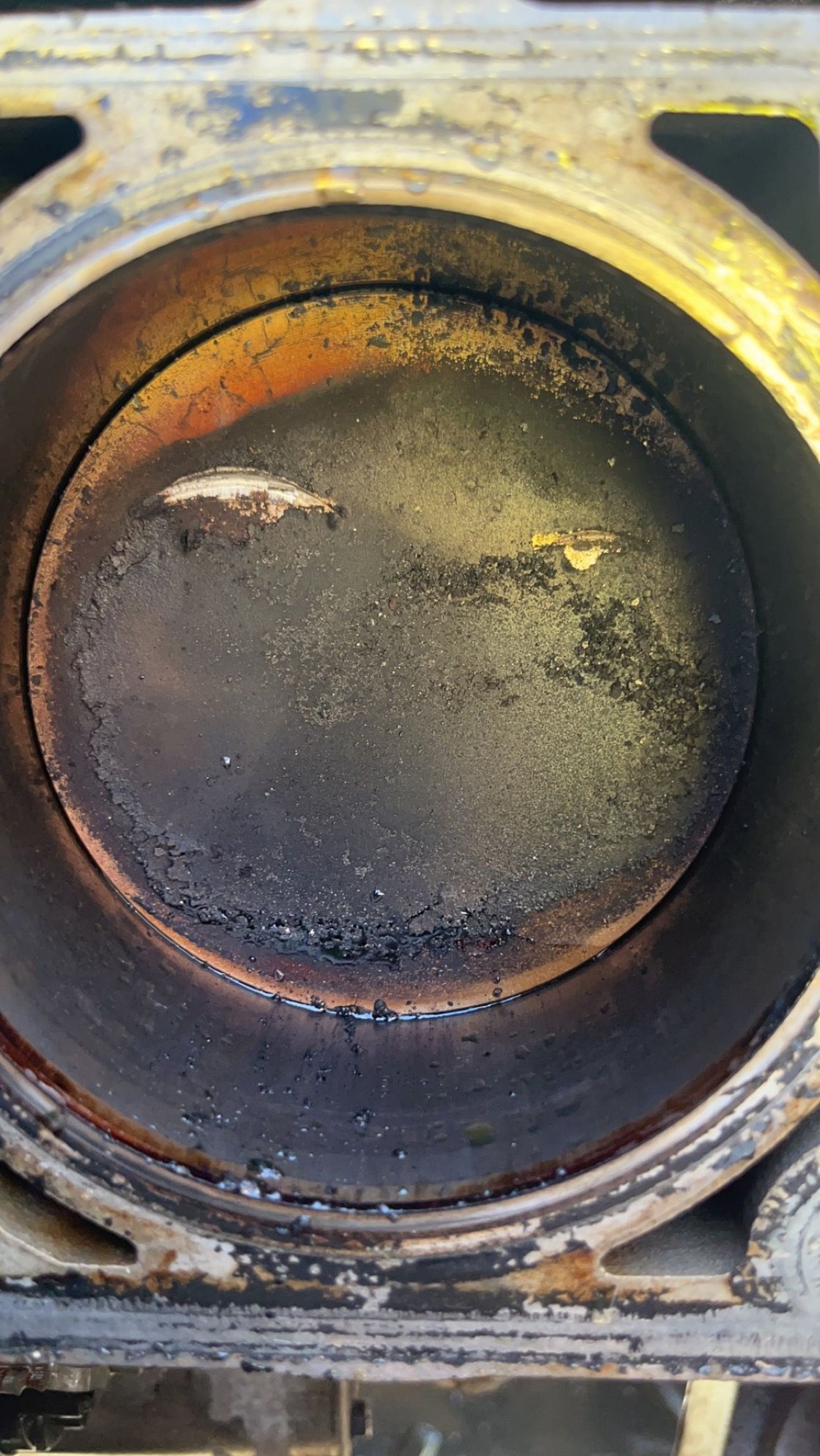

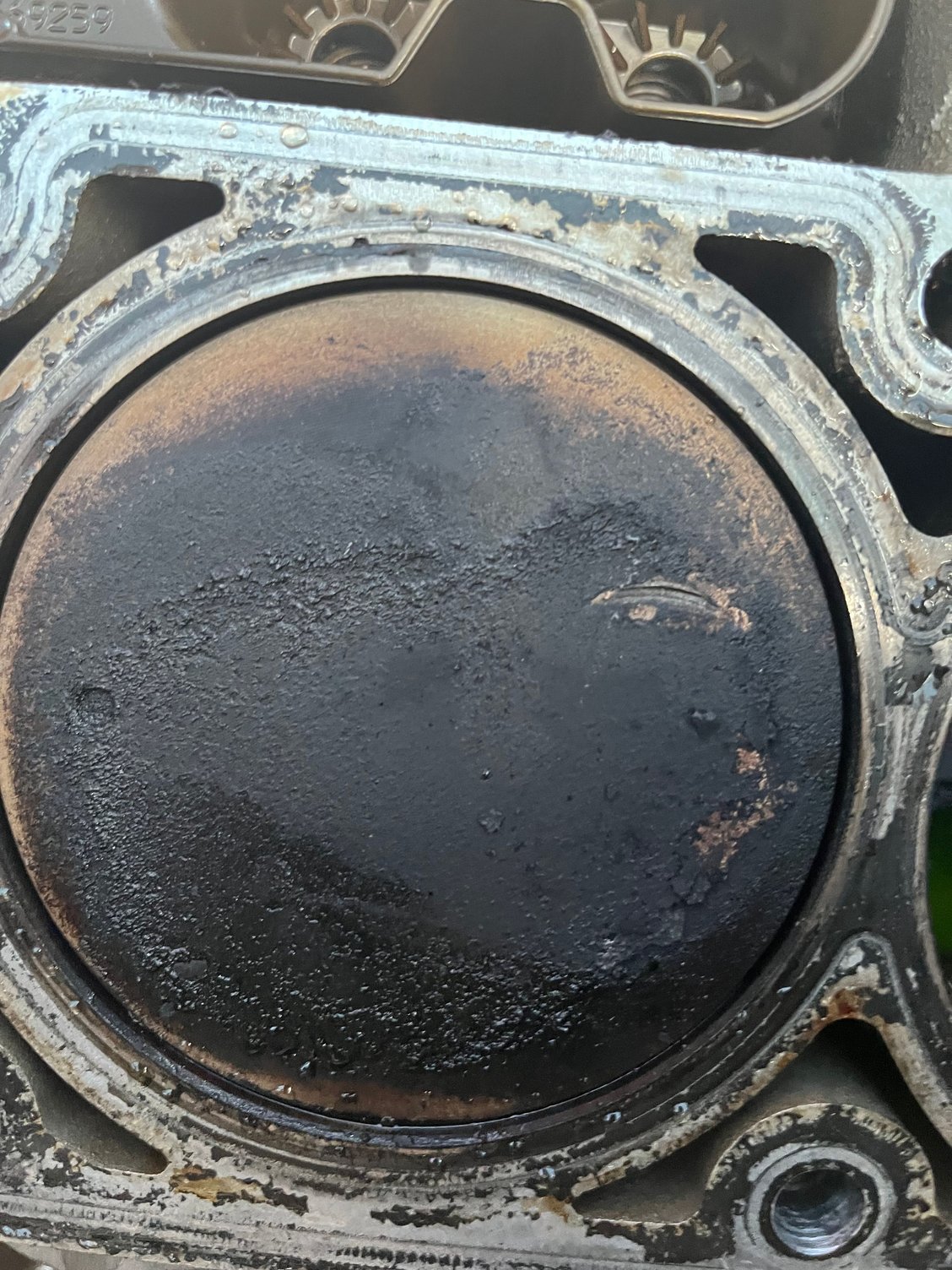

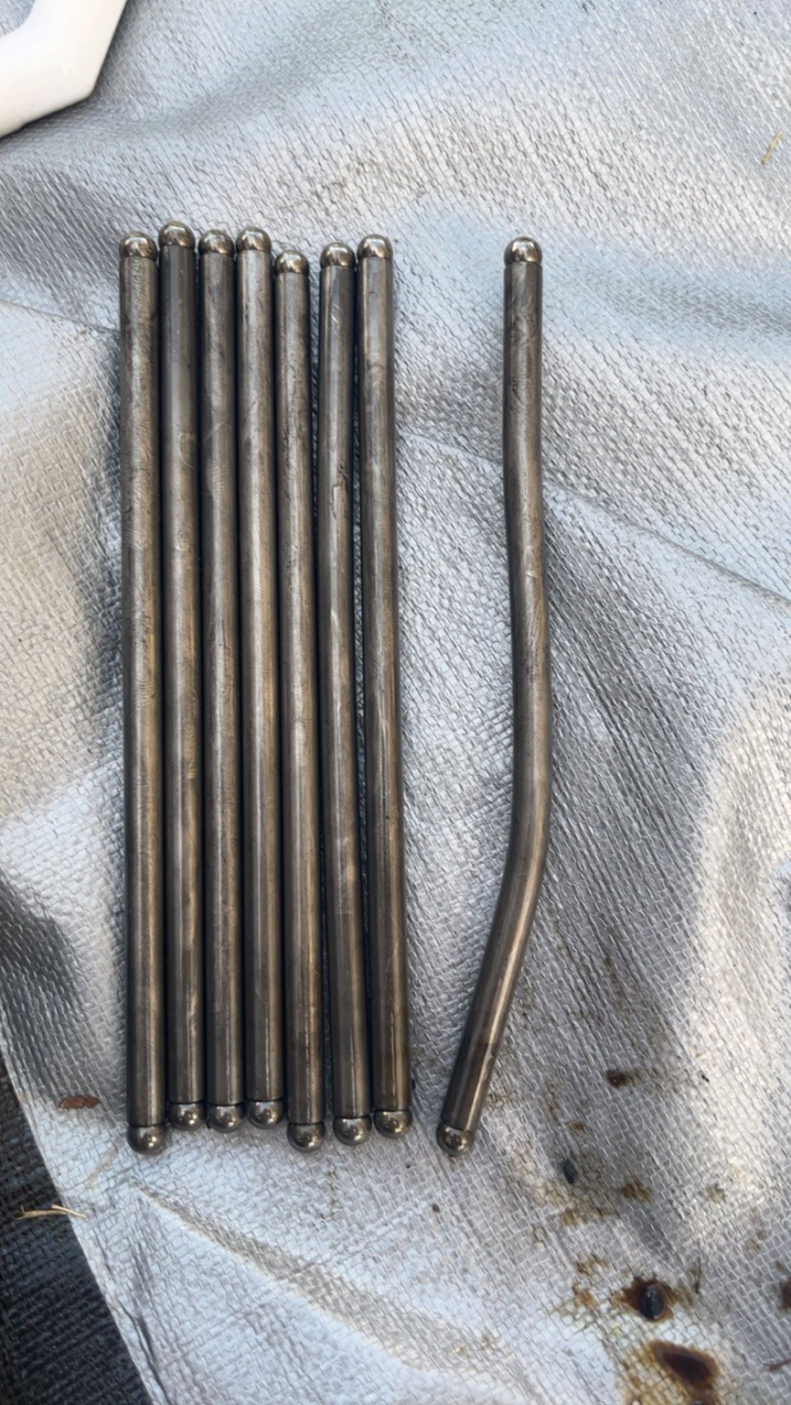

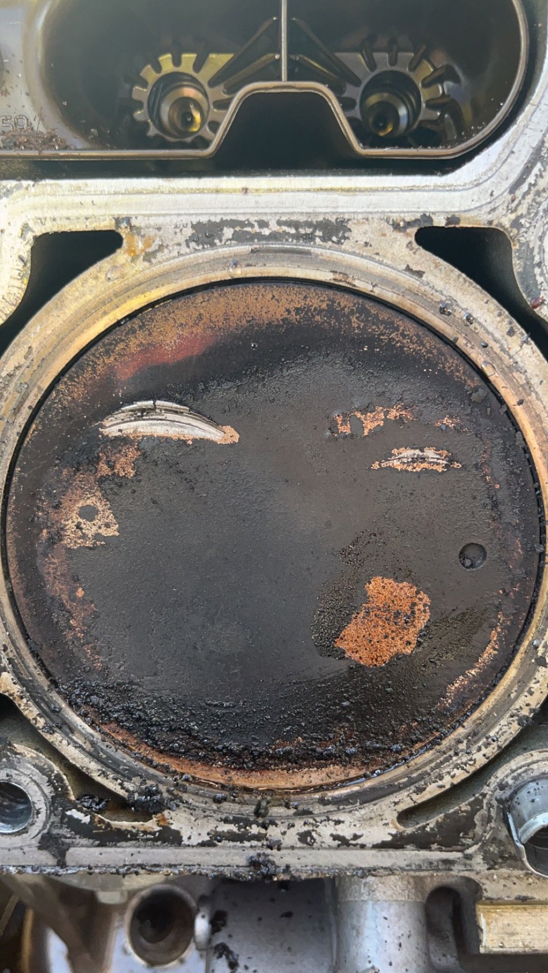

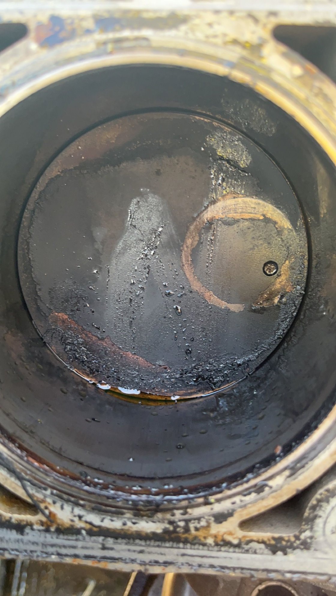

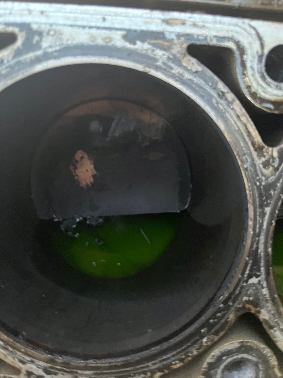

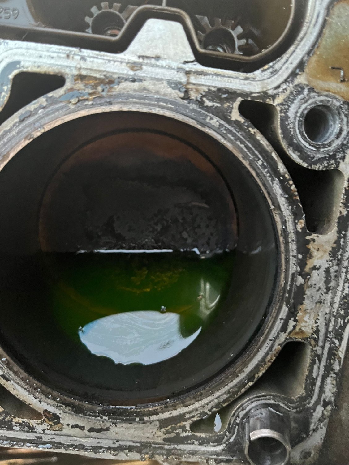

Hey guys! My timing chain snapped while I was on the highway about a week ago so far I have pulled apart the engine and the bottom end looks good but I think I’m gonna need the top end rebuilt I’m wondering if it’s possible to do the necessary repairs at home? I’m replacing the pushrods and valves but what else? Do I need new guides, springs, or rocker arms? What else am I missing, or would it just be better to take it to a shop I am also wondering if I might need new pistons, I think they will most likely be okay but I might as well get more opinions.
Pushrods I pulled from the passenger side head

If you remove the oil pan, then you could slowly turn the engine over by hand and carefully examine each connecting rod as it comes into view. Also, if the engine turns over smoothly, that is a good sign. In addition, you could measure from the block deck to the top of each piston at TDC. All of those measurements should be very close to one another. If one piston is indicated to be lower than the others, that is a sign that that connecting rod is bent. All of this is not as good as taking the engine to a machine shop to have them examine it, but it is better than nothing, and maybe that is what you are looking for.

using a dial indicator, you can check the rods. Any rod that is bent will give the piston less lift / height in the cylinder. . Usually best done with two people. One turning and one measuring.
Drop the oil and see if there is a large amount of metal in the pan, if so, I would do a complete tear down.

I wouldn't even think twice about doing a complete rebuild. None of those parts can be trusted after the pistons smacked the valves.
I'd even consider a different engine altogether.

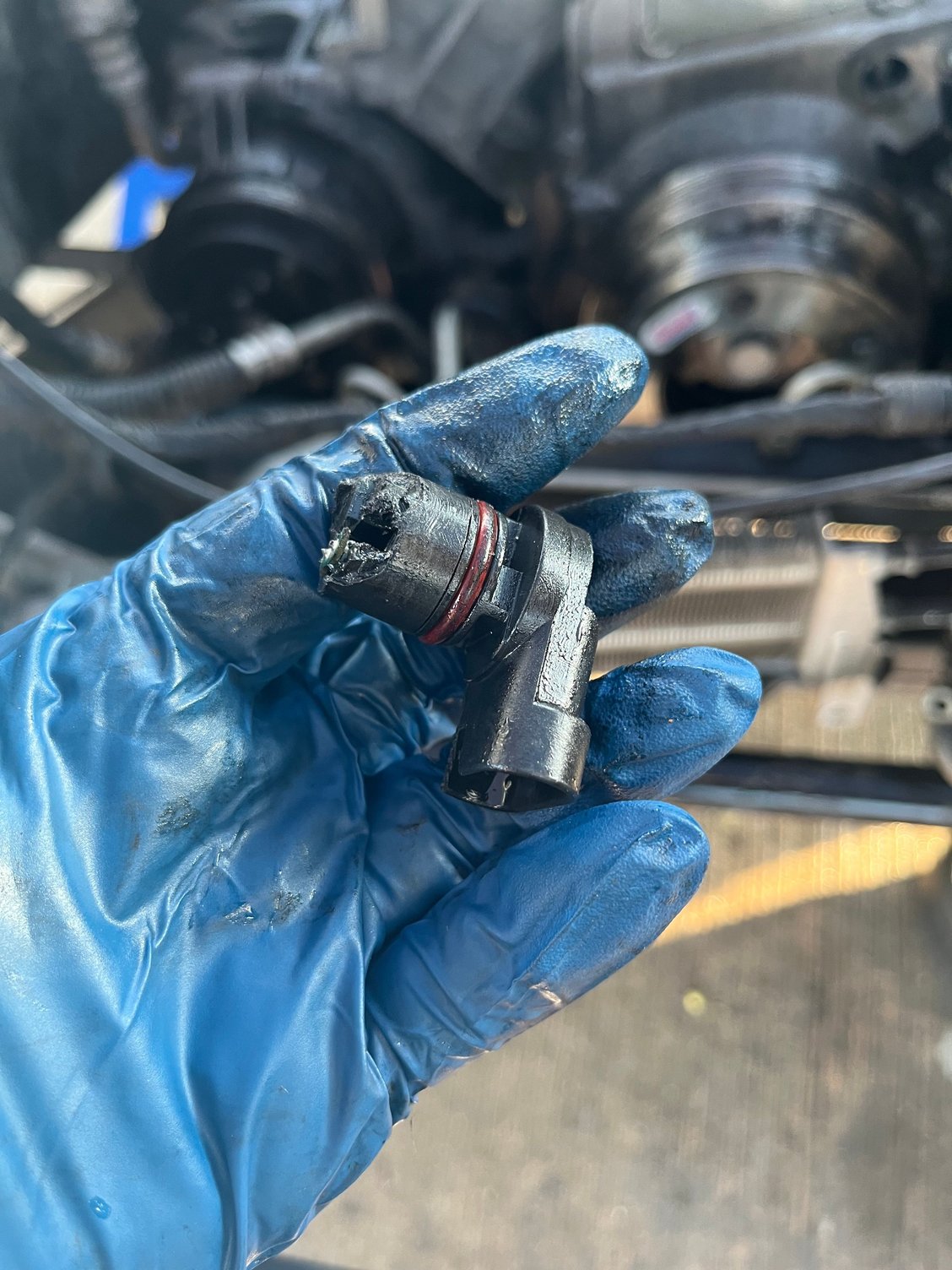

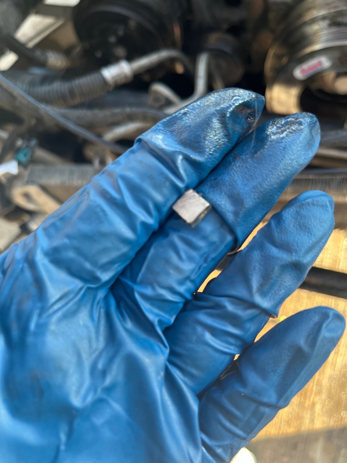

I believe one of two things happened, either GM was cheap and reused a ls1 chain which I have heard is much more prone to breaking, I also noticed that the cam position sensor was chewed up pretty bad and there was a small magnet stuck in the chain, it looks to be a cheap aftermarket one that one of the previous owners installed, I think it’s possible it may have broke and somehow took the chain with it?

I would definitely get new pistons, valves, valve springs and pushrods and make absolutely sure the con rods are ok.

Yeah, agree that there's no way I would trust those pistons. Rods and crank are probably OK. I'd replace/rebuild everything above the pistons. Another option is to go with a middle aged LS2 take out that hasn't been opened. I've had pretty good luck with those on stock type stuff. Most of the yards will give you a little bit of a warranty. Buy the engine and don't delay putting it back into service. Being in Dallas, you also have easy access to Houston, San Antonio, and Austin yards.
