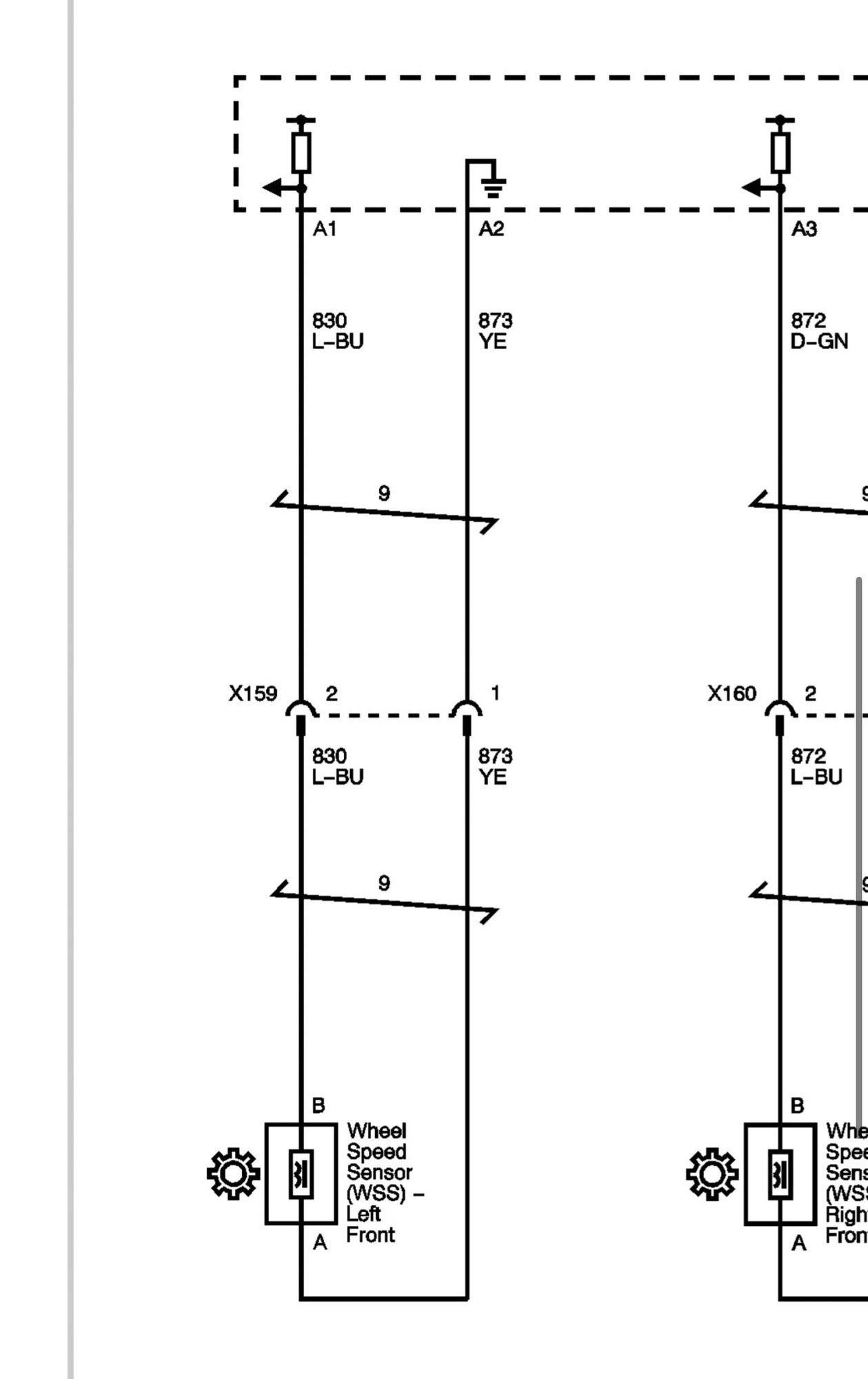

Old Oct 29, 2023 | 09:43 PM
PDsVettes's Avatar
PDsVettes
Joined: Dec 2005
Posts: 877
Likes: 102
From: TX Hill Country
Hope that these wiring diagrams help.
To C0035
