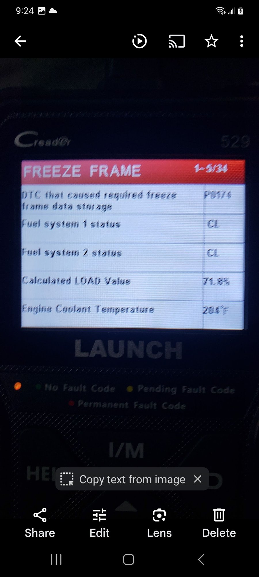

Forgot to mention about using “freeze frame” data to diagnose this…if freeze frame data showed that the code set at idle it’s a vacuum leak.
https://youtu.be/9gJoH5_Thaw?si=QWpjmYV_LNG9MXTH
thank you. I'm not sure what I'm looking at, these freeze frames were taken a couple months back when the last code came on. Looks normal to me? Of course like you suggested I need to look at the idle data as well for comparison.

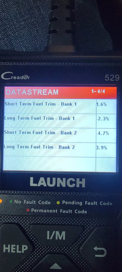

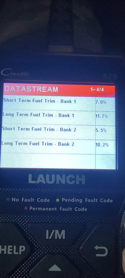

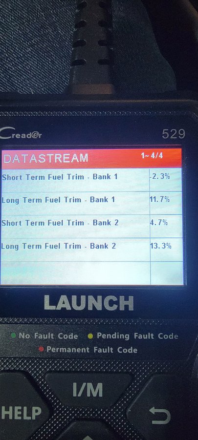

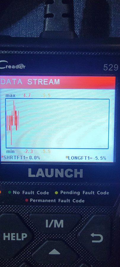

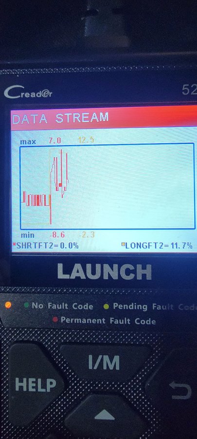

This info was very helpful. So at idle all trims are low, at 3k rpms everything goes up, except short term bank 1 which goes negative. So would this be a dirty MAF or fuel delivery problem? Odd that only one parameter when negative on Bank 1.

Idle bank 1
Idle bank 2
3k rpm bank 1
3k rpm bank 2
