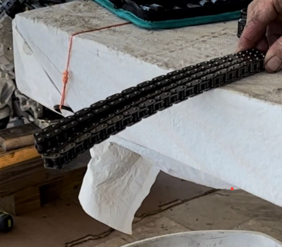

What a learning curve this has been... clearly the DRY SUMP. LS3 is different than base and most available information pertains to the base model LS3 and not the grand sport dry sump LS3.
Case in point, when trying to find the recommended chain tensioner for my grand sport, everywhere you look states to use the C-5R chain and LS2 style tensioner/guide. I purchased the Comp Cams C5R chain... comes from the same manufacturer who makes the chain...
only after disassembling my Dry Sump LS3 did I learn that it already had the LS2 style tensioner...
fast forward... I decide to install the newer LS2 style tensioner because hey, new parts... BUT the plot thickens... it's a different tensioner and does not fit under the dry sumo oil pump. 🤣
So original chain and original tensioner went right back in....
Also, I noticed that the C5R chain has much more looseness... it just did not feel as tight as the original factory chain... here is a pic showing how much the sag rate this chain had compared to a stock 40,000 mile chain... now this is far from scientific... but I would expect a new chain to have tighter links.
so I have confidence that the used factory chain is tighter than the new C5R chain.
it's all going back together now... cam, valve seals, springs and rockers have been installed... going to finish up with the timing cover tomorrow and start removing the clutch.
