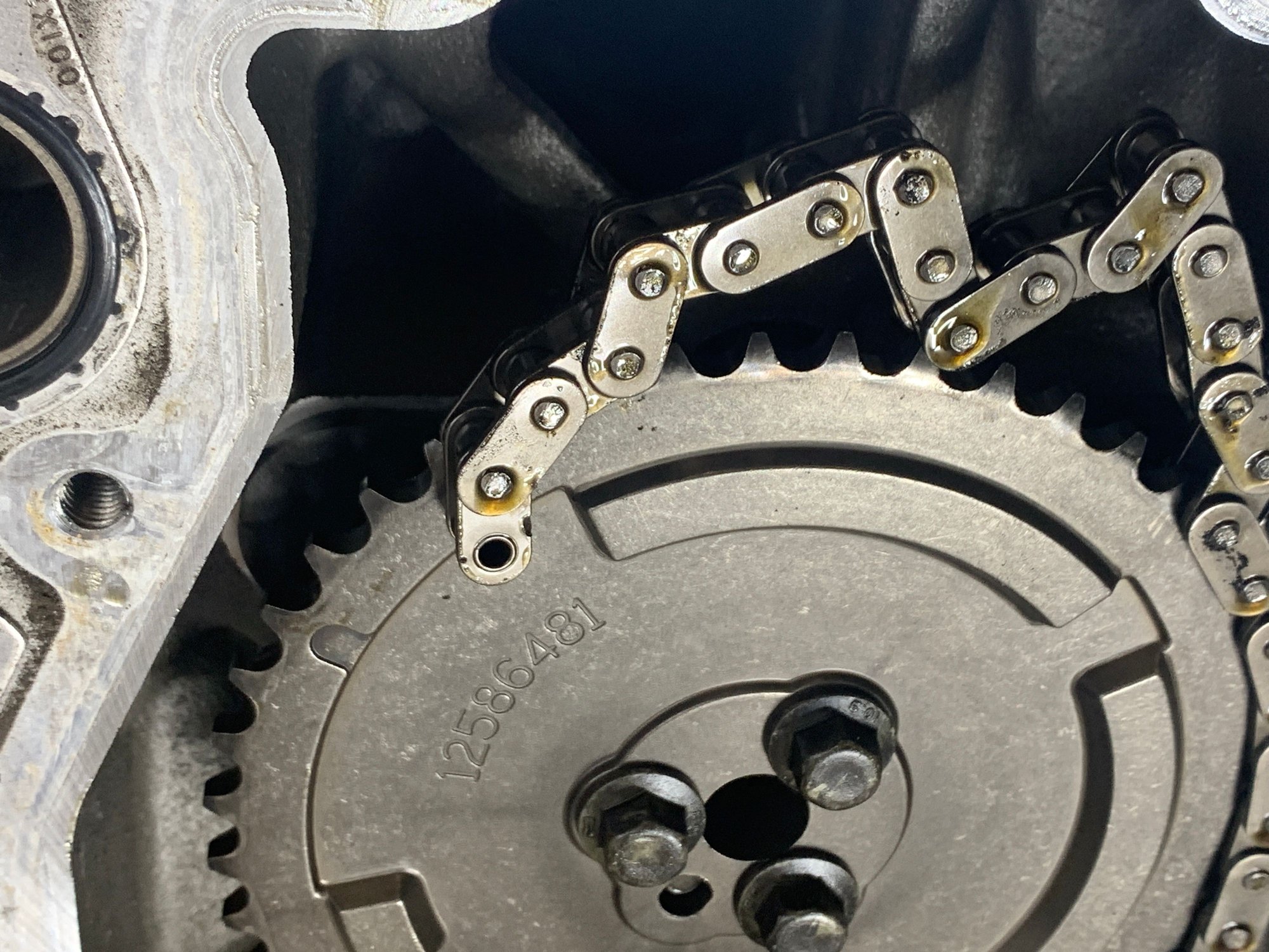

For those who care to know...
the GrandSport M6 with Dry sump come with the 3-bolt cam sprocket and the LS2 style tensioner...
**ADD** also I noticed that the timing chain is black... is that typical of all LS3 engines? Doesn't appear to have much slack in it after 40,000 miles...
SPEED SAFE, NICK

interesting the Dry Sump LS3 would have a different cam than the wet sump? Similarly a 2006 LS2 in my shop had the 3 bolt, my 2007 LS2 had the1 bolt. I stole the pulley out of the 2006 for my engine.
btw here is the broke 2006 LS2 chain.....the broken link jammed into the block, causing half of the pistons to hit
valves.
btw here is the broke 2006 LS2 chain.....the broken link jammed into the block, causing half of the pistons to hit valves.
also... I'm not sure if it's different for the LS3 or not... but the timing chain is black... is that typical of all LS3?? Perhaps the dry sump LS3 has a different chain?
i'm just curious, there may be no difference at all...
SPEED SAFE, NICK

No need to change the timing chain or guides if there is no wear. And if your engine has only 40K miles, the chain and guides will still be perfectly new.
And if you have the manual GS with the dry sump, you already have the better guide/damper. All dry sump cars (manual GS, ZR1, Z06) have a 3 bolt cam and the LS2 style dampener. Auto LS3 cars have the spring loaded.
Probably not too relevant for the short timing chains in our LS engines but in a lot of Mercedes V8's, it is better to re-use the "old" timing chains when they do an engine refresh even if the engine has over 100K miles. As long as the chain has no stretch (and they usually don't), the old chain has less friction as all its surfaces have been smoothed.
