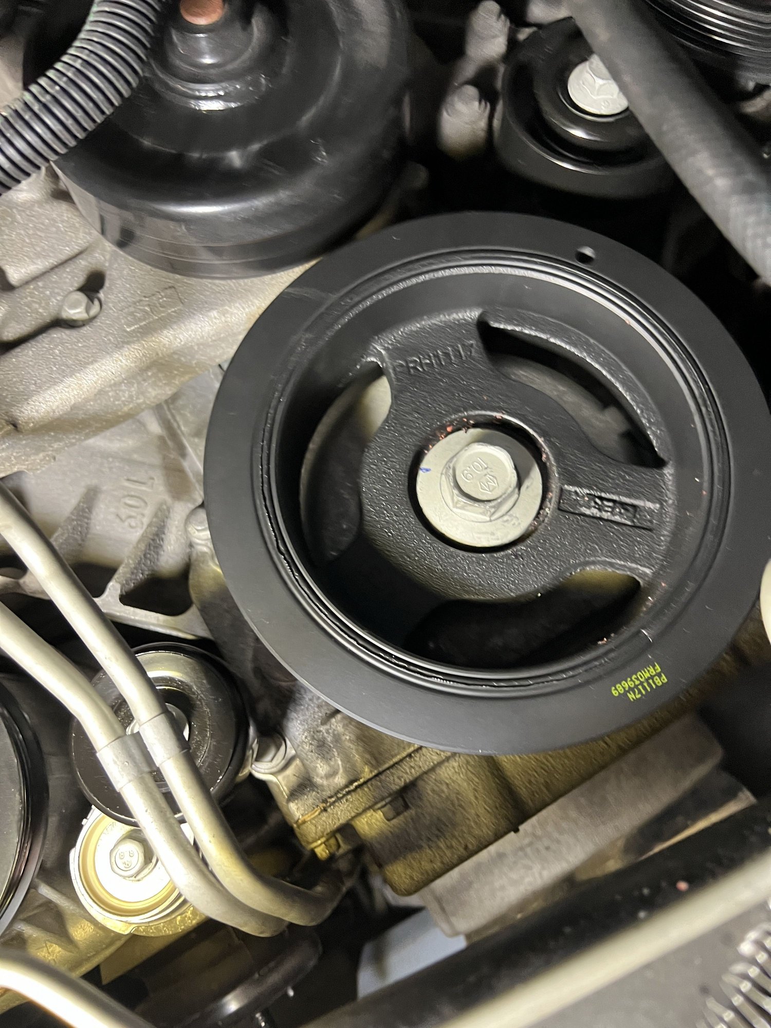

Well about five hours into it going real slow, wheels off, upper control arm bolts out noting washer placements, shock bolts out, engine supported, cradle supported and bolts removed, and I now have a good view of the HB... waiting now for 24mm socket and flywheel locking tool to proceed

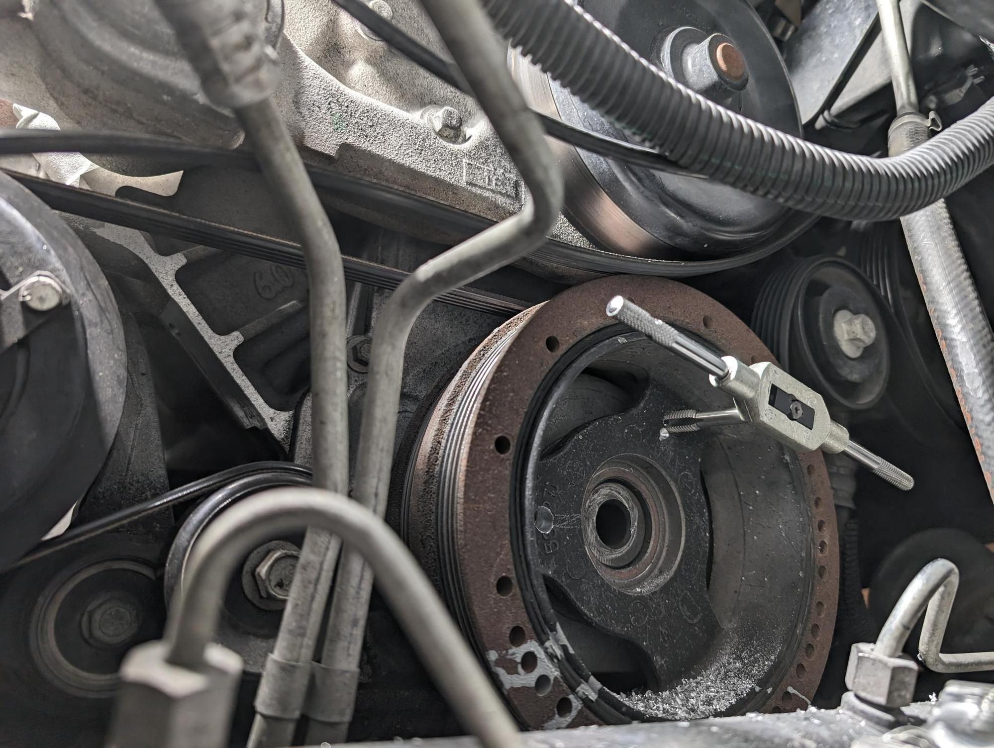

What really helped me was the socket from this vid;
Together with a 1300nm impact wrench is came loose in 3 seconds!

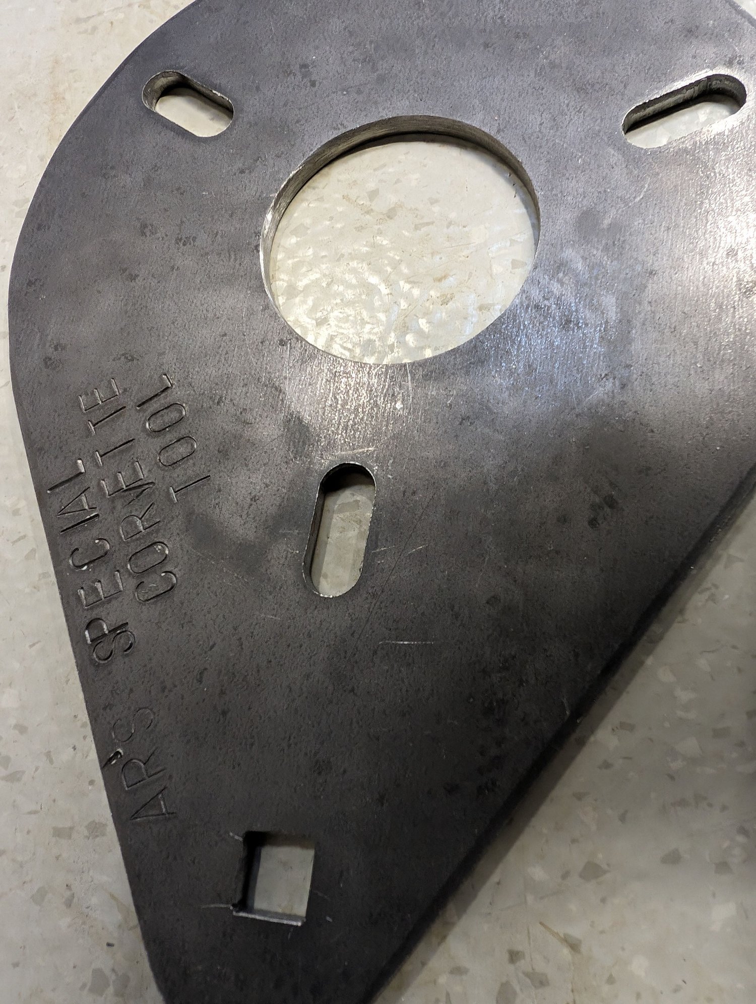

I used the Summit Racing balancer. Made the tool for holding the balancer when set it on torque myself.

New HB installed using GM TTY bolt following manual specs for tightening 140 degrees past the initial 37 ft-lb torque. Reassembled with new idler and tensioner parts, both belts new as well. I am so glad I did not go through the 'remove the steering rack' technique. Started up and completed test drive, zero problems, and no more wobbling HB

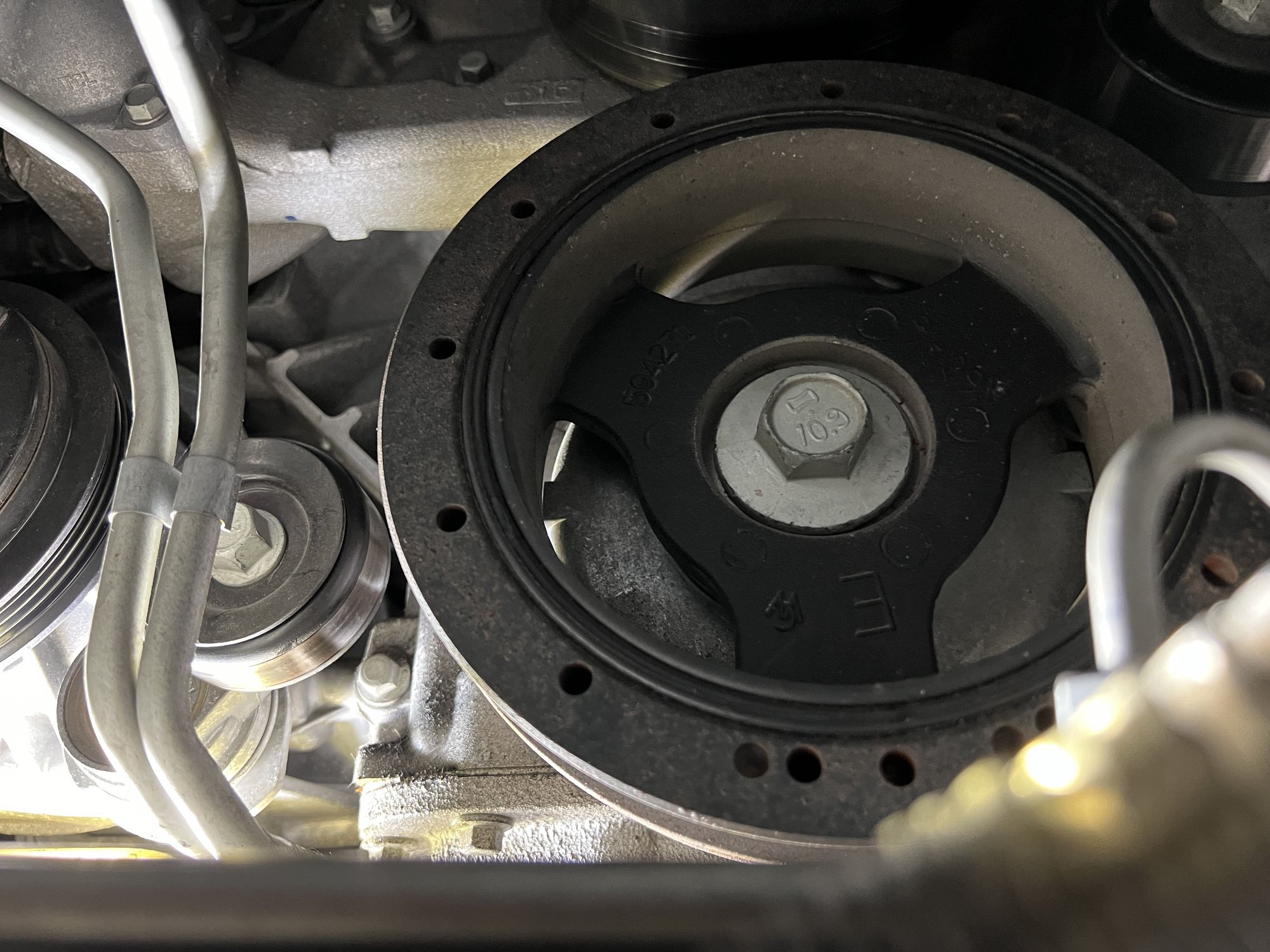

Did you notice brown stains on motor mount? were they bad or even checked????????

Motormounts checked.
Clean and looking fresh.
Im the 6th owner 89000 mls, and dont have the complete history of the car.
(imported the Vette from Sweden, there it drove since 2011. It started its life in CA the first 4 years)
The way they look i think they have changed already.

The link you provided that I quoted above shows brown staining on the motor mount like I have on mine. I was trying to see if you saw this and checked your mounts. But I guess that link is not of your car but someone else's car.
