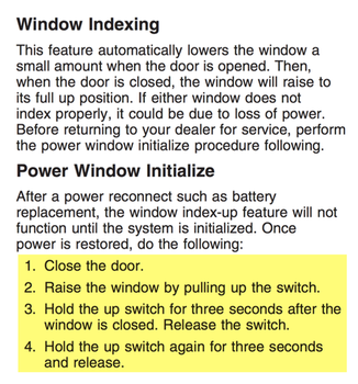

Try the battery disconnect/reconnect to reset the modules. Also, you will need to reindex the windows after the reconnect. Procedure follows:
Report back on results...GD

As a point of clarification...you disconnected/reconnected the main battery, but you did not state if you re-indexed both windows following the reconnect? Be sure you are in the car with both doors closed when you reindex.
