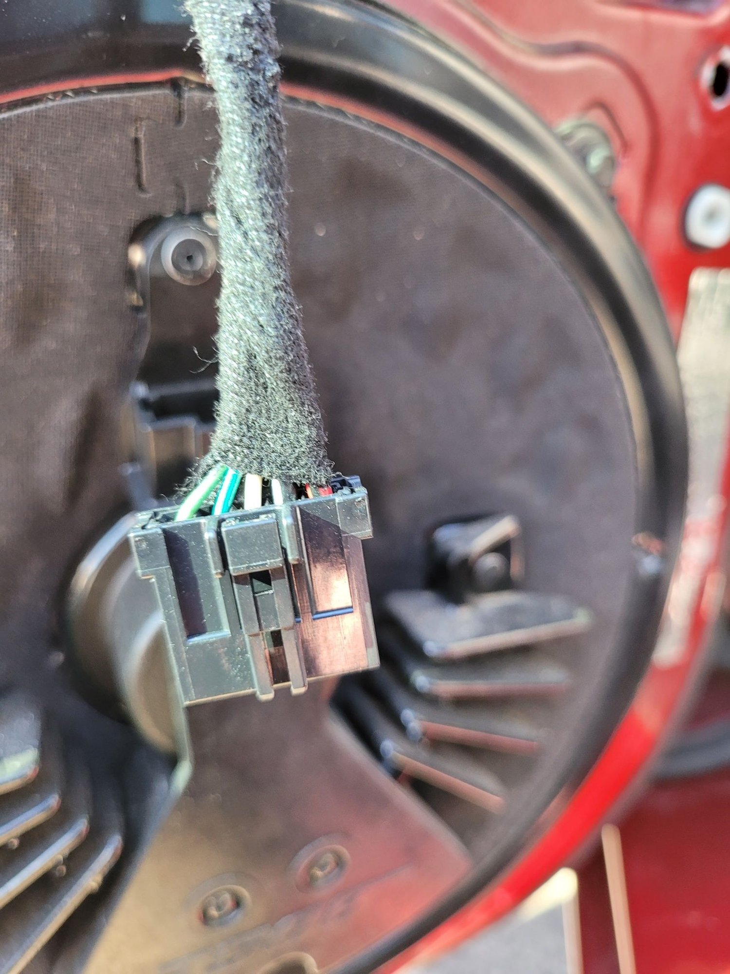

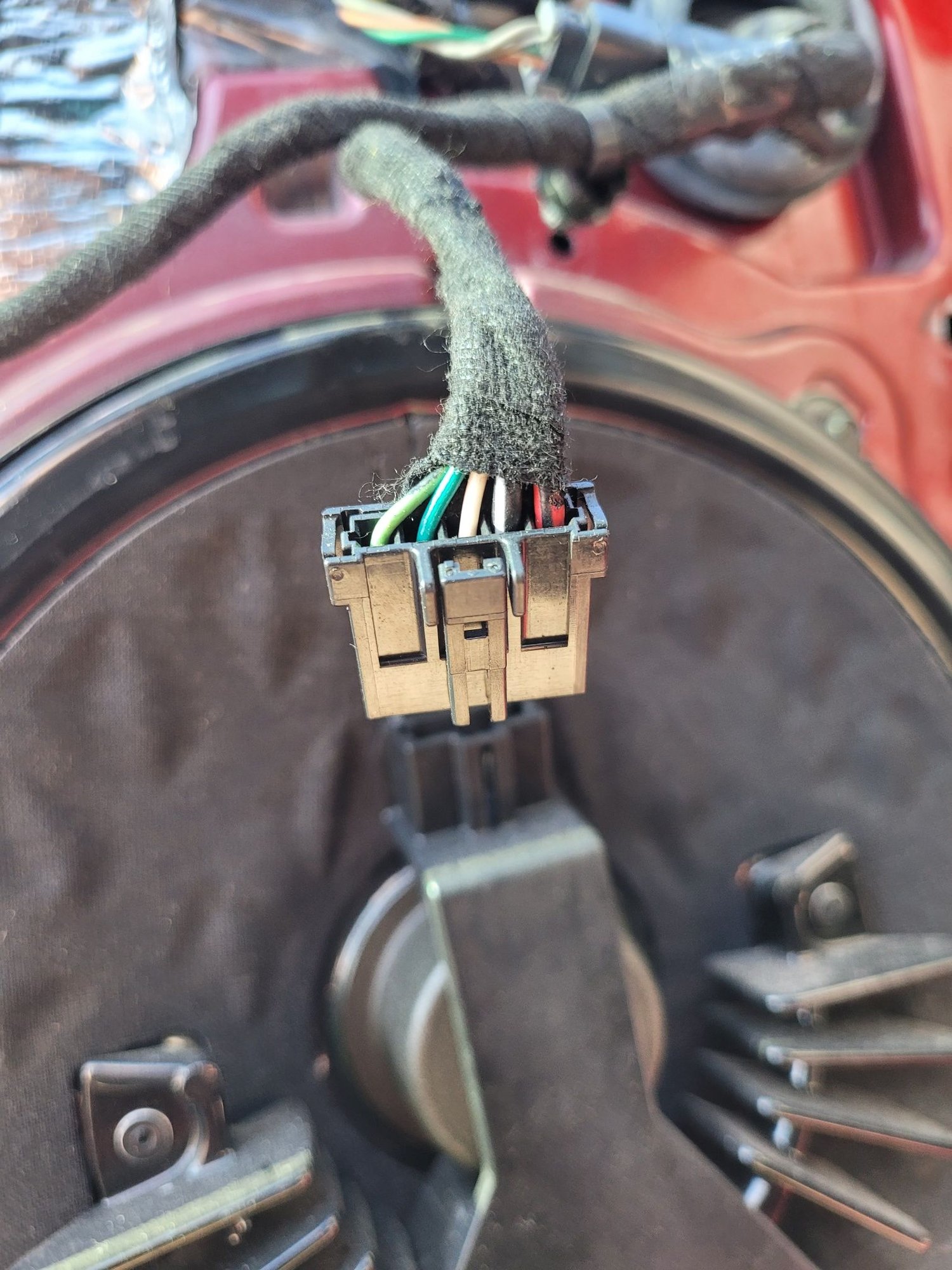

I need help Please. This is the plug to my 2007 C6 Bose Base speakers in the door. I need to find an adapter plug, or instructions on which color wire to use to connect too, to install a new set of Kicker speakers. I cannot find any references to this plug.

What wire connections do you need for the Kicker speakers? Is it just positive and negative. Do you have the Bose Premium System with the NAV/Radio? Just look at the wiring diagram and you should be able to figure it out. If not, let us know what the problem is and what system you have in your car.

Thank you for your help. I was able to connect the new speakers using the schematic you posted. You are a real life saver....
