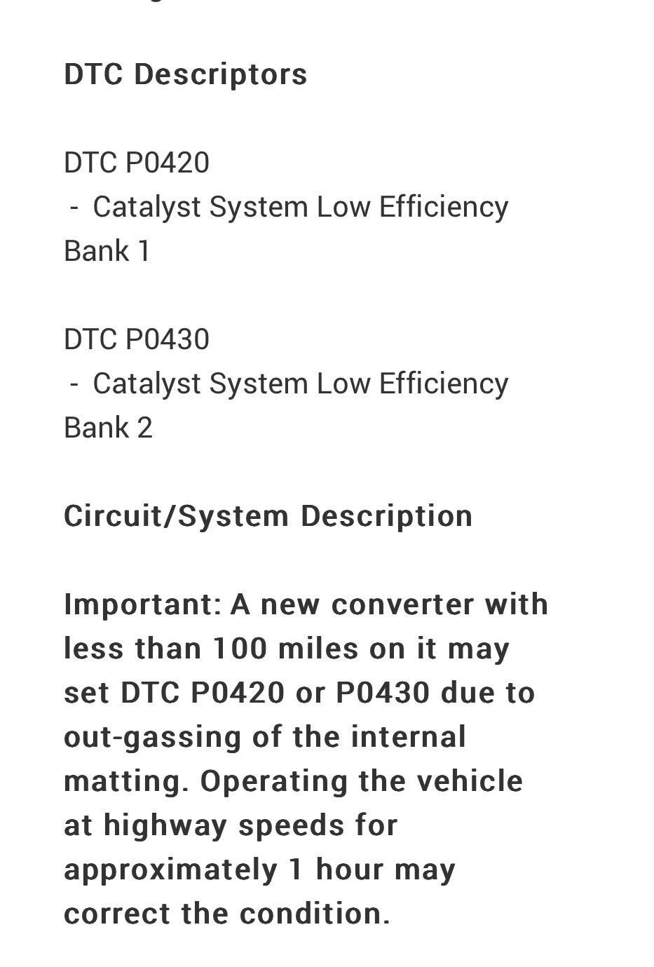

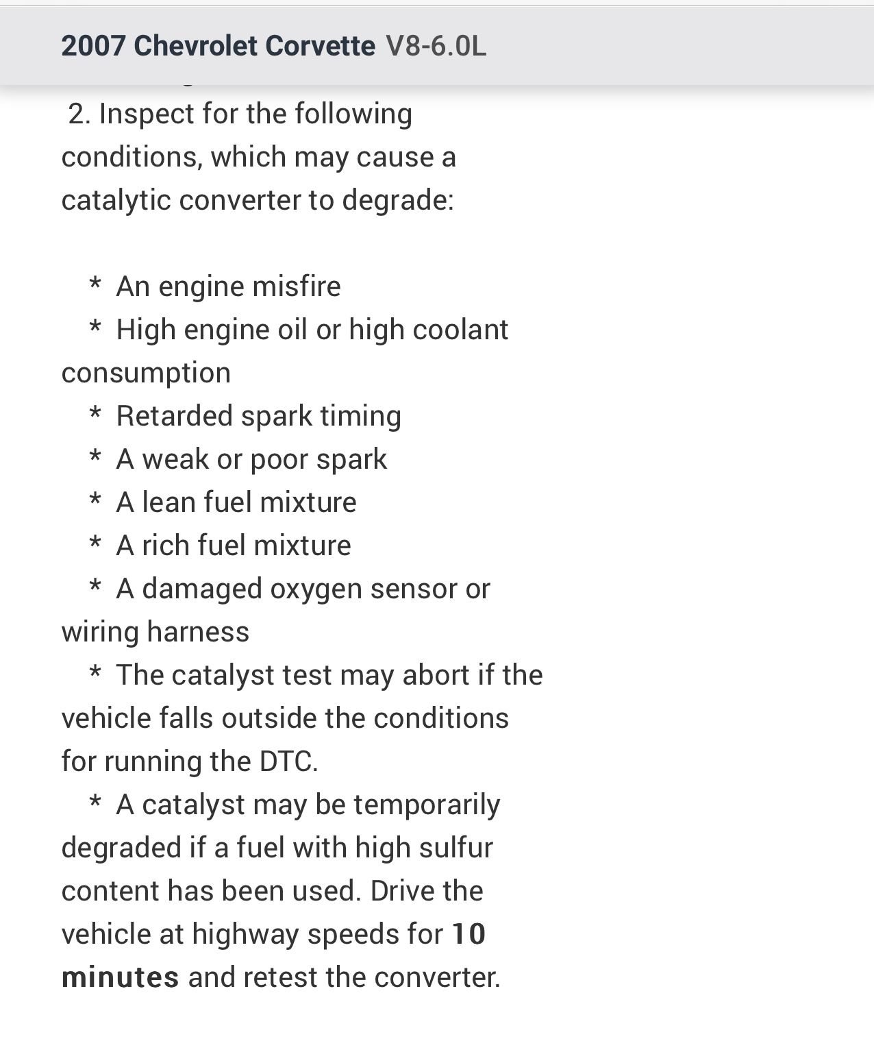

Old Dec 6, 2023 | 03:12 PM
C5 Diag's Avatar
C5 Diag
Moderator, Tech Contributor
Posts: 15,595
Likes: 4,055
From: Cape Coral, Florida
This is Service Info for your 07….nothing in here about a possible programming issue…no Tech Service Bulletins either that I have seen !!
