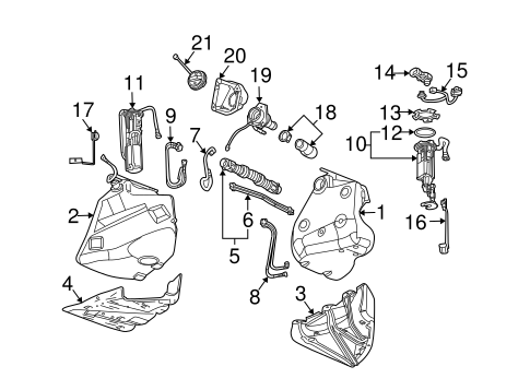

Most likely the metal feed hose in the center connecting the two tanks. They often get damaged when you remove them and dealers wont put them back without replacement. Here in Canada I see it in stock at many dealers and you can get the OEM part from amazon and many other places. They are probably just taking their sweet time with your car because they rather do the easy stuff first and warranty work doesn't pay well. They can over night that part if they really wanted to, the UAW strike mostly just affects parts for newer cars.
Nothing is on back order for our fuel systems, sounds like they are trying to pull every card possible. Wouldn't surprise me if they dropped the fuel tanks for nothing when the issue was electrical so now they pull out the shortage of part excuse so they can take their time putting it back together.

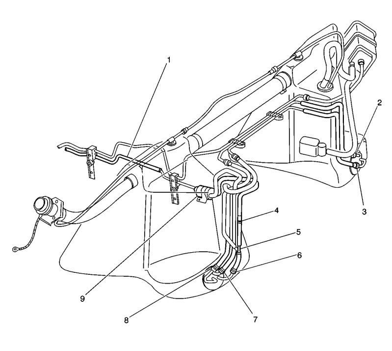

That’s a great question - one for which I don’t have an answer. They’ve simply said that it’s part of the repair process called for. Based on what little I’ve been able to find, I BELIEVE that he’s talking about the return line from tank to tank. When I showed him the diagram of ten different fuel lines, he said that it’s a steel line (which makes no sense to me).
Note that this diagram is for early C5s. The C6 is pretty different. On the C6, the openings for the pumps are on top, and almost all of that plumbing lives inside the tanks.
I don't see any fuel lines in the Special Coverage Adjustment parts list:
https://static.nhtsa.gov/odi/tsbs/20...30551-9999.pdf
Have they already started work? Could they have damaged something and are awaiting a replacement part?
