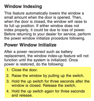

Also be sure your primary auto battery is in great shape. Do you know how old it is? Most have a functional life expectancy of 4-5 years and the C6 needs a healthy battery otherwise you could expect to have electrical problems as it fails. A quick disconnect/reconnect of the battery will reset the modules and sometimes cure some problems with the car. Be sure to re-index the windows are reconnecting the main battery.
