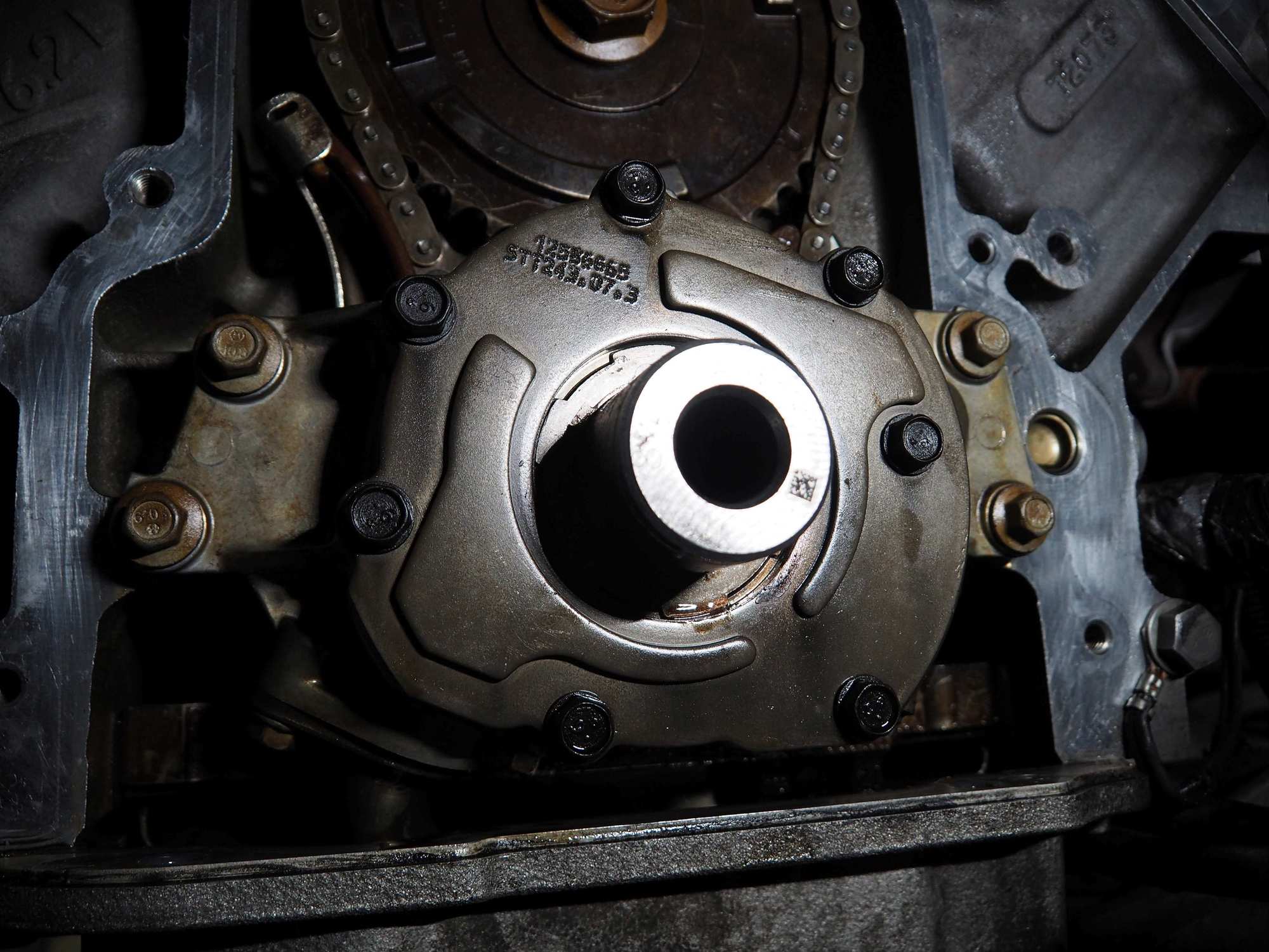

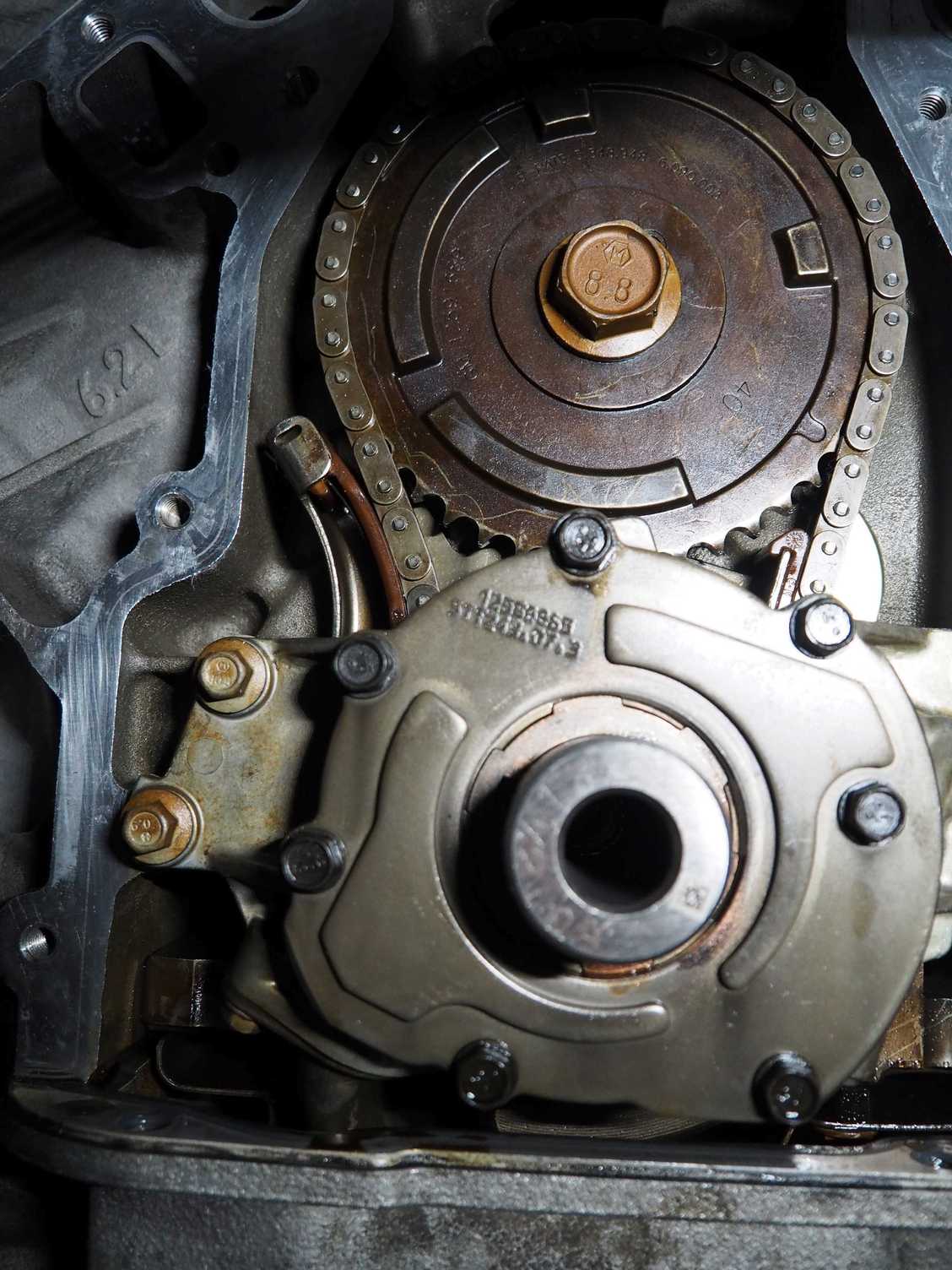

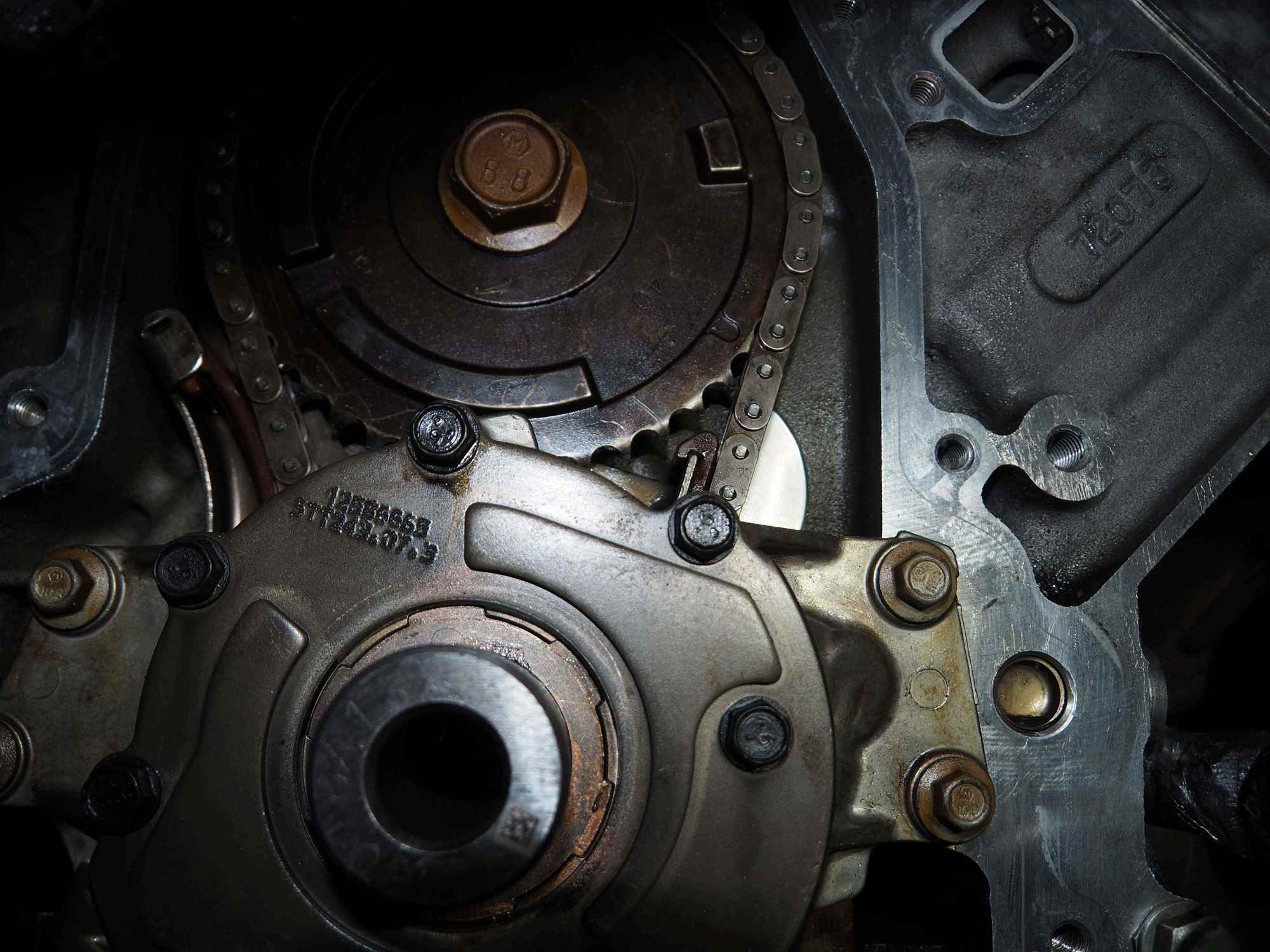

I finally adopted an intermediate method: I opened the timing cover to inspect the condition of the tensioner.
As it appears to be in good condition, I decided to not change my tensioner in order not to risk anything with the oil pump.
I now have a question for the lid assembly:
I bought the tool to center the lid.
I also understood that it is necessary to put RTV at each corner where the cover meets the oil pan.
What I’m wondering is:
-Should something be put on the rubber part of the cover gasket ? I was thinking of putting oil on it, but I think it might disrupt the RTV in the corners...
RTV does not seem to me too adapted either with the rubber.
- How to tighten the cover screws on the block and on the oil pan. I read that you must first tighten the block, but then you are not sure that the cover presses on the seal of the oil pan...

DONT tighten the oil pan bolts first! I made that mistake and had to do it again. If you tighten the oil pan bolts first, it will pull the cover "off center" of the crankshaft and cause the crank seal to leak.
Old Mar 10, 2024 | 11:27 AM
chris383's Avatar
chris383
Joined: Mar 2010
Posts: 238
Likes: 10
ok, but is the sealing done correctly in this case?
It is necessary to add a little RTV under the cover, in my opinion (also marked on the instructions of the centring tool).
About this, I took the tool that is used with the crank seal. In the same manual, they say that it is better to use the type or the centering is done without the seal and add it after, which seems to me actually better.

I had everything up again, but I got a code P0016 when I tarted the engine.
Reading the posts here, one of the causes could be the cam sensor.
So I bought a new one and tried to get out the old one. But it really did not want to go out and of course, the plastic broke without being able to extract it...
I had to dance to disassemble it again to get it out: it was really hard to hold in the lid.
I now have questions :
- does the cover seal (with a "U" shape) have a mounting direction? I read this, but I have serious doubts because the rubber seal looks very symmetric on the metal plate.
- Should this cover seal be lubricated? With what: engine oil? Other?
- Can the chain guide be changed without removing the oil pump? I don't think that...
