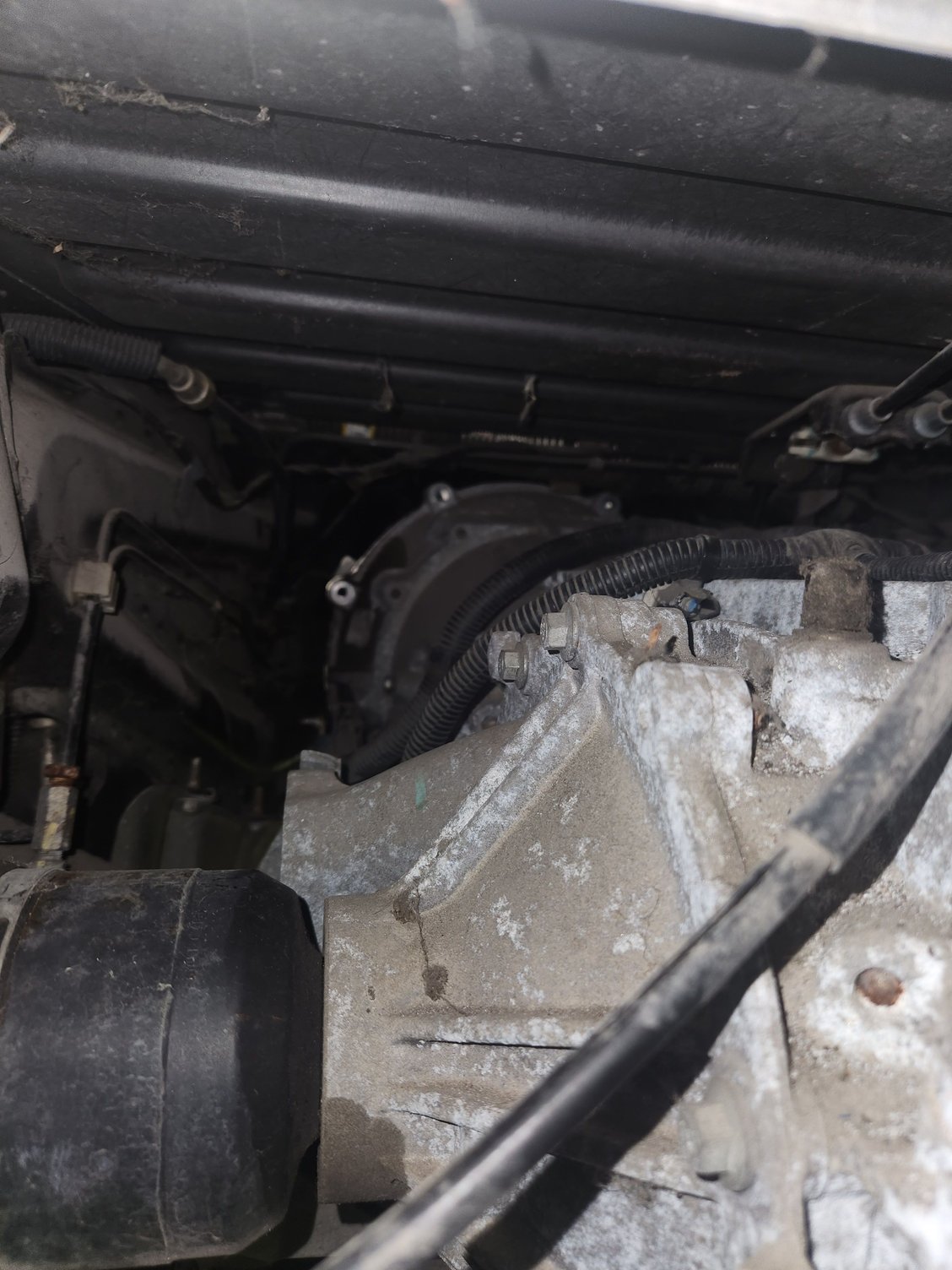

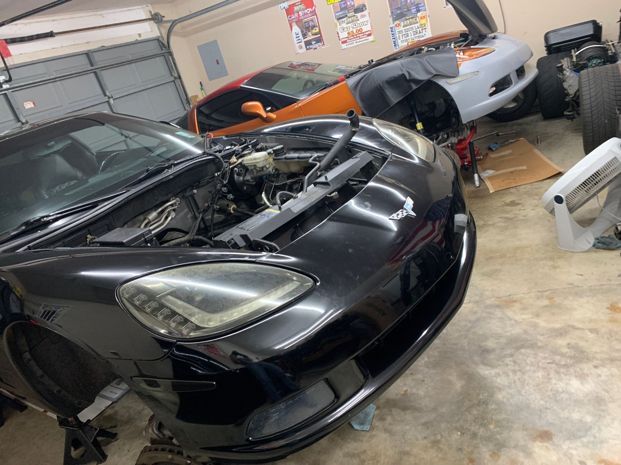

Hi guys, new to C6s. I have a 2005 base coupe, auto transmission. I have the engine out and front clip off for repair. I want to drop the torque tube to inspect and replace couplers and bearings. I have all bolts off at the trans(one bolt on the bottom is a couple threads in just in case) and torque converter and it acts like its still bolted together. What's the trick? How do I get it to separate from the trans?

Go up through the access port to remove Bolts 11, then you can unbolt the TT from the Trans to remove it from there.

All torque converter bolts are removed, all Bell housing bolts also removed. Assuming it must be stuck on the dowel pin? It doesn't act like it will separate. Car has only 39,000 miles...

Motor has to come out , or diff and trans with TT has to come out,so you have the room to pull is away from the pins front and back that its sister-ed between.
With motor still in, diff and trans still in, it will not come out.

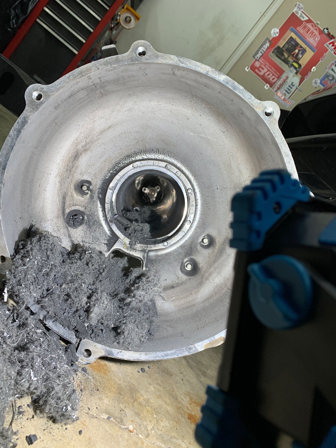

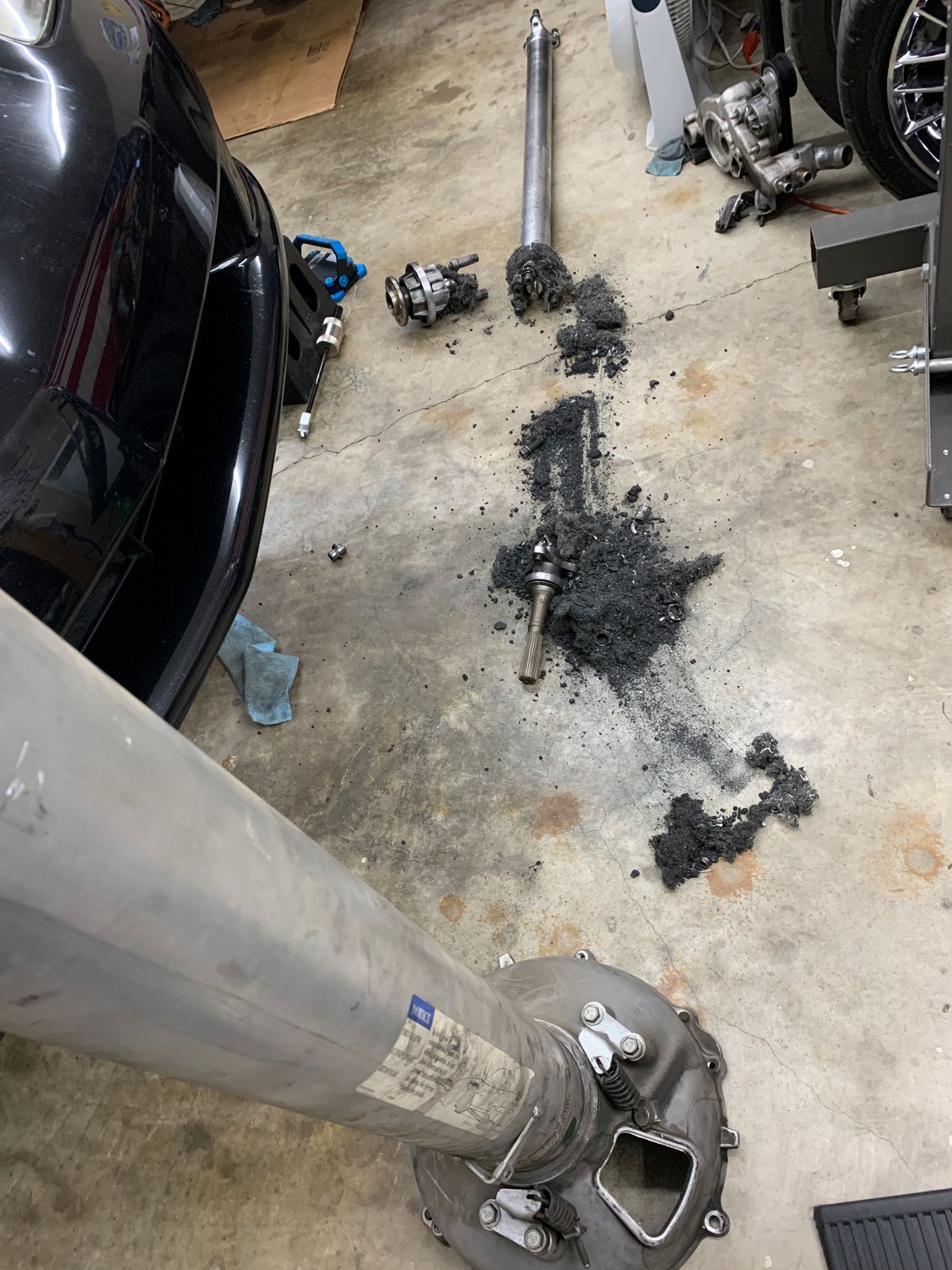

Just incase any others were looking for the answer to my question regarding to how far the rear cradle/transmission has to be dropped for the torque tube to clear the torque converter and TT tunnel;
I had to drop the rear cradle about 4-6" and pivot the transmission down a bit to pull the torque tube forward and out.
This 2007 C6 has 167000 miles on what looks to be the original torque tube bearings. I believe the rear bearings locked up causing the engine to destroy the drive shaft couplers/torque tube assembly.
