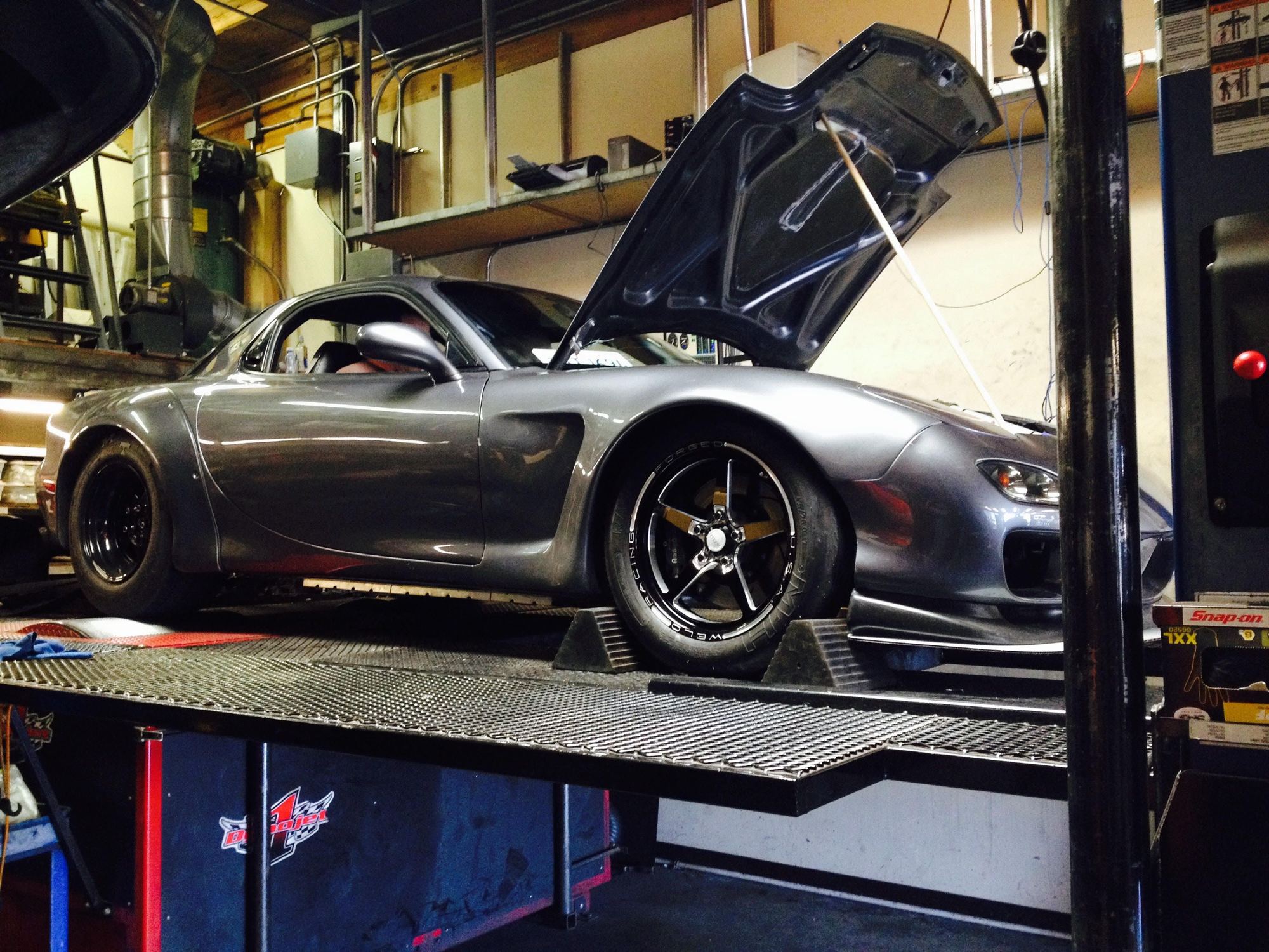

I had a QM600 cam in an LS7 many years ago
with basically stock intake manifold, and mildly cleaned up exhaust ports on the heads with long tubes.... it was a fun setup with 11.25:1 compression (91 octane) and went 111mph 1/8 and 138.3mph 1/4 best in my little 2900 (with driver) RX-7 and T56. It only dyno'd at 522rwhp/472rwtq but as you can see it probably made a little more power than that.
Cam technology has come a long way even in the past 3-4 years. BTR V1 or V2 would be a good pick. You should run 12:1 compression as 93 octane supports that (Pretty sure you have it in your area)... An MSD Atomic intake is worth from what I've read/heard/seen about 25rwhp+ over the LS7 intake. Every point increase in compression is 3% more "free" power (11:1 to 12:1 etc).
