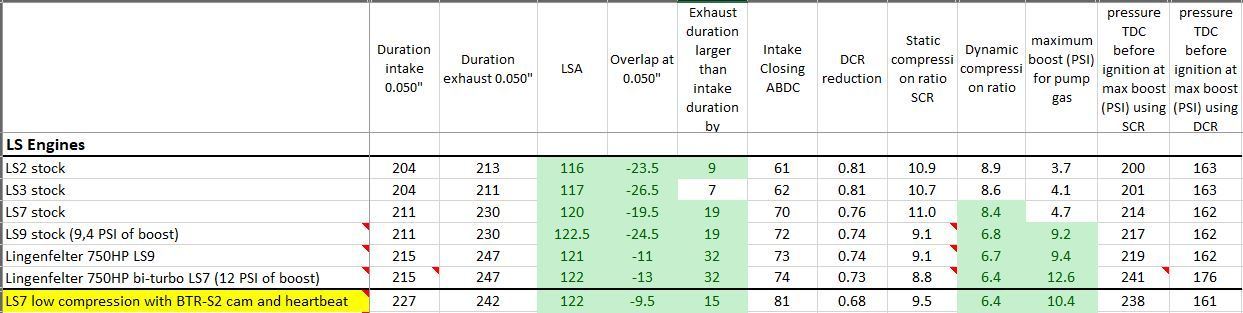

Thank you for the feedback. I do not want to overcomplicate things, but I calculated these "in cylinder pressures" as you suggest here in this sheet using the static compression ratios. There are differences between the static and the dynamic compression ratios, and of course the amount of air volume you put through the engine. Lowering the compression ratio and adding boost is essentially "keeping the peak cylinder pressure before ignition the same but pumping more air and fuel through the engine, hence, making more power".

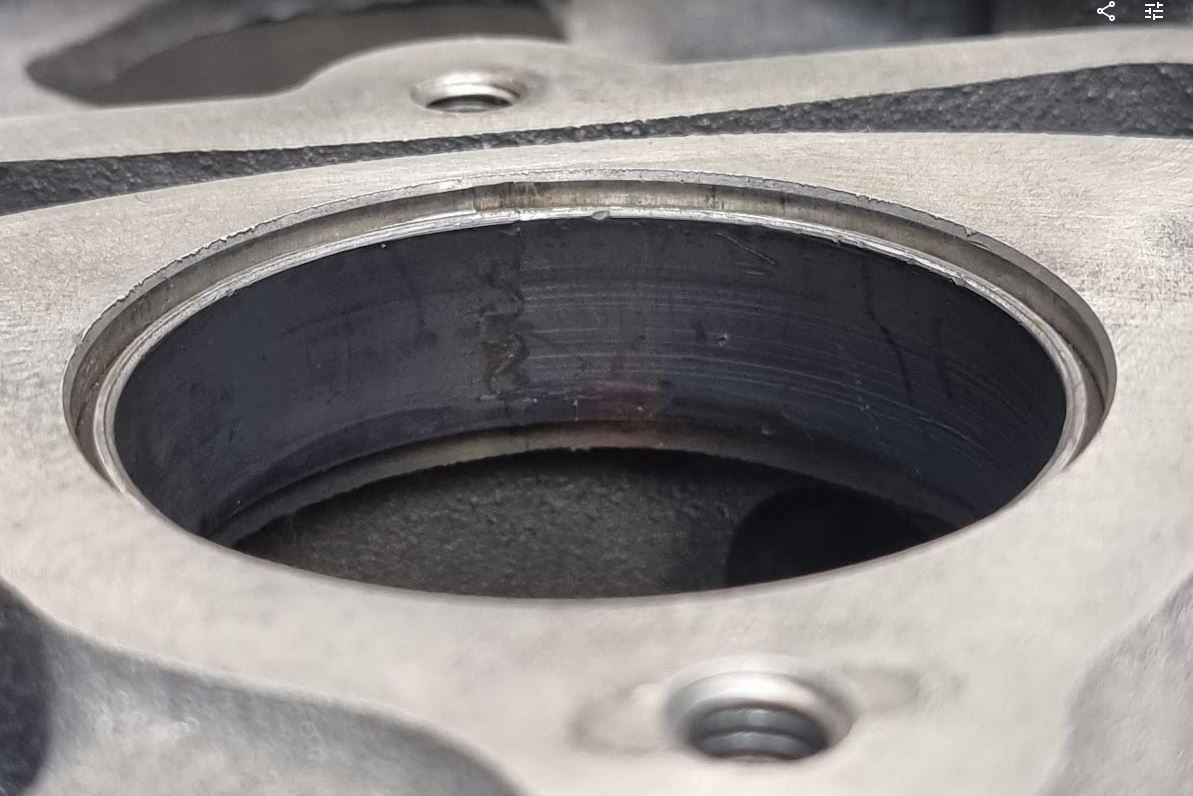

Hence meat between the LS7 cylinder is not great, and why you can not throw a lot of pressure at the motor, before you pressure crack the cylinder liners between each cylinder.

Hence block is 11-1, so at 14.7lbs of N/A at sea level, compression on cylinders is 161.7psi. With 7lb of boost, 14.7 goes to 21.7lbs times the 11 compression, and your at 238.7psi in the cylinders. Yes, you can drop the compression, add in more boost, but that 238.7 cylinder compression in the end, is going to be your limiting factor, due to the thin cylinder liners.
Thanks for posting this. Well, what do you think about the Lingenfelter twin turbo C5 Corvettes back in the day? They were 427CUI, basically the same thin walls compared to the LS7. These engines had over 15PSI of boost. They did that with much lower compression ratios. So if we replace pistons in that LS7, we can go down in compression. So if you drop compression to 9:1, we have 239PSI / 9 = 26,5 PSI. That is then 26,5-14,7=12PSI of boost and more power since you have more air and fuel to burn. You have the same peak cylinder pressure (roughly a factor of 10x after ignition, so 240PSI goes to 2400 PSI or 165atmospheres), but the pressure decay as the piston moves down is much slower, hence more overall pressure. Efficiency goes down a bit, but you have more power with the same peak pressures. On that note, compression ratio is one of the least reliable ways to make power. Best example: LS9 in stock has very low compression. The lower the compression ratio, the more robust the engine. Tuners often increase compression ratio, but that is not as reliable then making the power by other means (more air and more fuel with a lower compression ratio).
So overall, I totally agree with everything you write, and I hate high compression ratios, and the consequences, which is why I am going another way. I want margins as much as possible, so I am not looking at more than 6-7 PSI. In the world of reliability, you cannot add any boost to an 11:1 compression ratio. You can only add 6-7PSI of boost in case you turn down the compression ratio to 9:1. On the Lingenfelter C5, I turned the boost down to 6 PSI also.

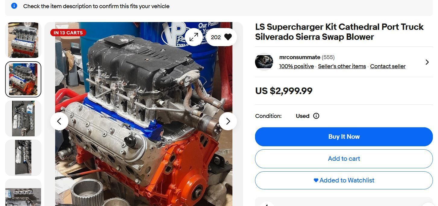

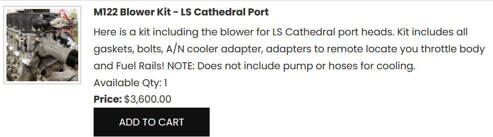

Out of pure interest, where can you buy these M122 kits for LS engines? Found this for roughly 3k.

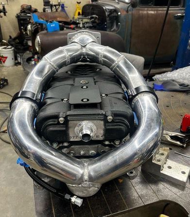

Unfortunately, these units take in the air from the back. So they would not work on a Corvette. This is the intake tubing that would sit between the firewall and the engine:
