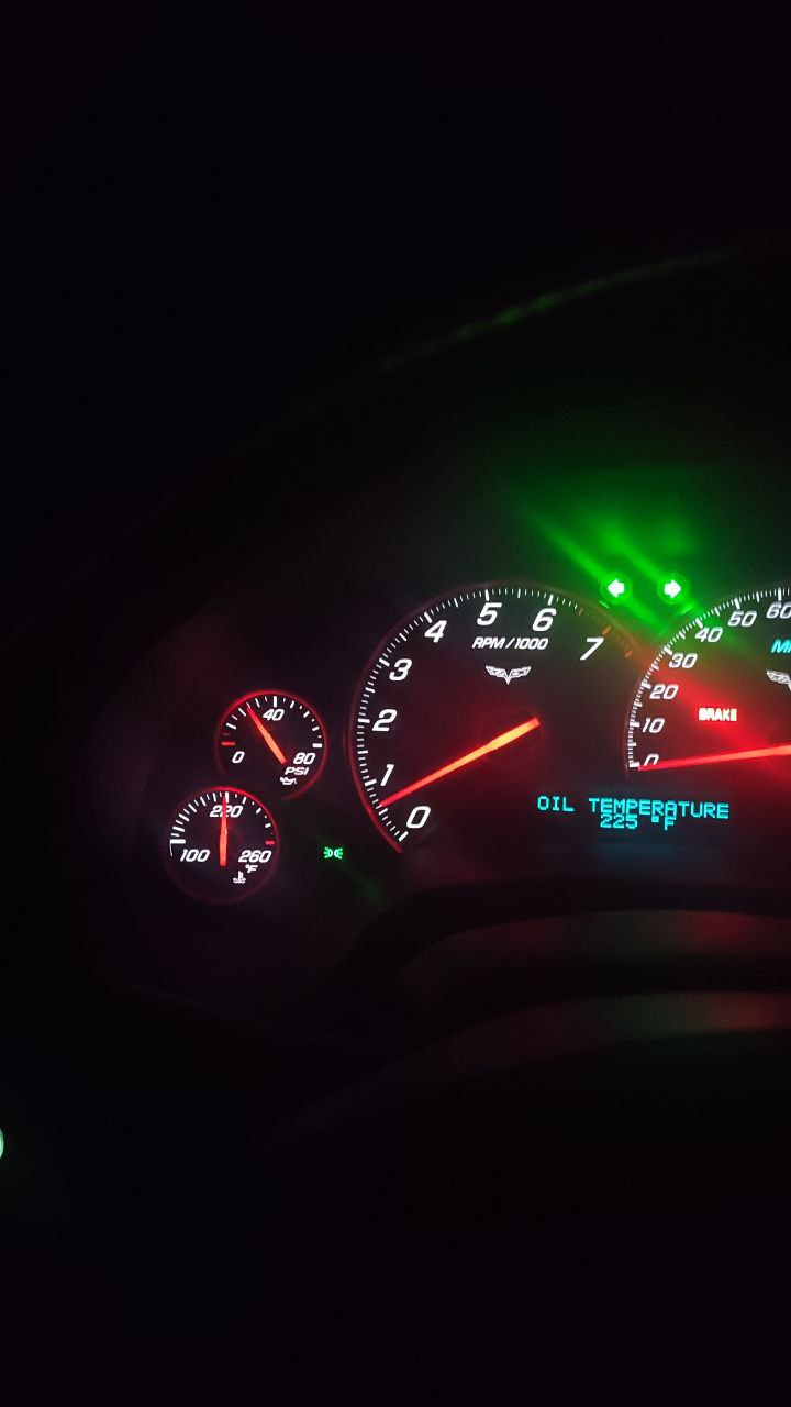

@StayinStock can I ask you once more? Are My ls3 have low oil pressure? 22psi oil pressure on idle with 225F oil temperature, mobil 5-30

that seems pretty normal... i wouldnt sweat it
