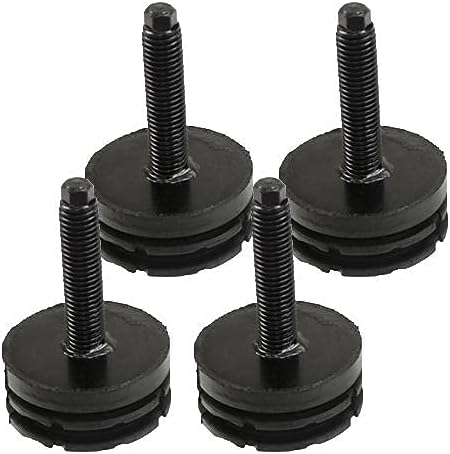

So far all has been good, although I have noticed that it is rubbing quite a bit in the rear. It is sitting on z06 stocks with brand new nittos on them. It also has lowering bolts all around. I figure it is simply rubbing due to the fact that it is lowered + bigger tire, but where I need help on is how to fix it. Not sure if I should upgrade the shocks or springs, or If it might require more than that. Just looking to stiffen it up a bit. To put into reference, It has a 2 1/2 gap between the tire and fender so there is a good amount of distance but still rubs.

As for tire inside the fender lip and just rubbing on the inside of the wheel well liner, dump the aftermarket ride height bolts, reinstall the oem type ride height bolts and although you can lower the car down, make sure to corner balance it correctly. Front and back just slammed down on the ride height bolts all the way up, will not have the car correctly corner balanced.

to stiffen the ride without breaking the bank, a take-off Z06 rear spring would help. to raise the ride height, you can do that for free buy adjusting the bolt/pads between the spring and the control arm. commonly referred to as "lowering bolts"

If you are significantly raising a lowered car on the lowering bolts keep in mind you may need a tire alignment as well. Don't want you to wreck your brand new tires!
