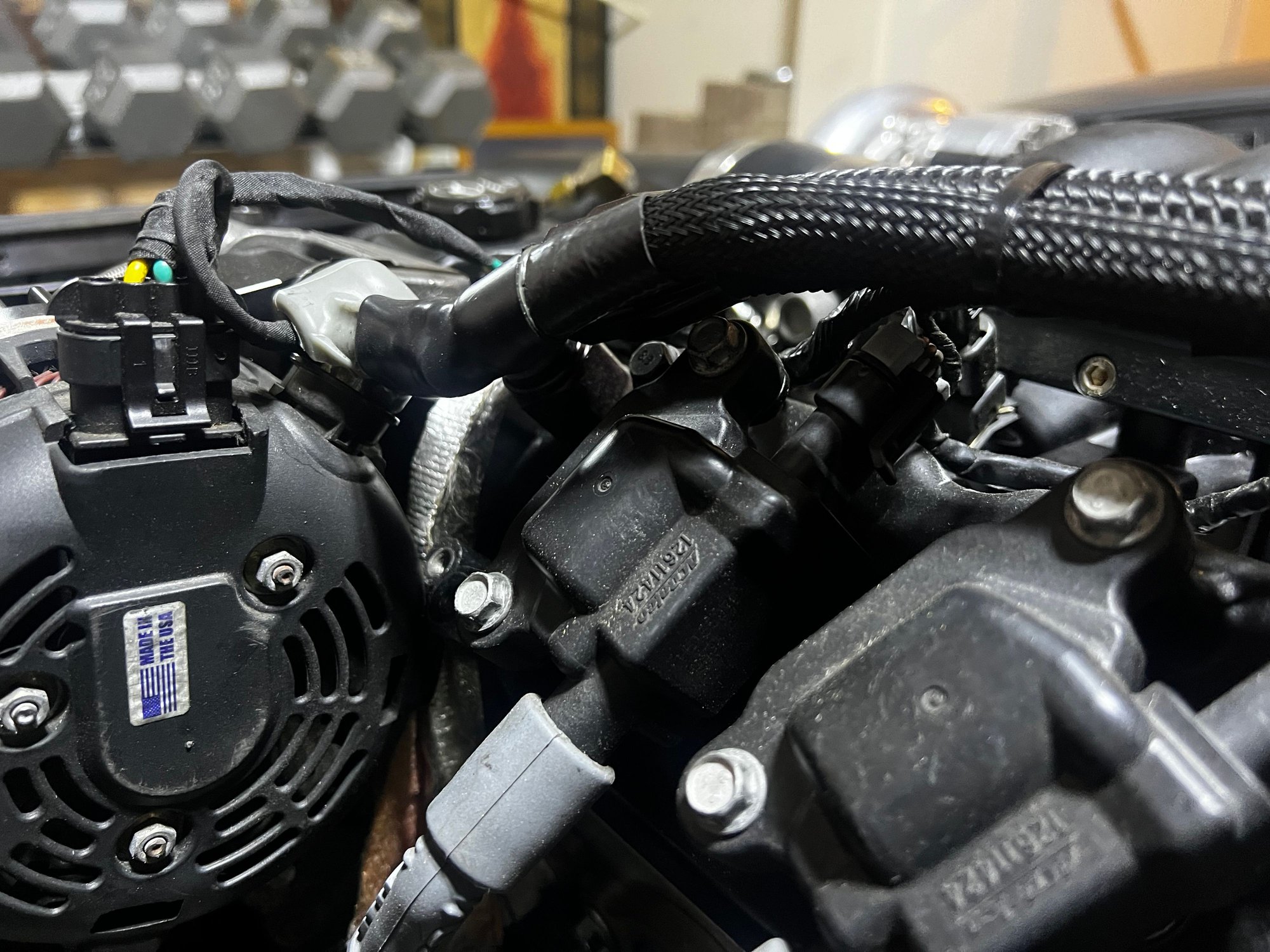

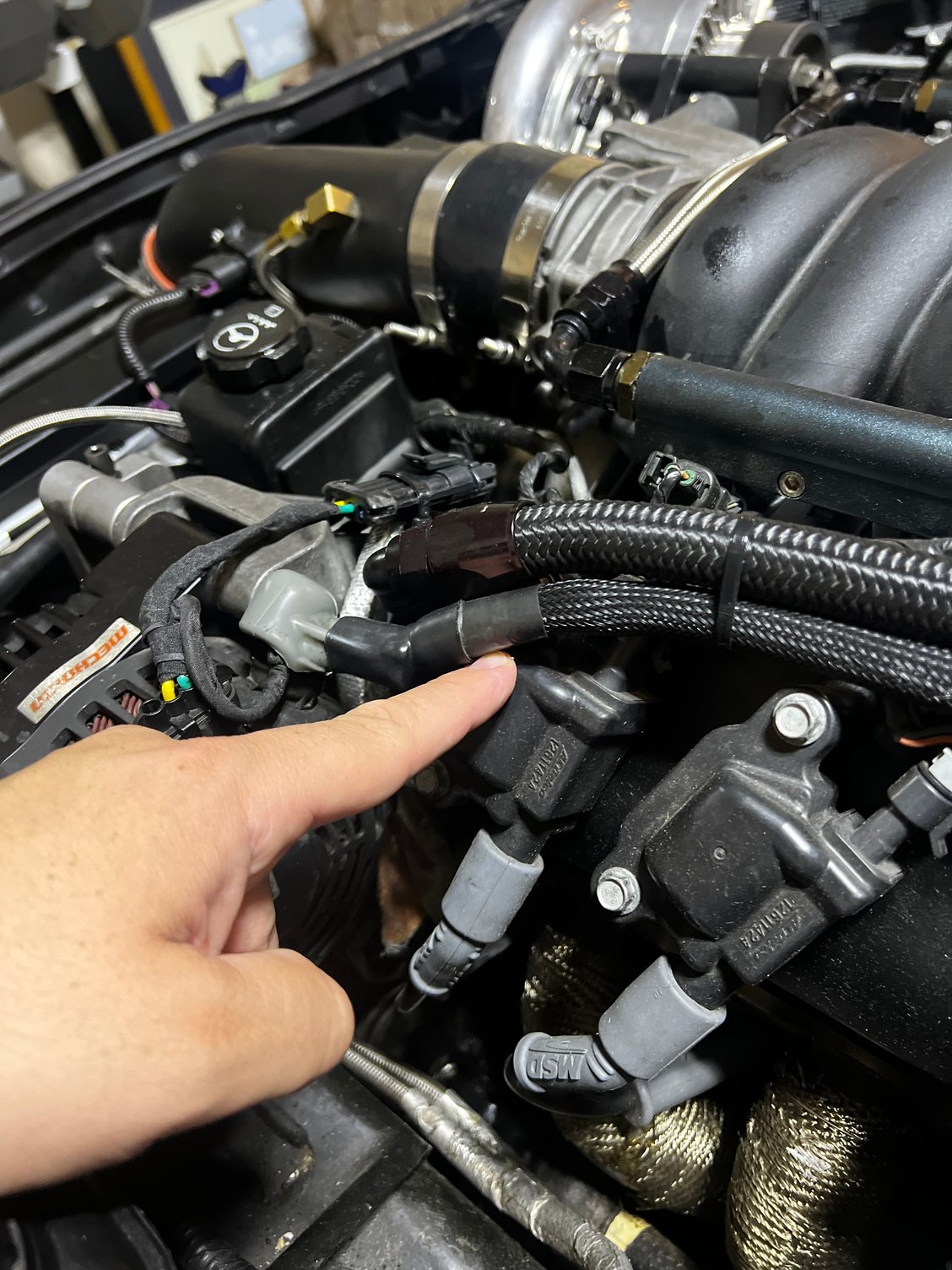

Alternator wire in contact with coil. Erratic voltage from 13-16+ with random codes. This is mostly while cruising.
Mechman alternator
The wire in question is in direct contact so I’m assuming it needs to be rotated off of it?

I would move it off anyway.

ECM controls alternator voltage output, so my guess would be the after market low resitance spark plug wires, and even non OEM plugs that do not have the needed RF suppression resistance, that is allowing RF noise from the coils back to the ECM, and what is causing the strange alternator output voltage fluctuation.
But re-route the alternator cable away from the coil, to see if that solves the problem.

Moved it off hopefully this helps

Update: SOLVED!
Took the car out on 3 seperate occasions and zero codes thrown. Voltage holds steady and no longer spikes 16.
Thanks to my brown friend @onivette for the advice

That's great! Did just moving the wire off fix it?

yes, all I did was loosen the nut rotated off of the coil and tighten it good
