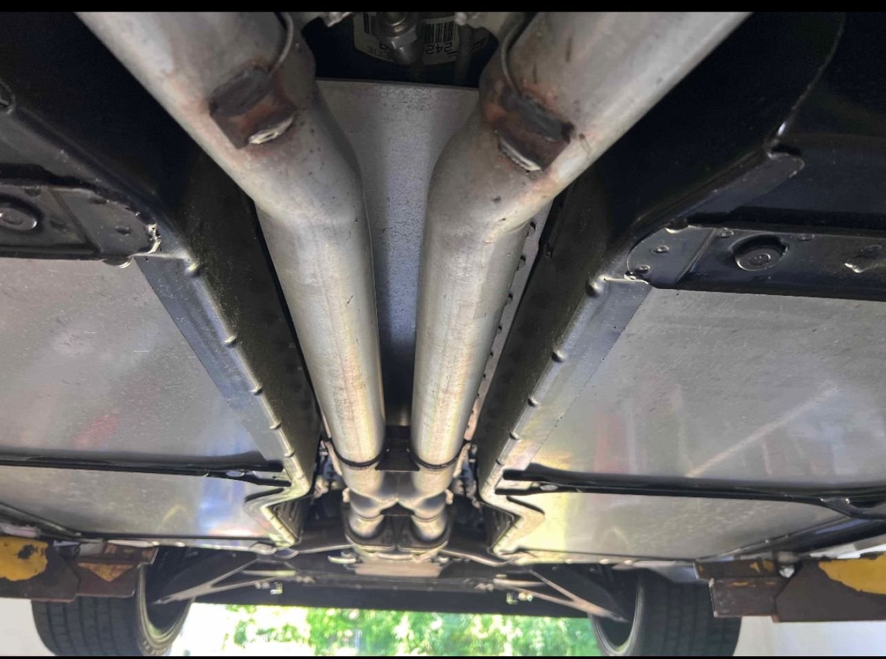

Plz post photos of your mufflers so I can help you identify what model of Borla exhaust you have. Most modern exhaust systems are designed for more snap crackle pop on deceleration.
How the engine is tuned can also influence this.
Thanks! I’ll get pix to you tomorrow. I’ll I’m reading is now bad Burbles are for the engine. Also, how do I find out if this car has a performance chip in it or not?
Bought her from a foreign car dealer. 2010 1 owner drop top with 6K on the clock. (Carfax checks out) The dealership was unaware of the K&N Induction and Borlas. Great for me…It’s been like a scavenger hunt and I’m quite happy with what I’m finding

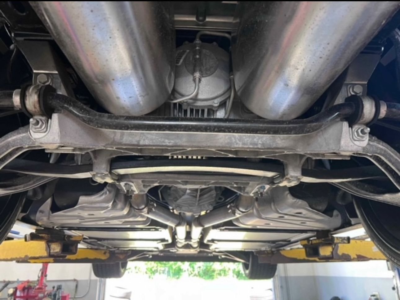

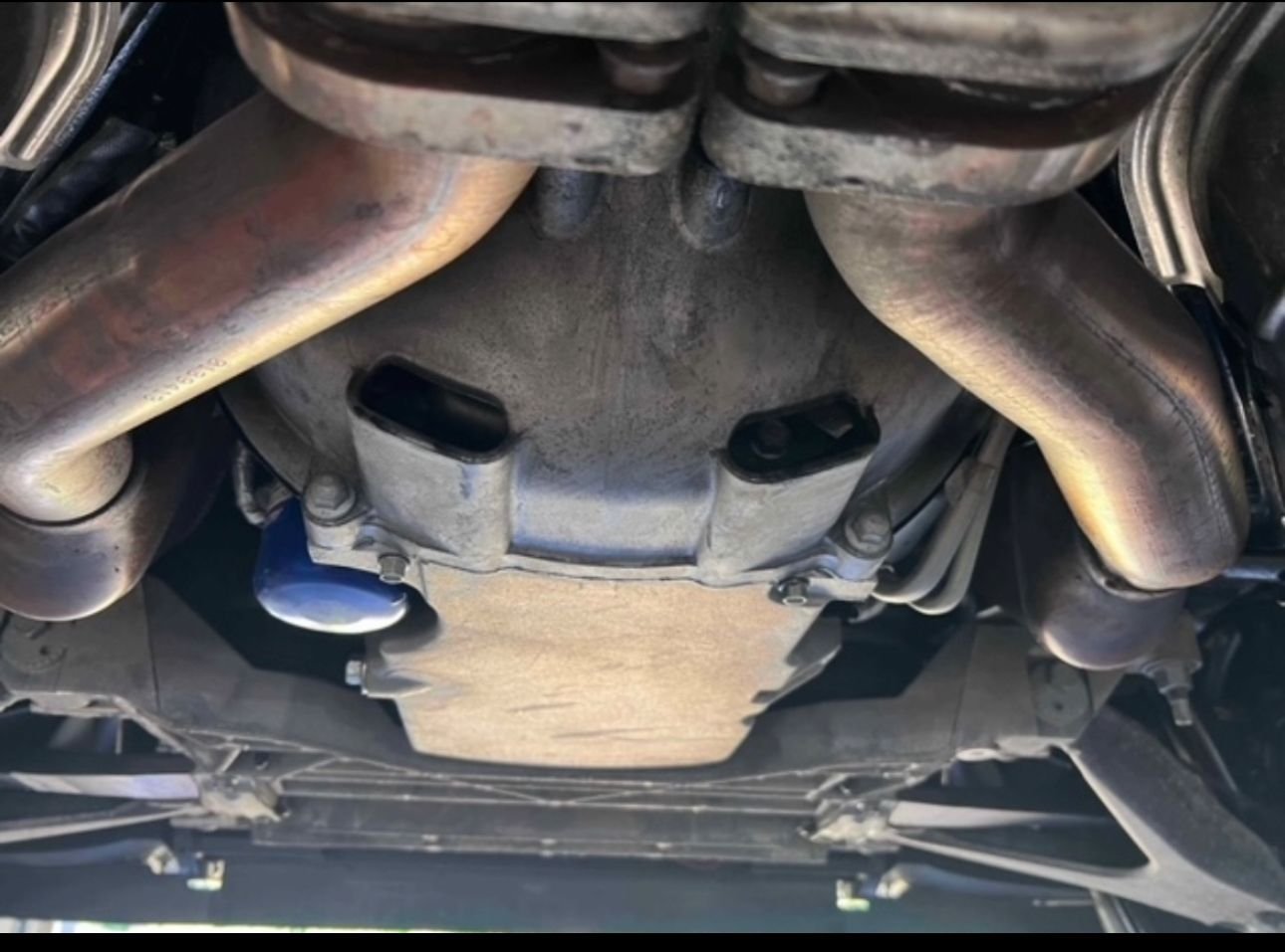

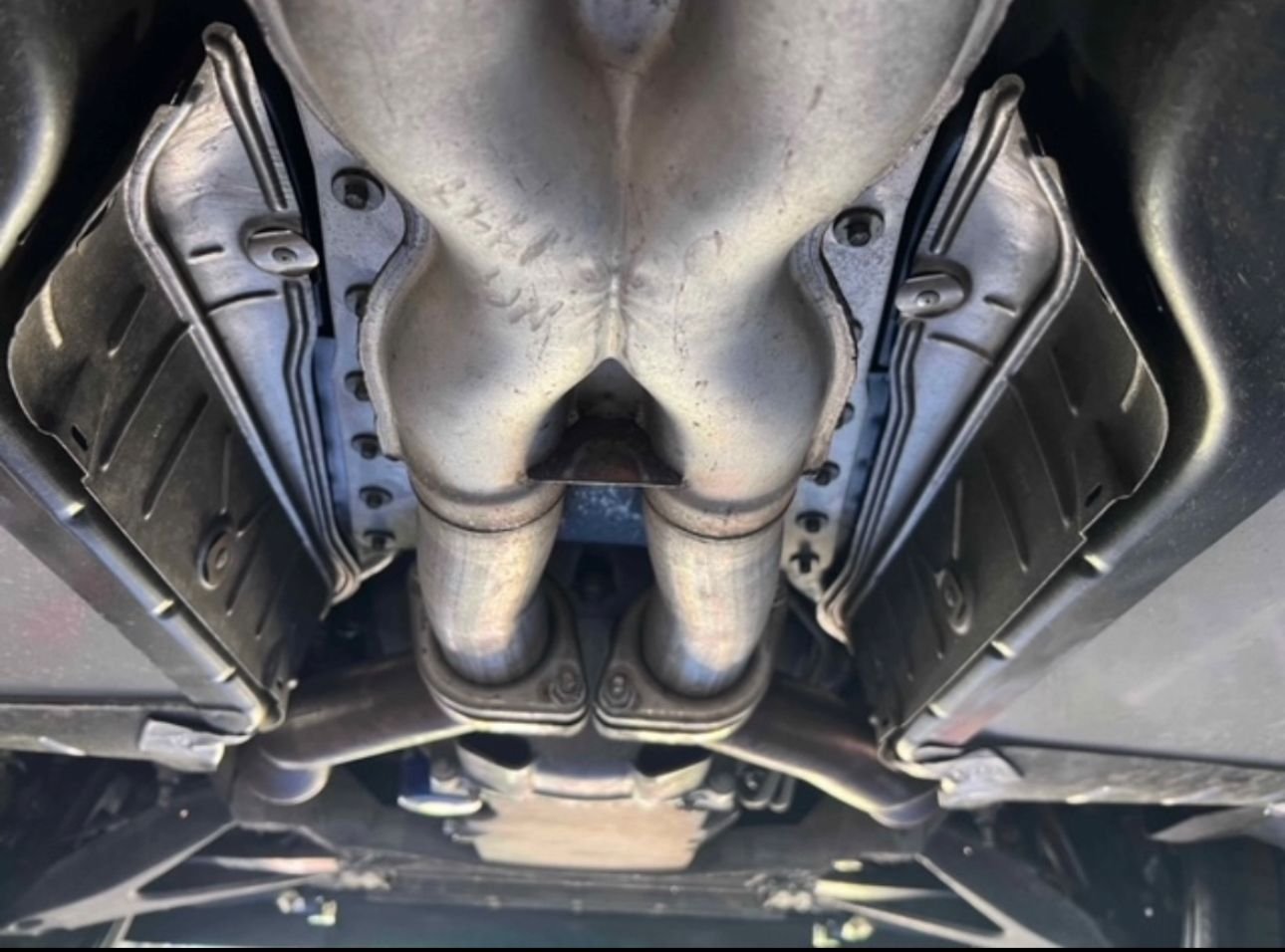

[QUOTE=Corvetteexhaustsystems;1607813867]Plz post photos of your mufflers so I can help you identify what model of Borla exhaust you have. Most modern exhaust systems are designed for more snap crackle pop on deceleration.
here ya go…. Appreciate your help!!

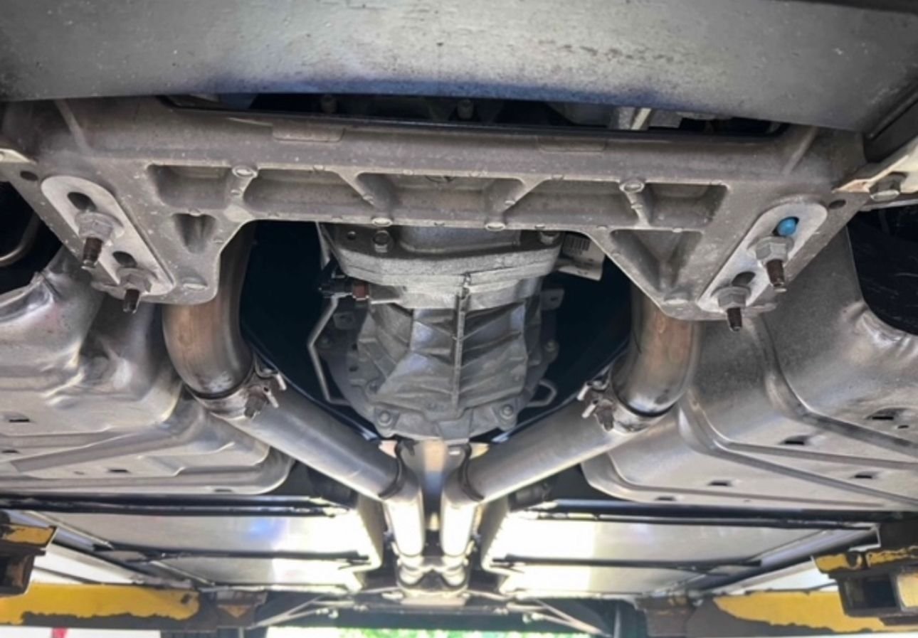

[QUOTE=DESI6327;1607816592]
You asked? You got! Appreciate your help!
