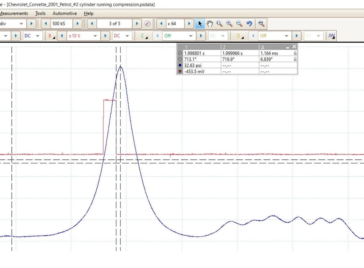

I’d look at the fuel pressure first…let us know what you find !!…with your scan tool if you can go WOT see if your front O2 sensors go full rich !!…if you need to know if it’s a timing issue find a shop that uses a pressure transducer…in 5 minutes they can tell you if the timing is off without having to pull the engine apart…below is a waveform from my old C5…ignition occurs about 6.839 degrees before TDC…if ignition occurs to the right of TDC your timing may be off.
