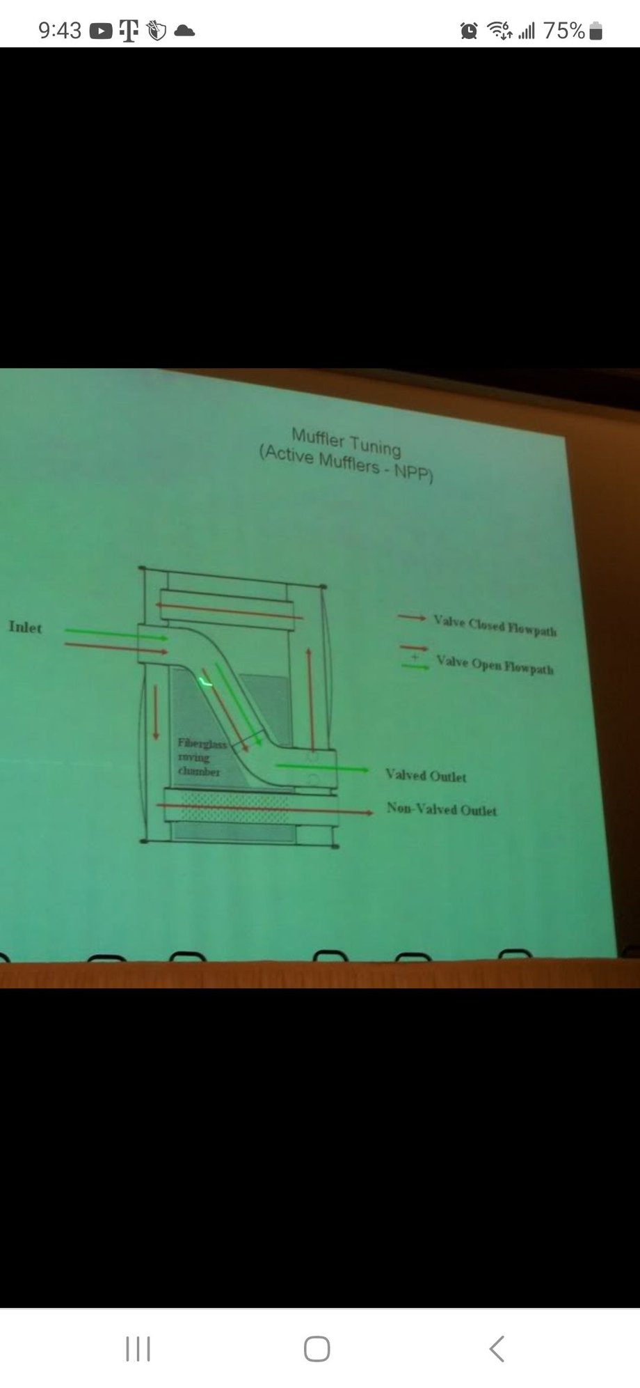

The NPP opened is 1000% not circulated though the muffler as some of you are assuming, it definitely is essentially a straight pipe. Closed is the only time it is circulated in basically a square....this is why the horsepower gain claim is there for the 6hp they rated

then what’s the point of doing the muffler mod? The “straight pipe” is perforated
The straight pipe on the later years was not perforated.
Here's a post explaining a little more along with the easy way to tell if you have the louder mufflers. Click the link to view the pics.
Link to post with pictures
Originally Posted by NemeZ
ZR1 mufflers and 2011+ Z06 mufflers have the loud section (inside the muffler) as a straight pipe. The older Z06 mufflers have a perforated pipe on the loud section. The ZR1/ 2011+ Z06 mufflers have the quiet side perforated so it’s quieter than the old muffler (in the quiet mode). You can easily identify the ZR1 muffler by the perforated tips.ZR1/2011+ Older Z06
