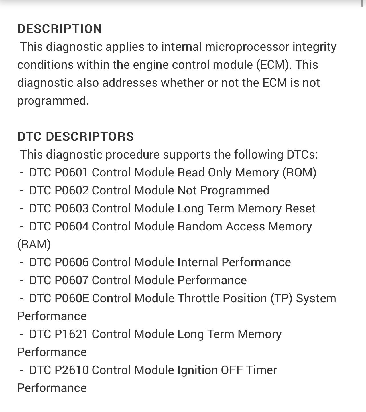

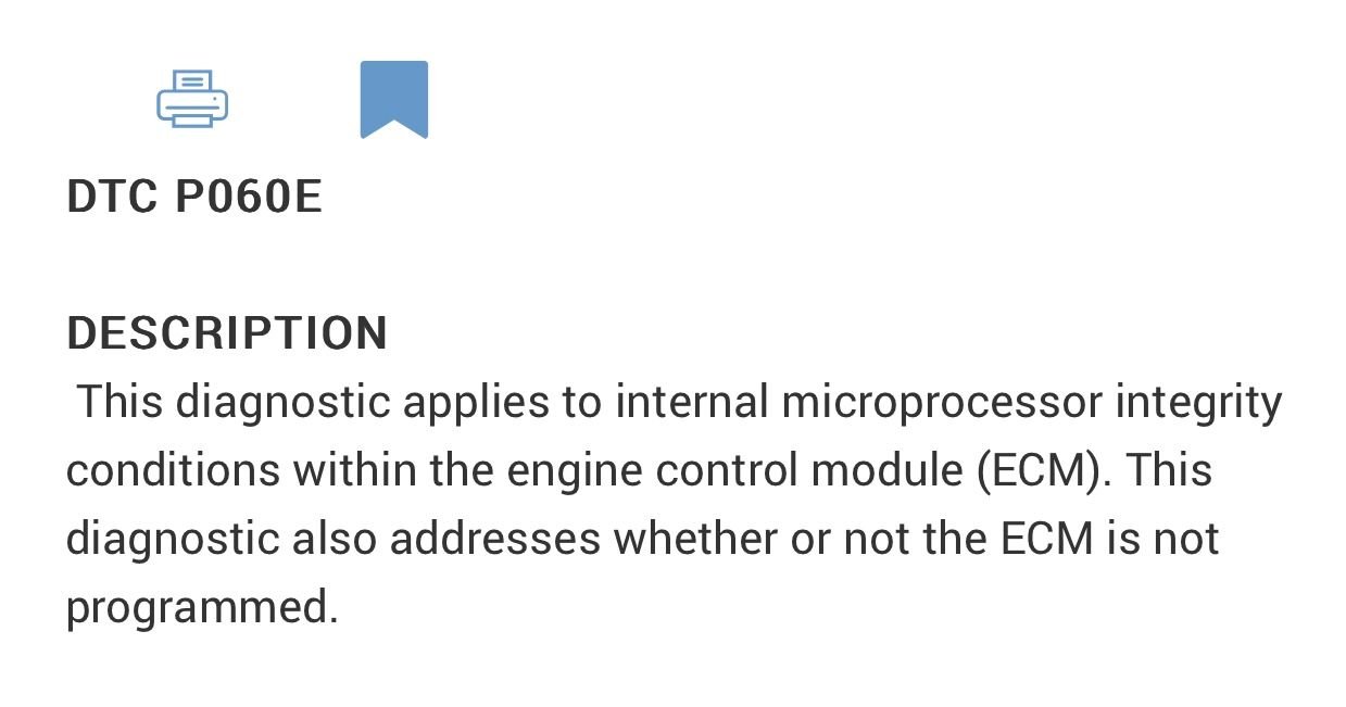

If you read the code setting criteria this may be an ECM issue and not the throttle body.
Changed it with a new ecm still same code and still same problem

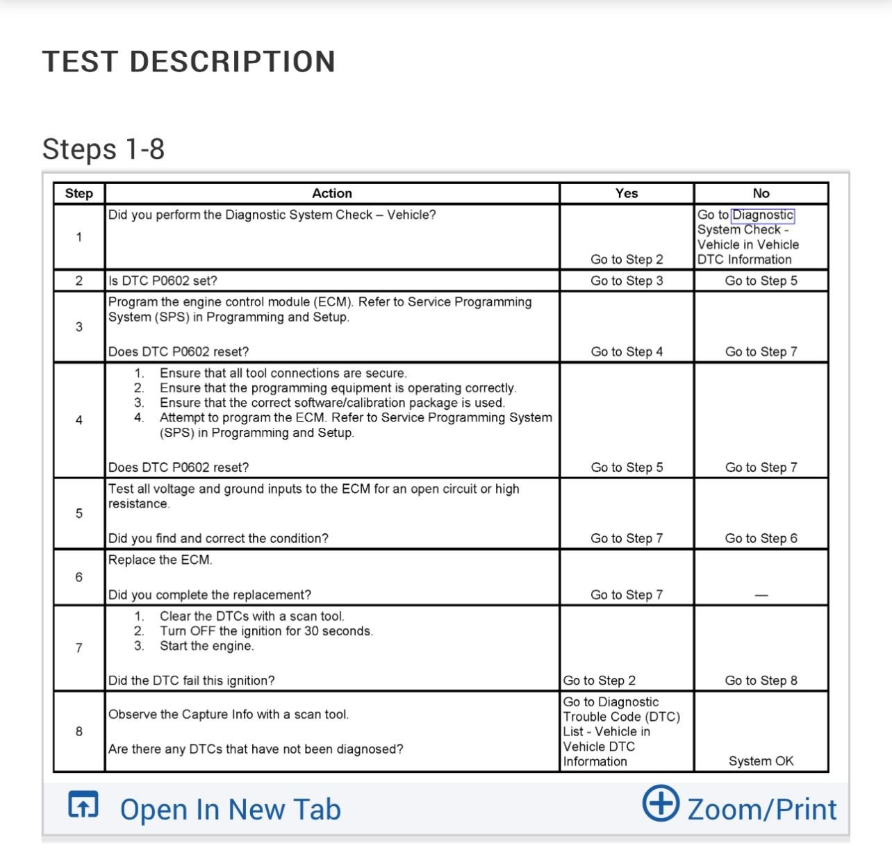

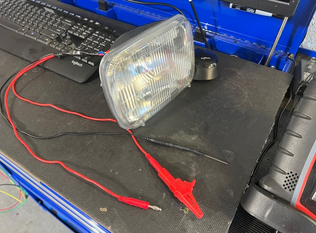

As in step 5 below if a P0602 is not set check ECM powers and grounds…and FYI you don’t check ECM grounds with an ohm meter…I would recommend using an old headlight bulb that draws a few amps…I use an 5 amp high beam bulb.
