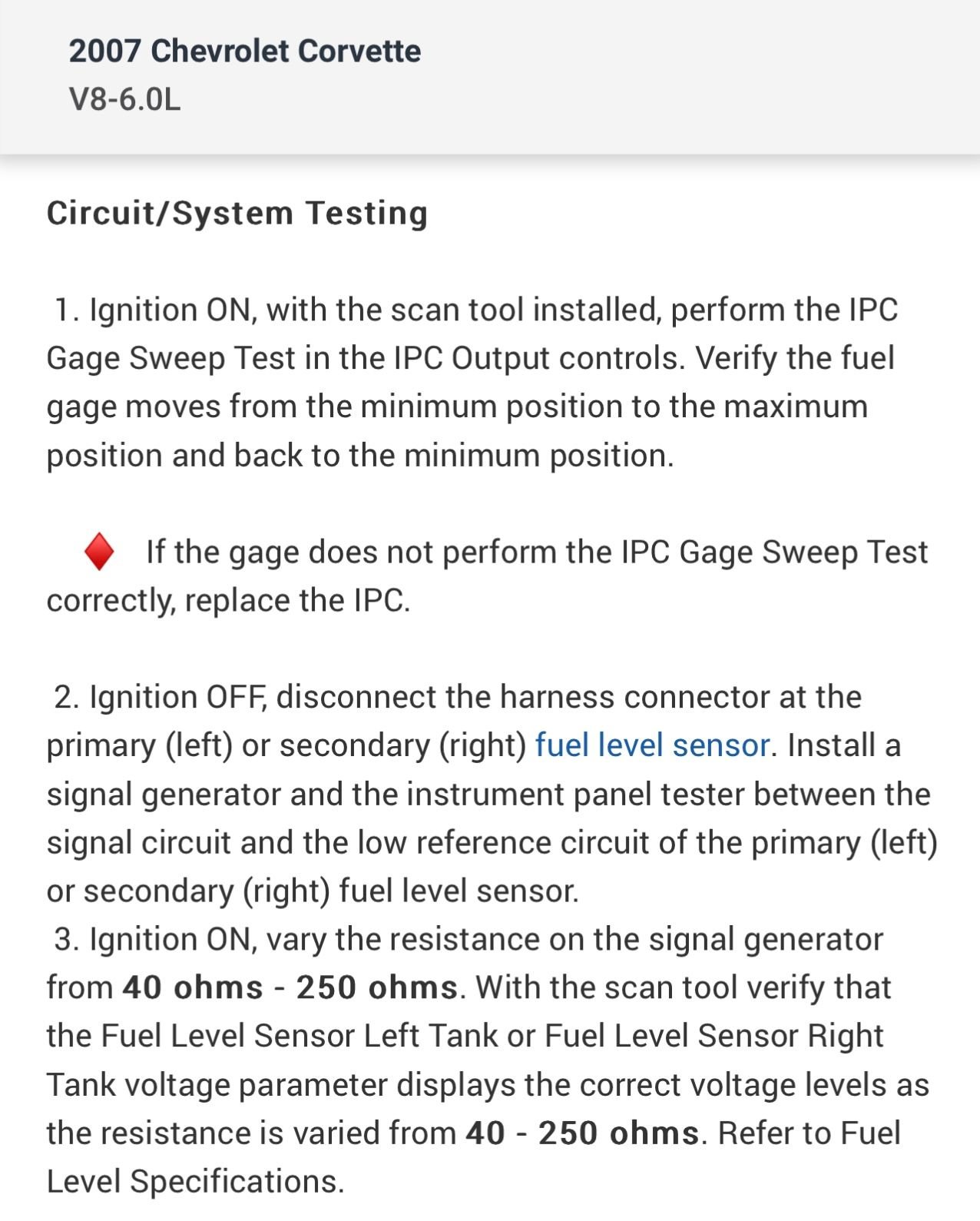

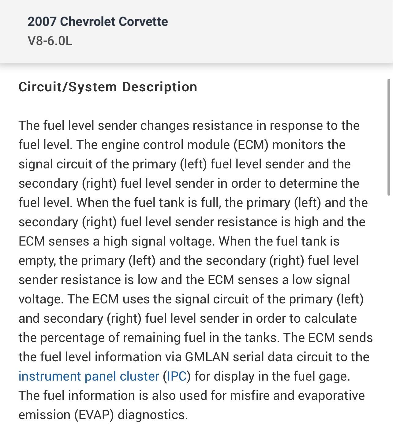

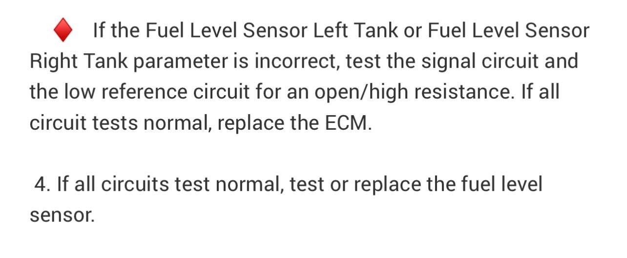

The only DTC for the fuel pump that I know of is a P0230 which is the fuel pump relay and not the pump itself…if you don’t have a scan tool take your car to an auto parts store and they will tell you…there are 2 fuel senders with one in each tank…service information below.

Old Jun 4, 2024 | 11:26 AM
C5 Diag's Avatar
C5 Diag
Moderator, Tech Contributor
Posts: 15,627
Likes: 4,071
From: Cape Coral, Florida
