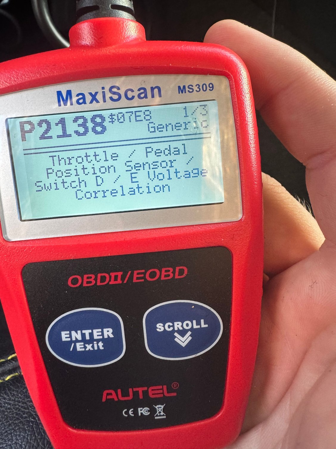

Was wondering if someone could potentially interpret this for me. Was in traffic and my cel came on randomly and service traction system, and service active handling came on.

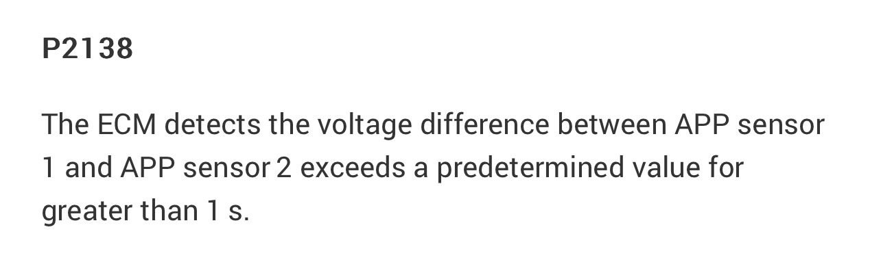

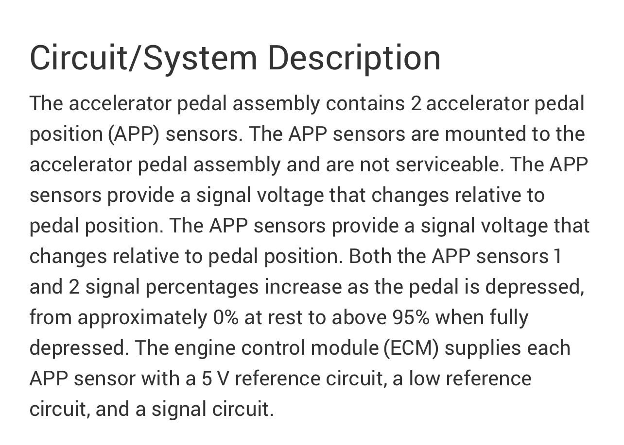

You have an issue with your APP sensor…there are 2 potentiometers and the voltage reading from each of these 2 potentiometer voltages do not agree with each other…it helps if we know what year your car is.

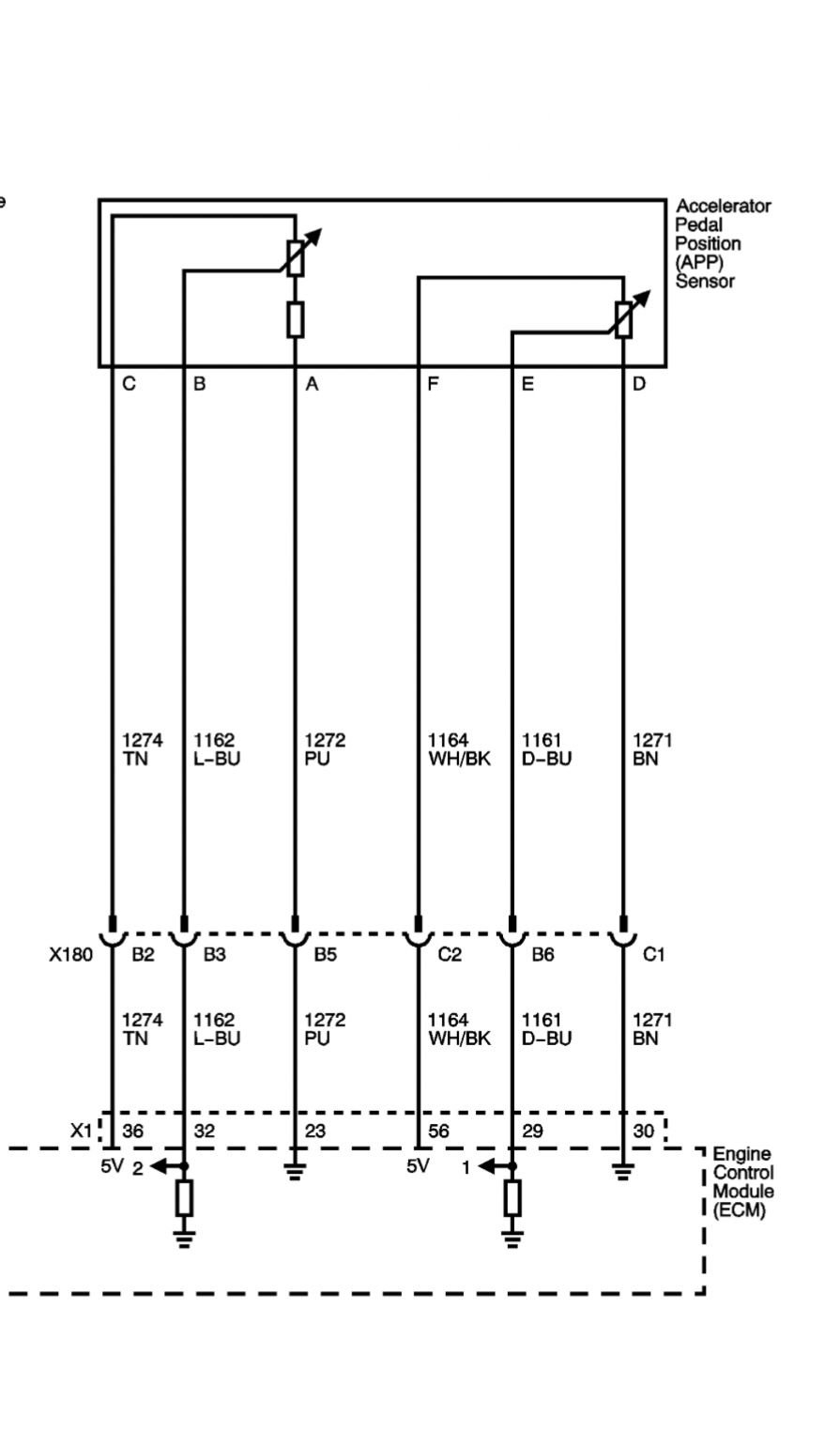

If you know how to use a DVOM you will need it to diagnose this DTC…if you have no electrical experience take the car to an auto electric shop.

I’ve saved the diagram, but currently I don’t have experience with stuff like this. I’m wanting to learn which is part of why I bought the obd reader. I’d love to get better at doing stuff myself
