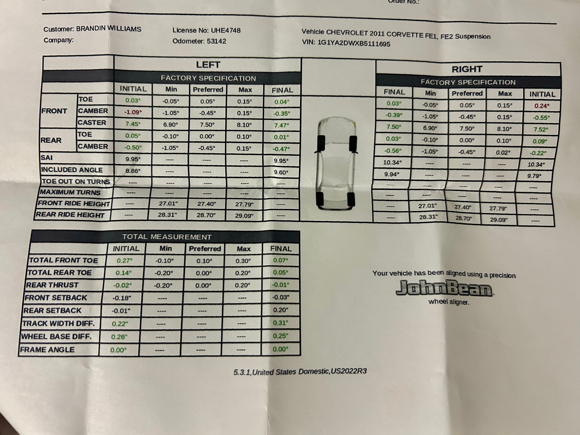

Post the image of your last alignment.

This was last week

Camber isn't very aggressive front or rear, so that's not a problem. Caster is good. What I don't care for (personal preference maybe?) is toe-OUT. I would aim for 0° or toe-IN, esp. in the rear. Maybe I'm wrong, but for high-speed stability, you don't want toe-out. Toe-in would be better. That may not cure your pull, but IMO, it's not helping.
My car setup isn't super aggressive, although I'm running quite a bit more camber (around -2.4°F, -1.2°R), and close to ~0° or slight toe-in F/R. On the highway (multi-lane), the car is dead-nuts straight if I'm in the middle lane, whereas the steering will noticeably have to compensate depending if I'm in the left or right lane, based on the crown in the road. So that's the only thing ........ you need to know whether the pull you're feeling is on flat, neutral ground, or is it based on the crown.
It’s very difficult to explain but the pull I feel is basically all the time and it comes from the steering wheel wanting to slightly turn to the right when releasing the wheel. Even on a multi lane highway being in the middle lane if you are holding the wheel and driving straight and release the wheel it will slightly **** to the right and the car will pull right. I guess the best way to explain it is if I were driving on a flat straight road and slightly turn the wheel left it wants to quickly snap back to a neutral position instead of the car slowing drifting left , In the same scenario if I slightly turn the wheel right there is less effort and the wheel does not want to snap back to neutral and the car takes off to the right. Again, difficult to explain. I have come to the conclusion it pretty much has to be my rack. The passenger side mounting bolt was left totally out when my rack was removed to do a balancer change and I drove around like that for awhile. That had to put a ton of stress on the rack. I believe something internally had been damaged and the rack isn’t distributing fluid correctly, or something is slightly bent. I may be way wrong but that’s just what I think. Here are the alignment numbers that I tried prior to this most recent alignment, which made zero difference.

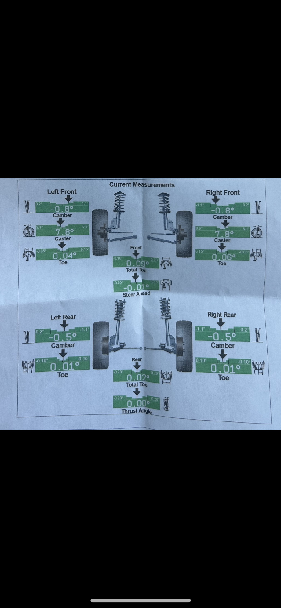

Not exactly. Back when the car started pulling right I had just installed Z51 sway bars and Moog
end links (base model). So yesterday I decided to put the stock sway bars and end links back on and now the car is driving much straighter. I also put 32psi in both passenger tires and only 30 in the driver side tires.I still feel some right side pull but not nearly as bad as with the larger sway bars. My theory is that I have an issue with my steering rack and the Z51 sway bars amplified the issue. Back when I had my balancer replaced the shop left the passenger side rack mounting bolt and bushing out and I drove the car for a good while not knowing it was missing. I think it may have messed up the valving or something. But yeah the car def drives better with the stock sway bars, just has more body roll.
This is my most recent alignment numbers.
