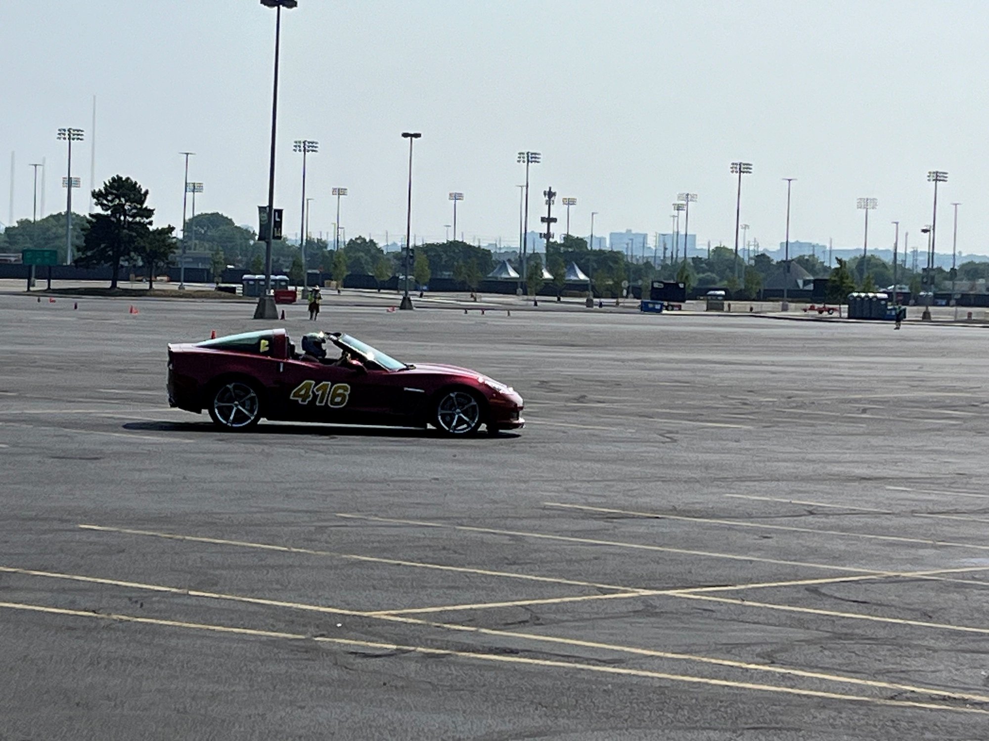

Hey all. I participated in an AutoX event on Sunday and for run 6 of the 7 runs I did, the car suddenly limited itself to 5K RPM. It would hit 5K and hold there with my foot to the ground. Not bouncing like a rev limiter but nice and smooth up to 5K then just hold there. 11GS 6mt, competitive driving mode, oil temp was 217ish with coolant temp right around the same. Plenty of oil pressure. Straight section of track, little to no steering input, 2nd gear, foot to the floor. No lights, warnings or errors. It did not feel like TCS, I've felt TCS intervention countless times, this wasn't that. Just happened on the one run and did not reappear. Anyone seen this before?
