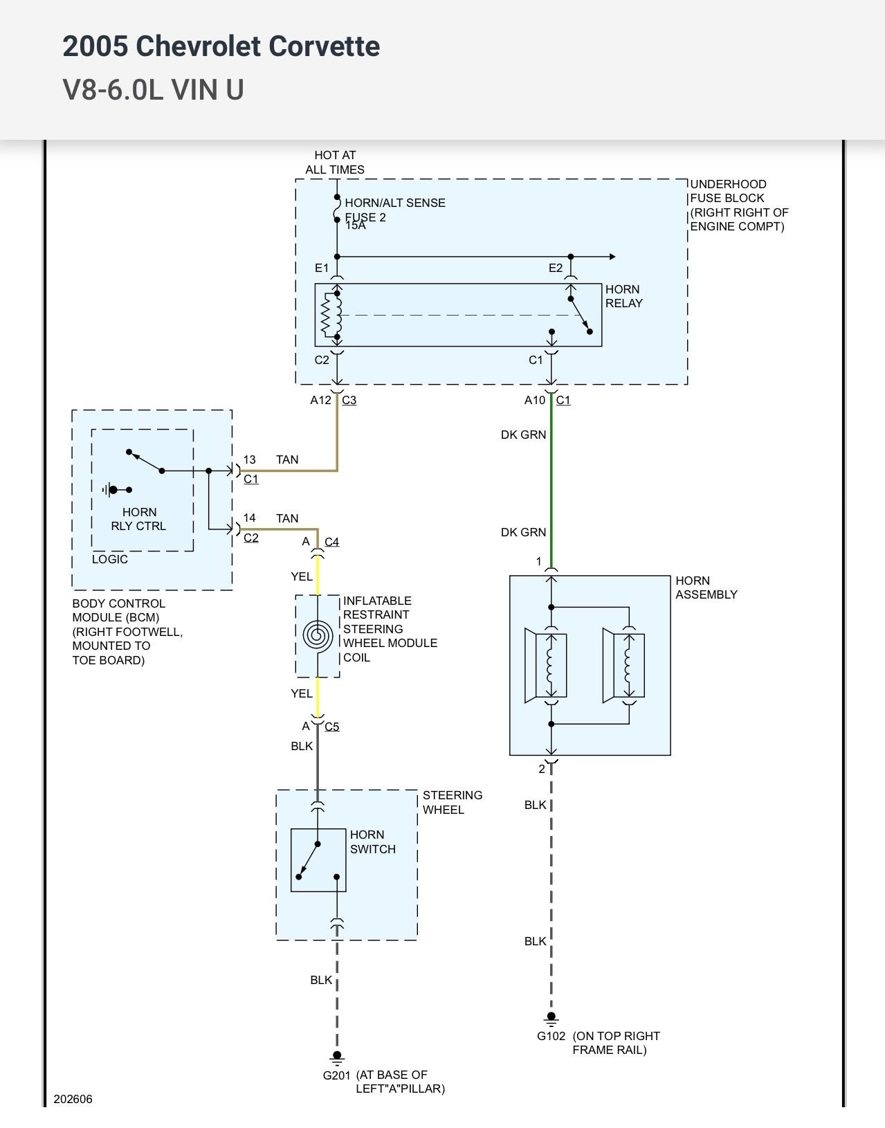

Hey guys having a weird issue on my 05 corvette which keeps honking when i make a right turn. Read that it could be a clock spring or bad ground but want more opinions, anything helps.

Sounds like a clock spring…not a ground.
