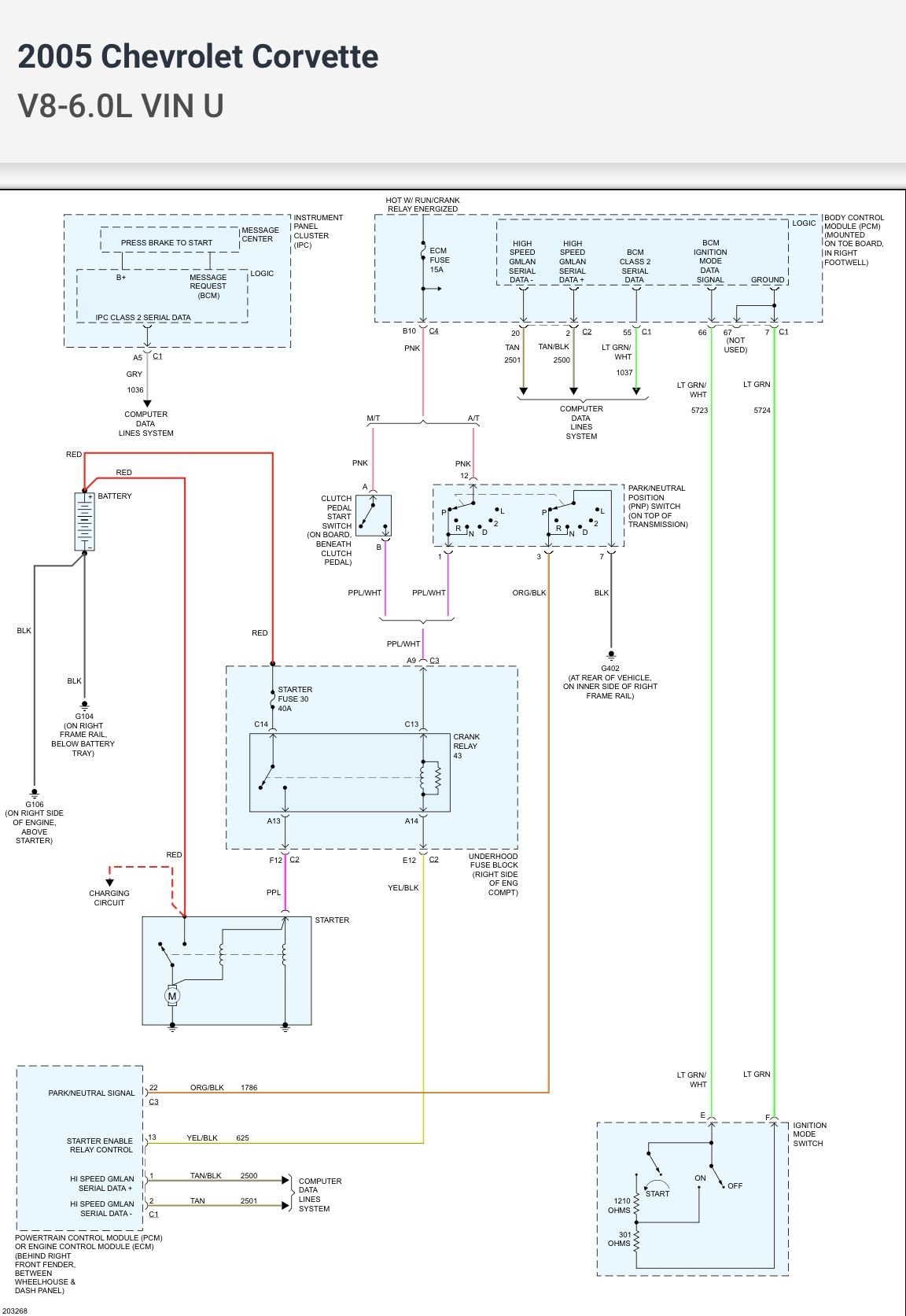

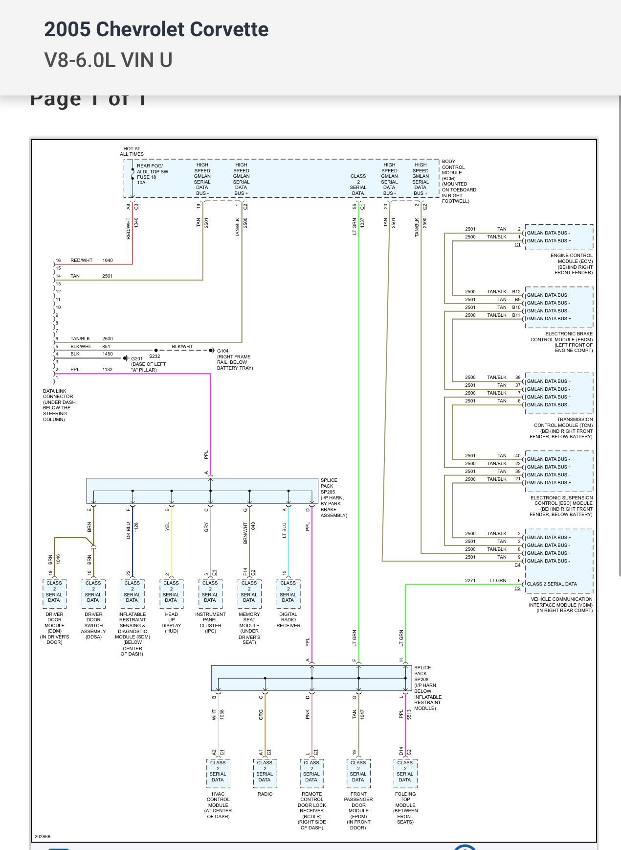

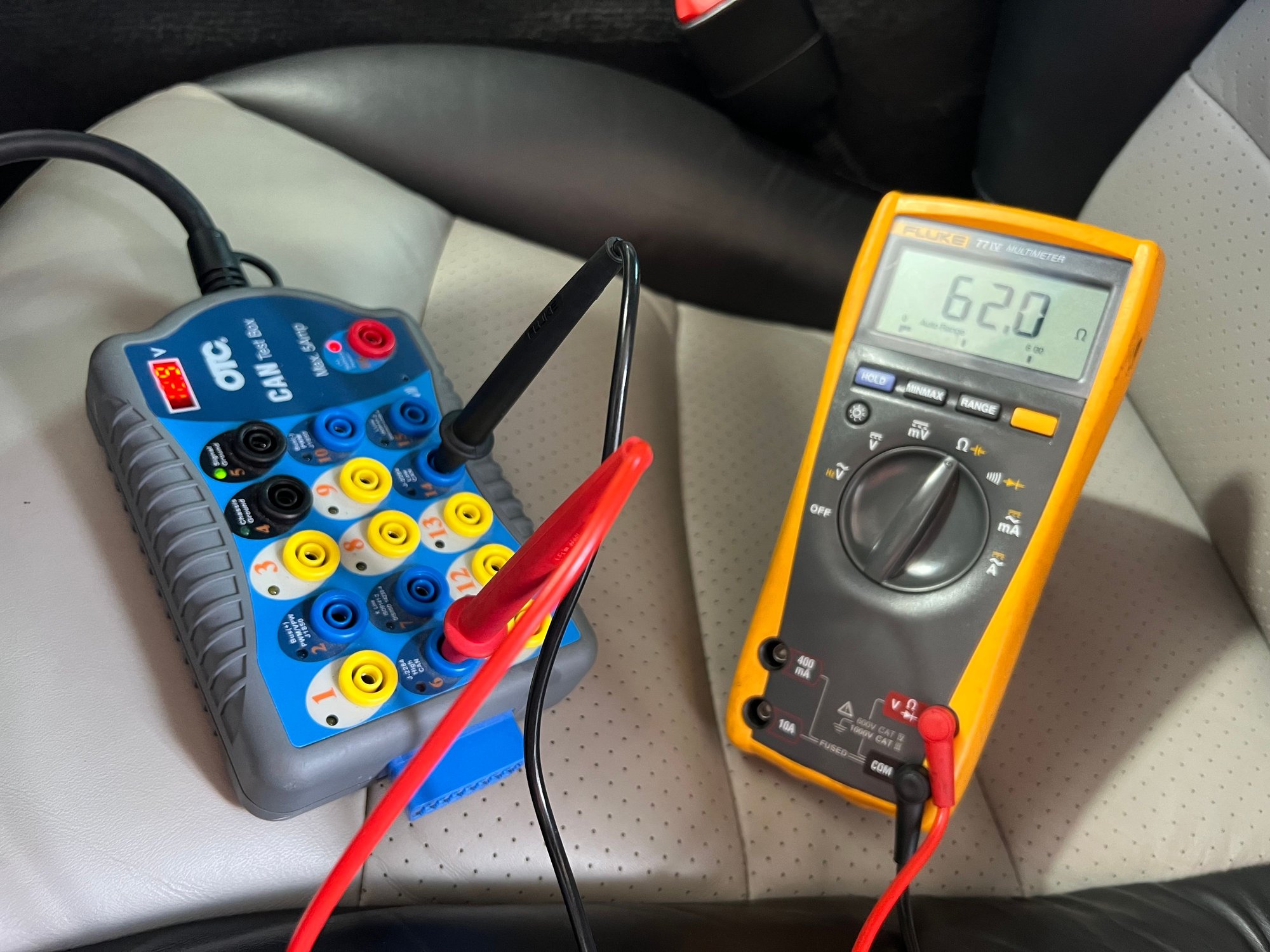

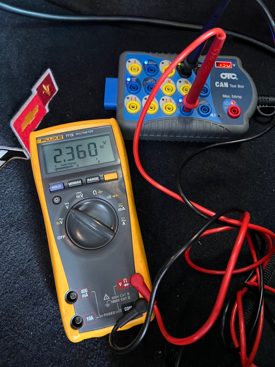

Below is the Information Bus for your 2005…there are a few checks you can do with your DVOM…you will be looking for 60 ohms between pins 6 and 14 of the DLC with the battery disconnected…you will also be checking for voltage at both pins 6 and 14 with ignition on.

60 ohms verifies wiring integrity.
CAN high Pin 6.
CAN low…Pin 14
