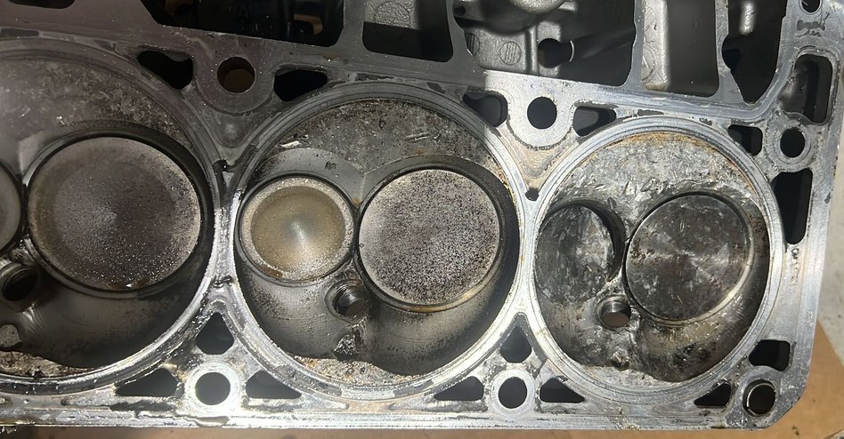

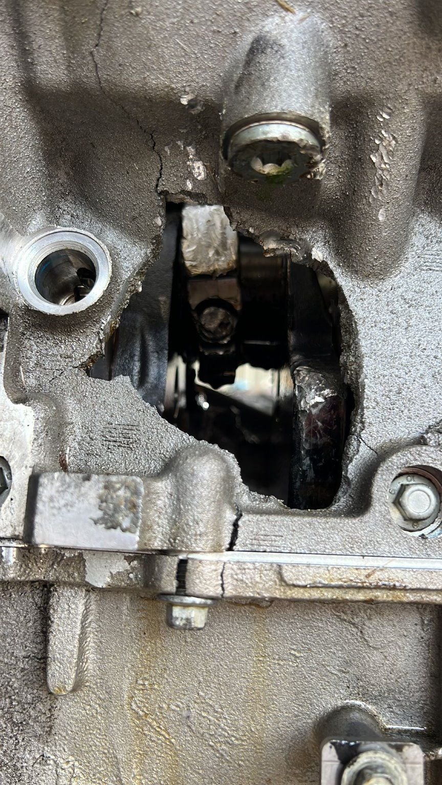

The background: At the Oct 2023 Texas Mile, my 2013 Z06 threw a rod through the block. That engine was the stock block with the following top-end mods:
Pat G Stage 1 Cam
Cylinder Heads ported, milled, re-valved, and re-sprung by Texas Speed
Johnson lifters
BTR Pushrods
Kooks Headers
NW throttle body
MSD Atomic Intake Manifold
Pat G dyno tuned to 550 RWHP/500 torque.
The goal was a NA build with great street manners that could break 180mph in the Texas Mile. 178 was the best achieved before the engine failed. Enjoy some photos of the afternmath:
Next post...the rebuild begins!

Ouch! The rod itself never broke, just deformed. That Titanium is some tough stuff.

Ouch! What caused that?
Old Aug 9, 2024 | 12:37 AM
noredlights's Avatar
noredlights
Joined: May 2009
Posts: 78
Likes: 6
From: San Antonio TX
Hard to say exactly. Shifts were on time without redlining.
There's a long thread here discussing LS7 rod failures: https://www.corvetteforum.com/forums...d-failure.html
Definitely scattered titanium chunks throughout the engine, back into the intake manifold, and even into the oil tank.

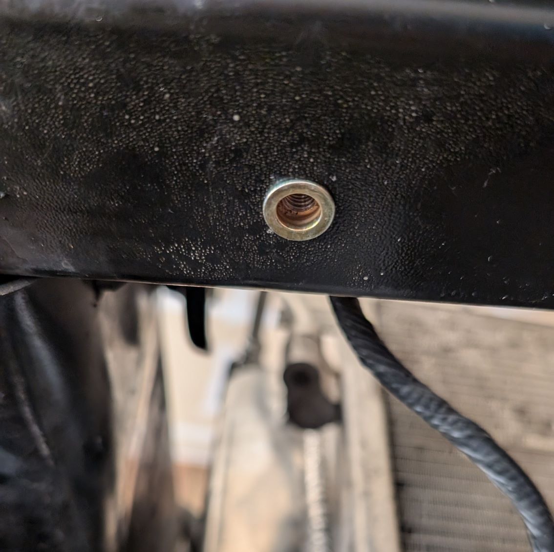

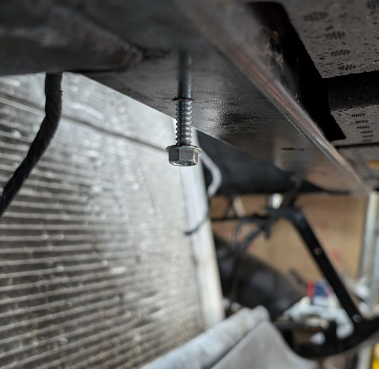

One complaint I have about A&A's Supercharger Kit is the Intercooler attachment: It's two self-tapping sheet metal screws to hold the entire 30+lb assembly in place. One of the screws stripped through pretty quickly, as there's not much frame material for it to grab on to.
My solution was to install M6 rivnuts, and secure the intercooler with some spare M6 bolts:
This should be a much sturdier attachment!
