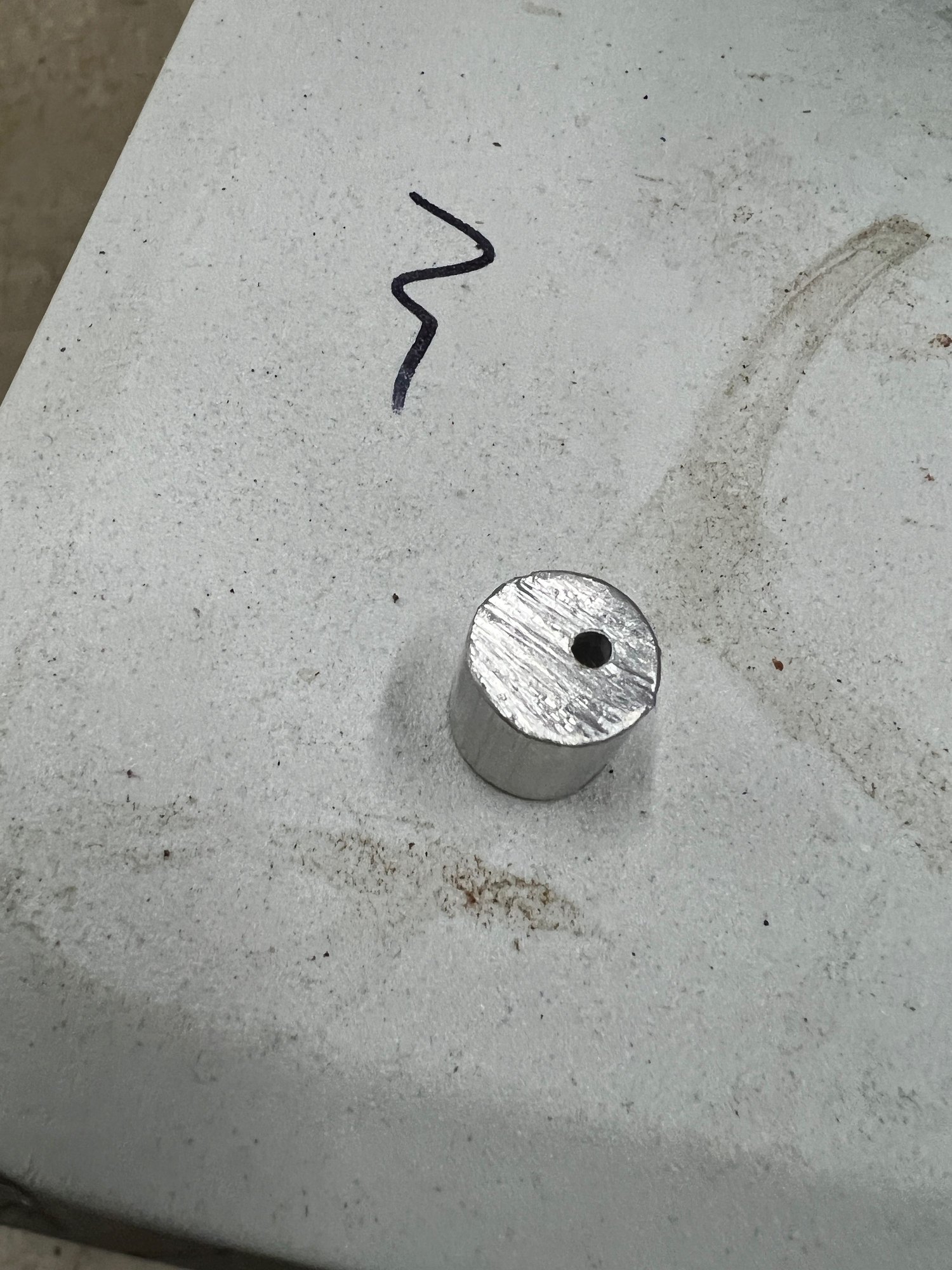

I run a restrictor in my heater core loop, just a slug of aluminum with a small hole drilled in it. I don't have a heater core, but the C6 setup can allow too much water to flow through the heater core, bypassing the radiator completely (I have thermal camera proof)
There are 3 loops in the LS water pump, the radiator, the thermostat, and the heater. Obviously you want most of the water going through the radiator. Plenty of water returns from the top of the radiator to the resevoir
Nothing balances the 3 loops other than the size of the holes. Somehow the balance was better in the C5 since the reservoir was part of the loop and on the passenger side, the dead-end setup with the C6 has created problems for many track cars that I personally know of.

Thank you for the data and picture.
David would you think the hose to the reservoir should be increased so as to have better balance like the C5? Any other tips and tricks?

The resevoir is just there as a backup in case you have a leak. Cars didn't have resevoirs for decades. However my return line from the radiator sends plenty of flow back to the resevoir to purge any air bubbles, AND it's on the hot side so no bypassing
