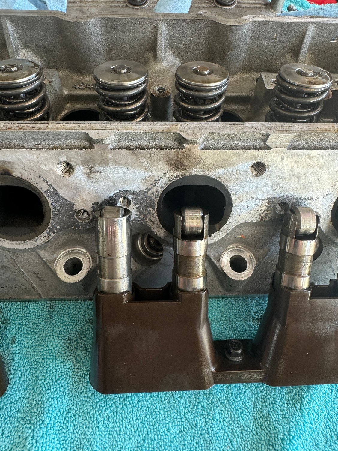

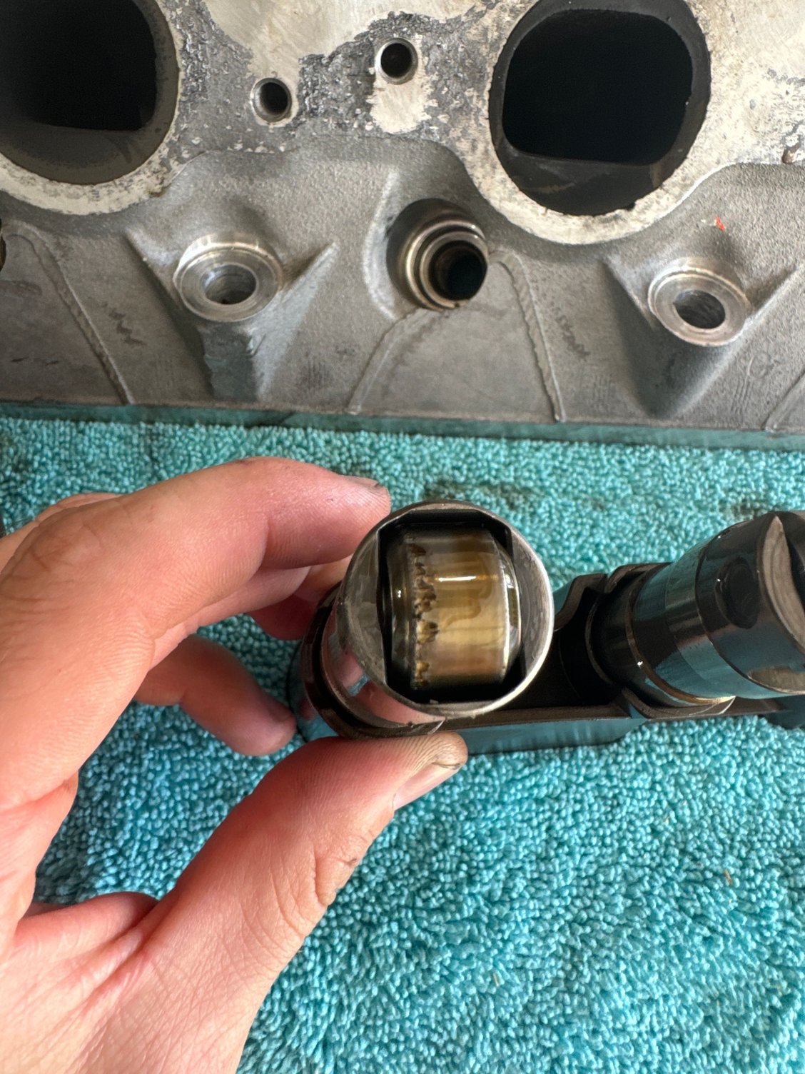

Default Found the issue
So I got my engine all torn down for people that are having the same noise my issue was in fact a lifter. It looks that one had been replaced at some point and they did not change them all or even use the same type and brand and the odd ball lifter has scorning thankfully the cam was not damaged.

Those other lifters are not stock as well. I don't know what brand those are. Most LS lifters don't expose that much of the roller.
You should definitely replace all the lifters and get new GM lifter trays.
