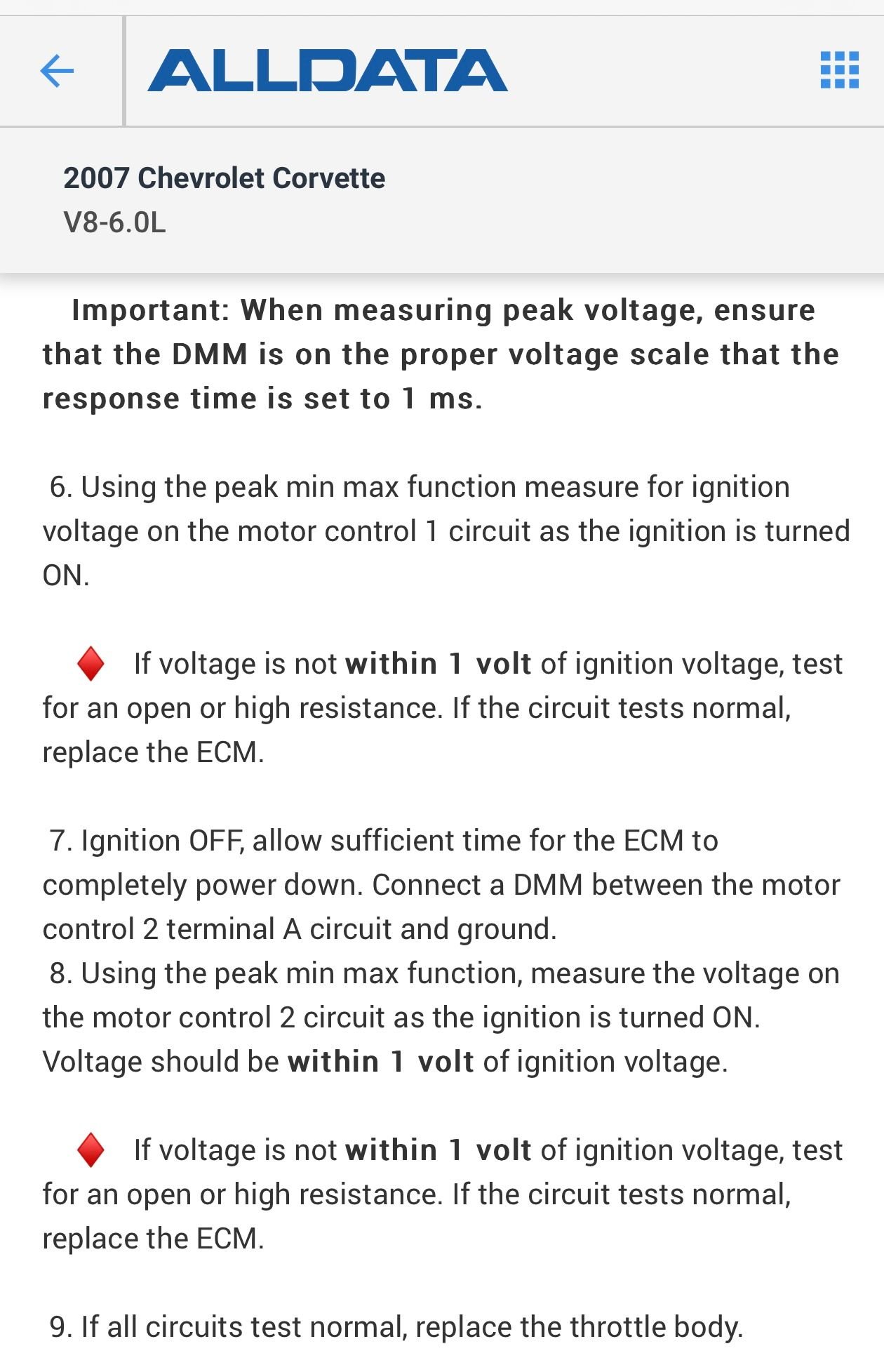

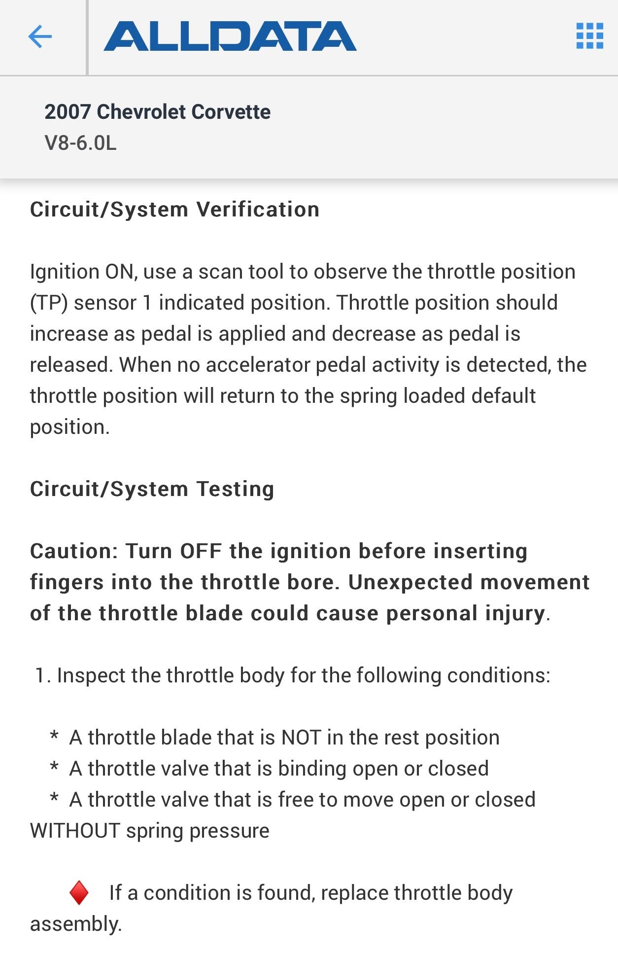

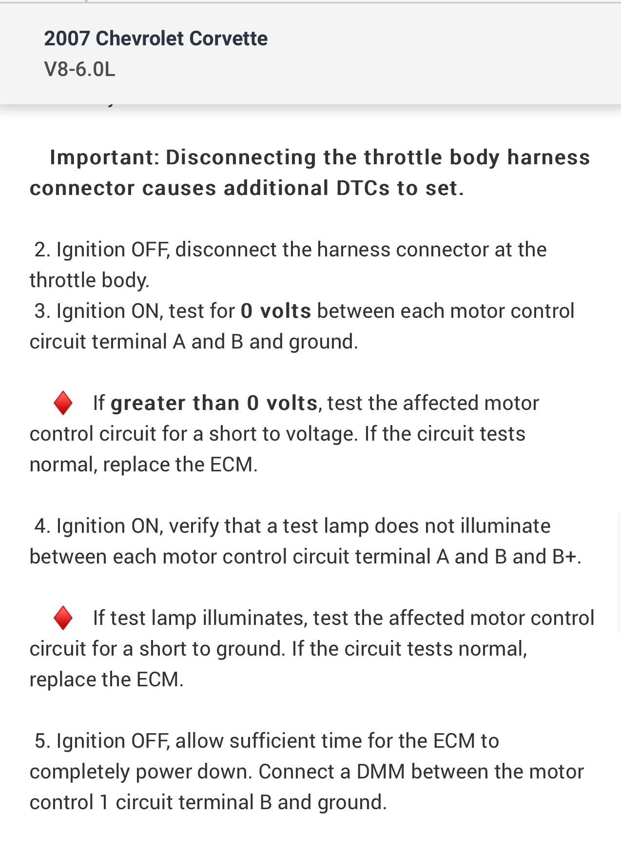

Should you have the equipment and the knowledge to test the electrical portion of the circuit it is below…best to have a good scan tool and a DVOM that has a min-max function…if this is over your head find an auto electric shop in your area !!
