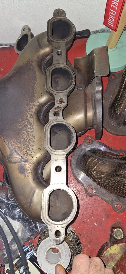

Originally Posted by Aardwolf
As above it doesn't bolt up. Some places like edgy vette port the ls2 manifold. There is the msd and dorman intake too. I go with the fast and am building one rn. It's a fun and pretty easy project.
I see Z06 manifolds off to the right...you putting those on in addition to the FAST?
Old Sep 23, 2024 | 05:01 PM
Aardwolf's Avatar
Aardwolf
Joined: Jun 2004
Posts: 13,961
Likes: 707
From: WI
Yes this base project with get the exhaust manifolds too. I didn't want it getting much at all louder so skipping headers for now. Flex fuel sensor there as well.
I may be wrong, but one of those exhaust manifolds doesn't look like a Z06 unit. The "D" port one does look like a Z06 unit. Z06 units had a more tubular construction look. They look exactly like my 2000 exhaust manifolds. But I'm from C5 land, so..... Just sayin'

Old Sep 24, 2024 | 06:25 PM

Old Sep 25, 2024 | 05:49 AM
grinder11's Avatar
grinder11
Posts: 12,864
Likes: 4,667
Yes, you are correct. As I stated, I have a C5, and I kinda dropped the ball on this one. I apologize. I'll say this; if it wasn't such a PITA to remove my Kooks 1-7/8 LTs, I'd pull them and offer them for sale. Another thing that keeps me from doing this is my Kooks 3" Xpipe, which bolts directly to the headers. The Xpipe would require serious alterations before it could bolt up to the GM manifolds. The OEM LS7 exhaust manifolds are very good, for sure. When Brian Thomson was in business, he had a C6 Z06 he tracked. According to him, when an LS7 is at 600chp, or less, the manifolds put out within 10 hp of the LTs. He did say they didn't have quite the midrange torque the LTs do. I see no reason he'd BS me, since he could sell me a new set of LTs......
