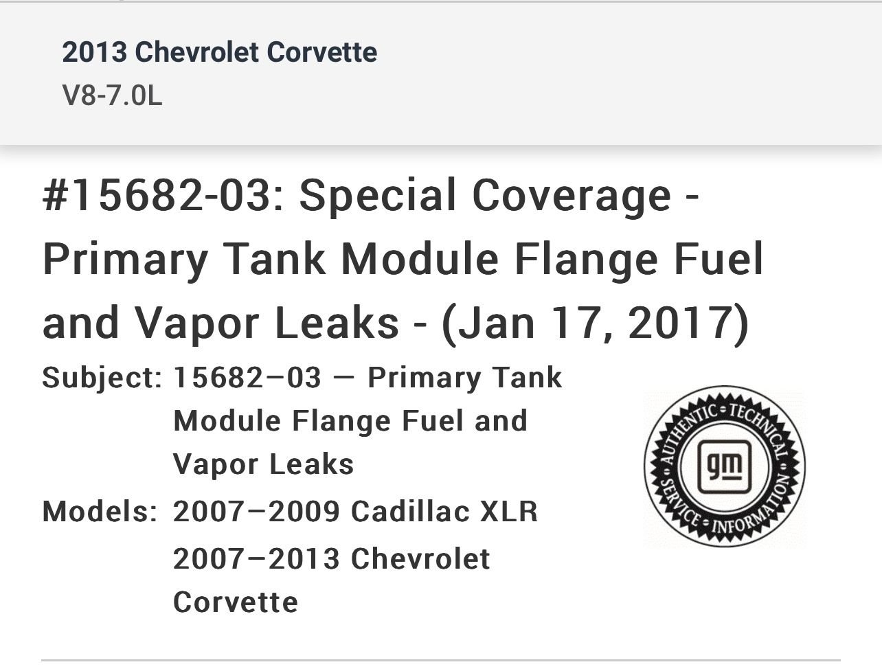

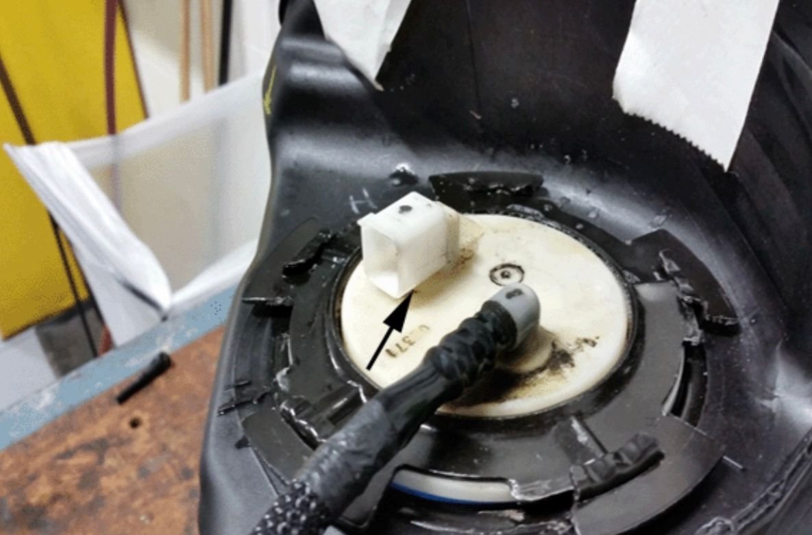

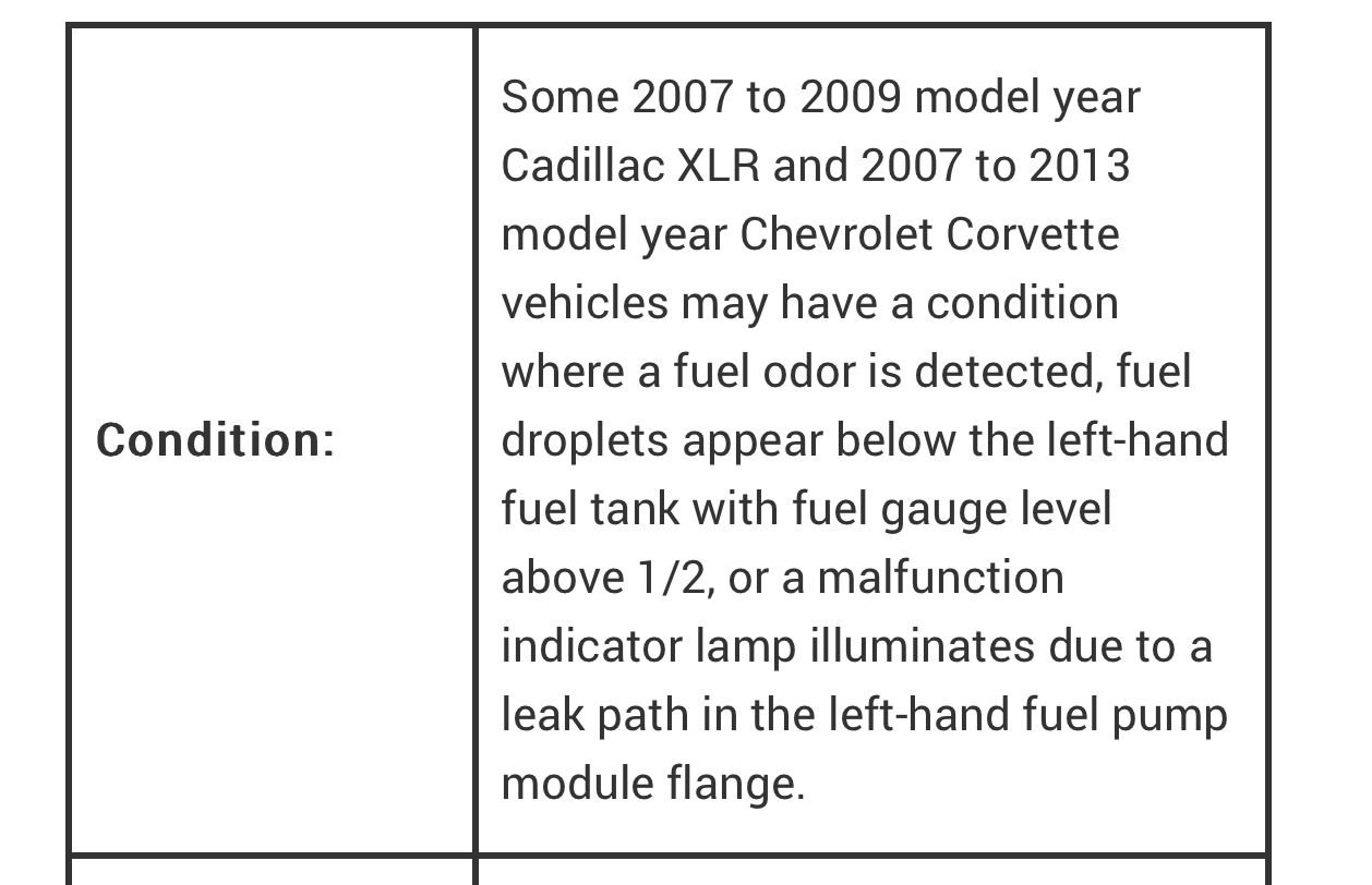

Most likely a cracked fuel pump flange…there is a TSB for this but this “Special Coverage” is no longer covered on C6’s anymore.

Its starting to become more common as our cars get older. It the fuel pump plastic elbow will crack and leak fumes. If you drive it below 1/2 tank it will probably go away. You will need the fuel pump replaced. Which is not the easiest job on our cars. Mine does it too. I just make sure I have 1/2 a tank or less of fuel before parking it indoors.
