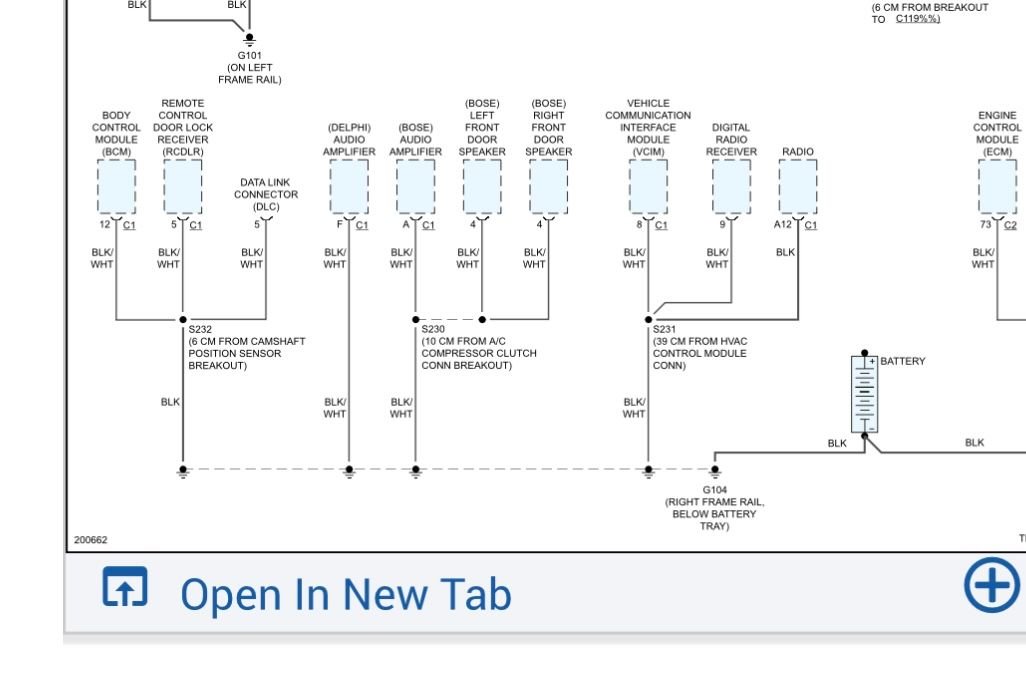

May also be a good idea to check ground G104 which is below the battery tray…if you do remove the RCLDR you can probe pin 5 on the C1 Connector and see if the ground is good by testing with a 12 volt test light connected to B+…you can first since pin 12 on the C1 Connector (J1) on the BCM since it is easily accessible.
