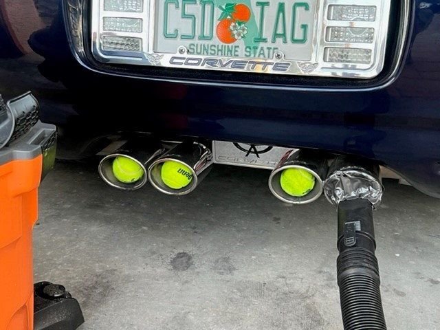

How do you have your smoke machine hooked up ???…If you have a shop vac hook the hose up to the exhaust side to blow the air out and use a soapy water solution to look for that exhaust leak…if you have some propane (I try not to use anything flammable) spray it around the engine while it’s running watching your fuel trims go negative…when fuel trims decrease you found the leak.
