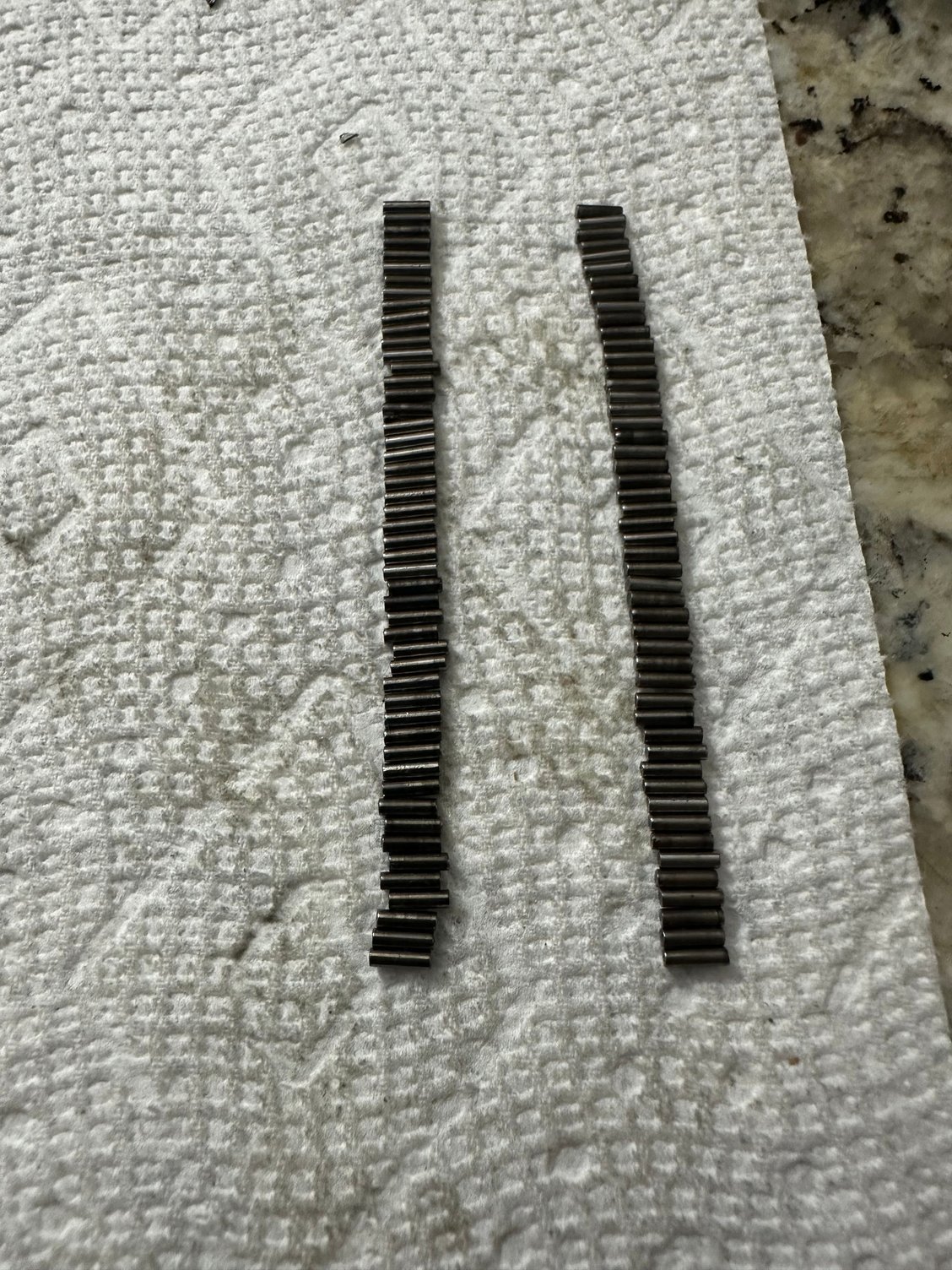

While it has been mentioned to remove the valve covers and make sure your bolts are tight... I would intentionally take it a step further and remove/inspect every single one of your Rocker Arms.... it only takes a few seconds to remove each one and physically inspect them.
I had a similar tick on my engine... it was after I installed a Texas Speed stage 2 Cam with new dual valve Springs as well as a new trunnion kit. I do NOT blame TSP, their customer service has been second to none. I chock this up as being part of the hobby. But hind sight is 2020... I would suggest going to a bushing kit over bearings on any cam swap.
About four months of daily driving after installing camshaft, it developed a slight tick at idle. It still make 495hp 454tq on the DYNO with the slight ticking... I assumed it was a lifter tick as it went away as soon as our RPMs went up... I continue to drive without much worry until I parked the car and placed it in storage with my insurance company to save a few bucks... while it was parked I took the valve cover off and found one rocker noticeably damage. On one of the Rocker Arms one bearing was completely gone needles as well as both inner and outer races.... It was as if no bearing had been installed at all... I was amazed at how soft the tick was and would have expected much greater valvetrain noise considering one complete bearing was literally MIA, however it was fairly quiet. On the same rocker, the other bearing had more than half of the needles missing and half of the inner race was gone... I did a quick visual of all the other others from a distance and did not see any that looked out of place.... so I called TSP who quickly sent me a new rocker which one kit pre-installed.
While waiting for this rocker to arrive, I decided to purchase a large 3" "earth magnet" and 2 magnetic drain plugs... with the earth magnet I dragged it on the bottom of the pan towards the magnetic drain plug... each time I pulled the drain plug out. It had needle bearings attached to it... I did this until I could no longer pull any metal out...
I installed the new rocker and fired up the engine. Only to learn there was still a tick.... immediately pulled both valve covers and took a much closer look... without removing any rockers, I found two more rockers that showed evidence of damage that I had initially overlooked. I immediately contacted TSP who shipped me two more rockers... after the phone call, I decided that I should really remove each rocker and inspect each one closer... this is when I found 3 more rockers that had worn out the race and where about to fail. This makes a total of 5 rockers at different stages of failure. 3 of them really were difficult to see when installed.
I then used a scope to stick down into all the cylinders and through all the push rod holes to search for more missing metal... the camera has a magnet on it, and I was able to find some small pieces.
im still missing large portions of the inner and outer races of 2 of the bearings. They are MIA.
inspecting the rocker shafts shows excessive wear on the bottom... also the mounting plate that sits under your rockers shows signs of wear as if the shafts are twisting side to side. Those are being replaced with new billet mounting plates to better secure the rockers.
moral of the story, if you hear valvetrain noise, it literally takes some common hand tools and about 10 minutes to remove your valve covers and about 10 minutes to remove, inspect and reinstall your rockers... possibly 10 more minutes to button it all back up.
still waiting on a CHE bushing trunnion kit... so while waiting I decided to remove the oil pan to see if there was any more metal in the pan... found nothing... it appears my magnet 🧲 fishing worked well.
since the pan is off I ordered an oil baffle and some earth magnets to stick to the baffle... this should help keep the pickup submerged and catch any potential valve train components in the future...
cause? I'm not totally sure, it could be the increased spring pressure and cam profile causing early rocker bearing failure. Perhaps the factory bolt torque is to low allowing the shaft to walk at higher rpm's which cause the plate to wear slowing for greater shaft movement leading to bearing failure?
I also plan on purchasing ARP rocker studs to add a few more lbs of clamping torque...
sorry for the long post... I guess I'm just trying to say, remove your valve cover and rocker then inspect each one one by one...

Sorry for the long post... I guess I'm just trying to say, remove your valve cover and rocker then inspect each one one by one...
SPEED SAFE
This is all fantastic info to have, thanks! I'll forward this to my brother. You're right, it doesn't take too much time to just pull the rockers off and inspect them. I've read the needle bearings are a weak point and if they fins their way into the cylinders I can only imagine the damage they'll do. It's also good insight to my personal plans with my C7Z. I plan to have a TSP cam package installed with DOD/AFM deletes, stiffer springs, hardened pushrods, and an upgraded trunion kit to eliminate the needle bearings. I'm surprised the bearings on your rockers failed...kinda has me a bit on edge about their kit but I'll talk to my tuner since he's doing the install and ask what he's seen with them.
Over the winter we will tear off the valve covers and take a close look at the rockers and see if there's any chips or needle bearings missing like the pictures you sent. My guess was either a lifter or valve guide which seems to be the consensus here.
