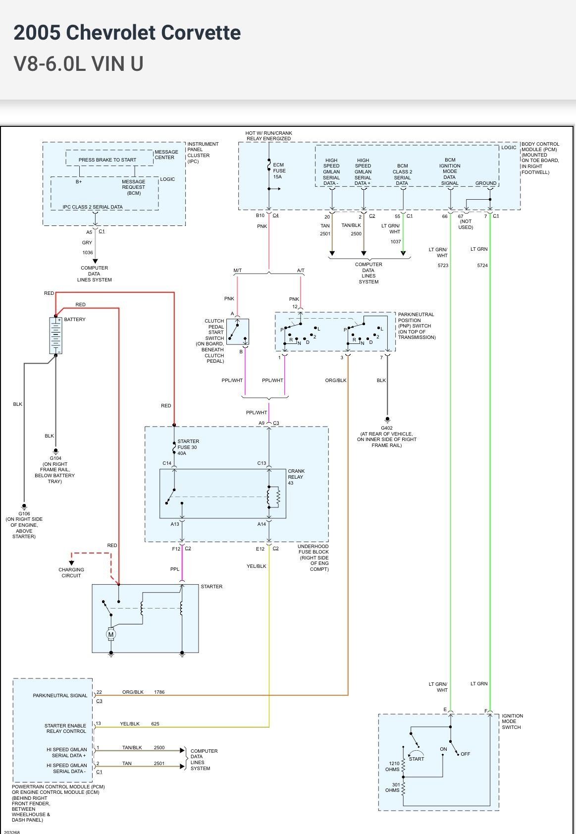

Best to get these 4mm banana jack test leads with different connectors like back and piercing probes and alligator clips… hold off on the starter connections as your issue may be on the “control side” of the starting circuit…do you know how to follow a wiring diagram ??…we will check to make sure that crank relay 43 is functioning correctly…get yourself a paper clip and we will “hotwire” the starter at terminals 30 and 87 of the crank relay….since you have an auto try starting the car in neutral instead of park…also get a 12 volt test light if you don’t have one…minimum you should have to do electrical is a good DVOM, test light and that kit posted below.
Old Dec 24, 2024 | 12:07 PM

I'm more mechanical but can follow the wiring diagram similar to a piping diagram.
I did just put the prime rib in the oven so won't be on this now.
I don't know what terminals 30 and 87 are but I see the wiring and the relay.
I only have a fluke no test light or clips.
Greg

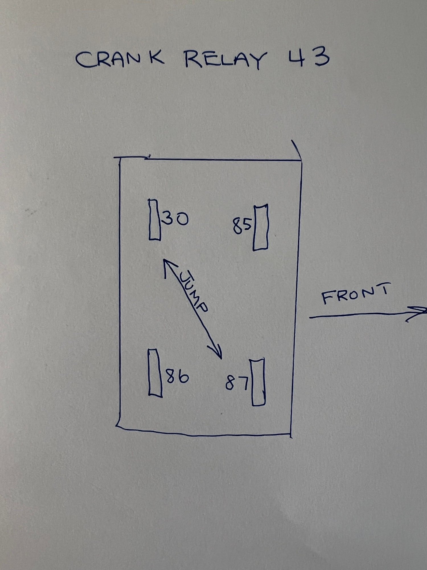

Looks like your ground voltage drop was good at 0.03 volts…below is crank relay 43…arrow is facing forward.
1) with car in park or neutral jump terminals 30 and 87 with paper clip…no need to touch the start button…engine should only crank…if you do this a few times and starter cranks you don’t have an issue with the “load” side of the starting circuit.
2) now connect test light to battery negative…test light should illuminate on terminal 86 when you push the start button…if run/crank relay on the bottom of the BCM is energized the light will illuminate.
3) connect test light to battery positive…test light will illuminate when probing terminal 85.
If engine cranks consistently jumping 30 and 87 you may have a bad crank relay 43 or run/crank relay on bottom of BCM….you can try swapping crank relay with another.
