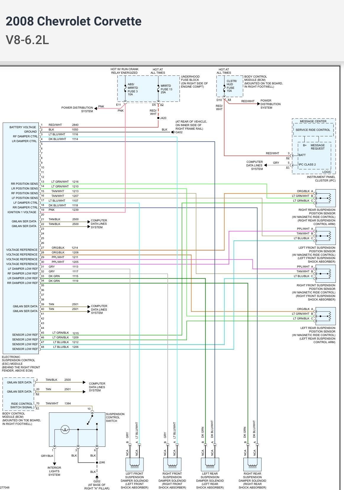

Do you have a factory level or equivalent scan tool ??…if not the best you can do is test each sensor with a DVOM…these sensors are basically a 3 wire potentiometer…a 5 volt reference, low reference (ground), and a signal…with that type of scan tool you could jumper the 5 volt reference to the signal and you would see 5 volts on the scan tool signifying the signal wire is good…so basically you can test 2 out of the 3 wires..if you go from the 5 volt reference to the low reference you should see 5 volts…if no good you would have to check the 5 volt reference to a good ground and you can use a 12 volt test light connected to battery positive and when probing the low reference the test light should illuminate.

Old Dec 29, 2024 | 09:39 AM

Old Dec 29, 2024 | 02:48 PM
C5 Diag's Avatar
C5 Diag
Moderator, Tech Contributor
Posts: 15,600
Likes: 4,059
From: Cape Coral, Florida
Forgot this !!
