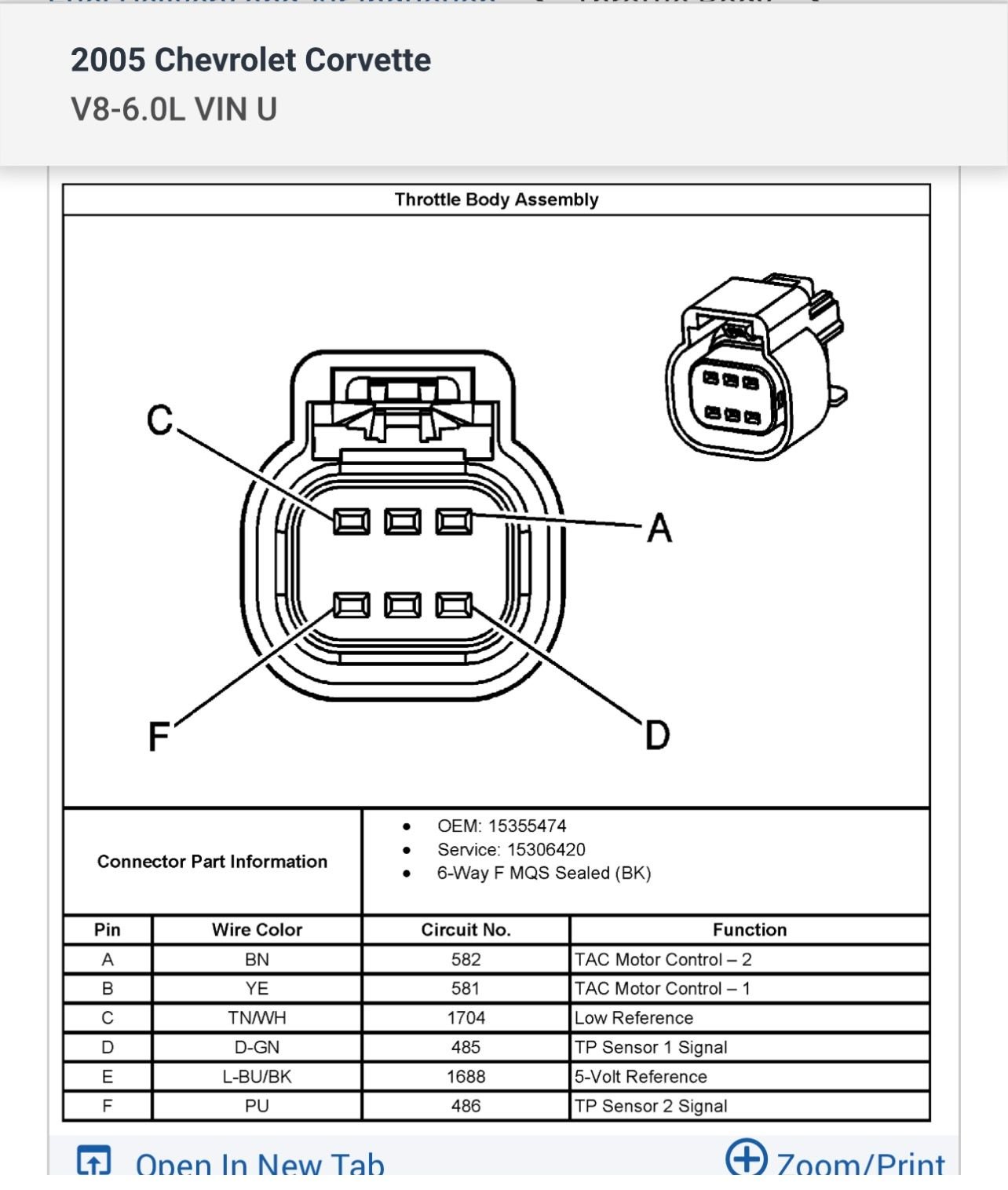

2005 C6 manual. about 20 minutes into driving, everything is going nice and smooth. All of a sudden I will lose complete control of the throttle on the pedal. The car will idle normal but when I hit the accelerator it will do nothing. I restart the car and everything works fine. No codes and vehicle doesn't go into limp mode. This happens at least once every two weeks. What could this be?

I’d check the connector at the TB…look for loose or damaged pins especially TAC Motor Control.
