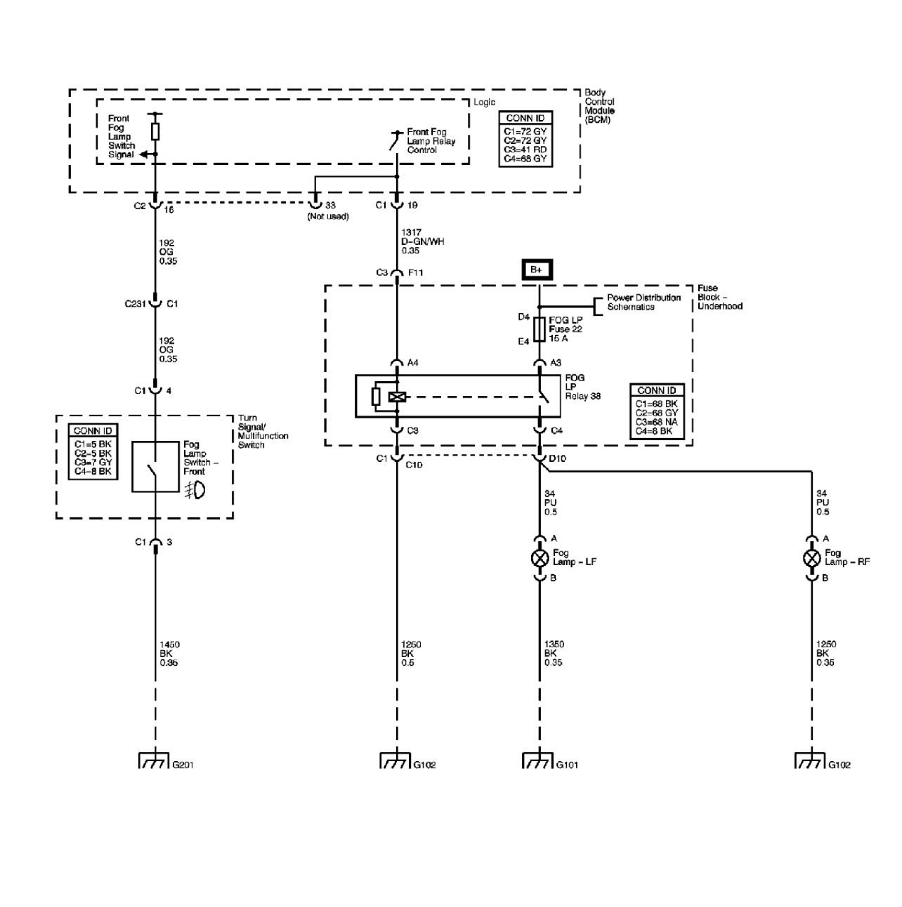

Do you have a 12 volt test light and know how to read the wiring diagram below ??…you could try swapping the relay with any 4 pin relay and see what happens…each light had its own separate ground so its unlikely a bad ground…it may also be a poor connection at the relay or an issue with the relay control circuit.

A bad "ground" in your case would not be the cause as there are 2 separate grounds in the circuit...a ground is needed for the lights to work...as mentioned this may be an issue at the fuse box ...does your fog light indicator remain illuminated when they go out ???...the BCM is looking for an "input" from the fog light switch to energize the relay to make the fog lights illuminate…a power issue at the fusebox can be diagnosed at the relay without first removing the fusebox.

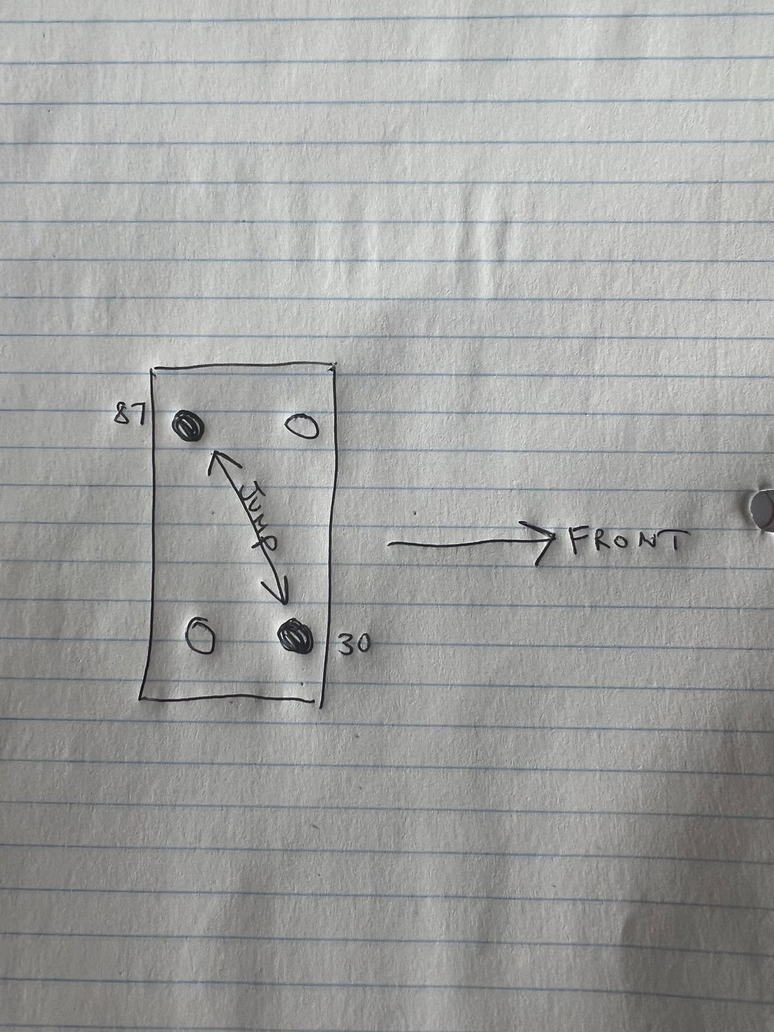

OK, great !!…when the fog lights go out if you have a paper clip bend it into a U and jumper the 2 terminals of Relay 38 below…if there is in issue in the fuse box the fog lights will not illuminate…pictured as if you are bending over the fender.
