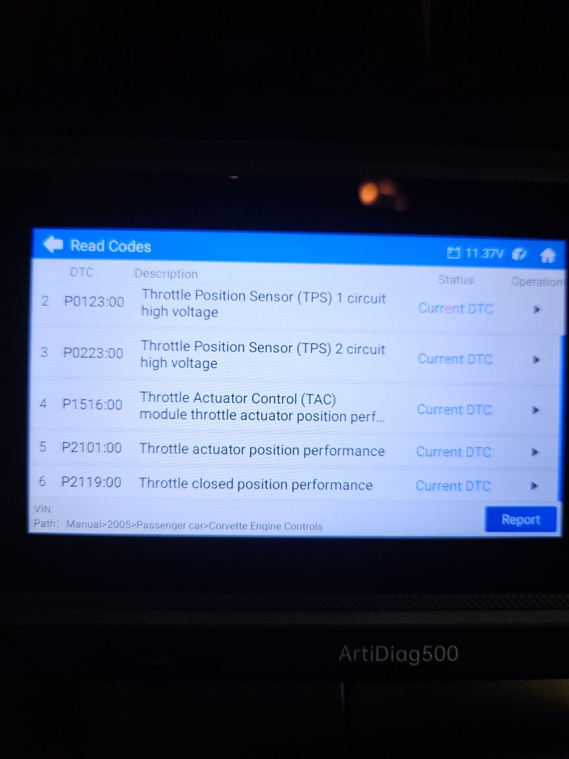

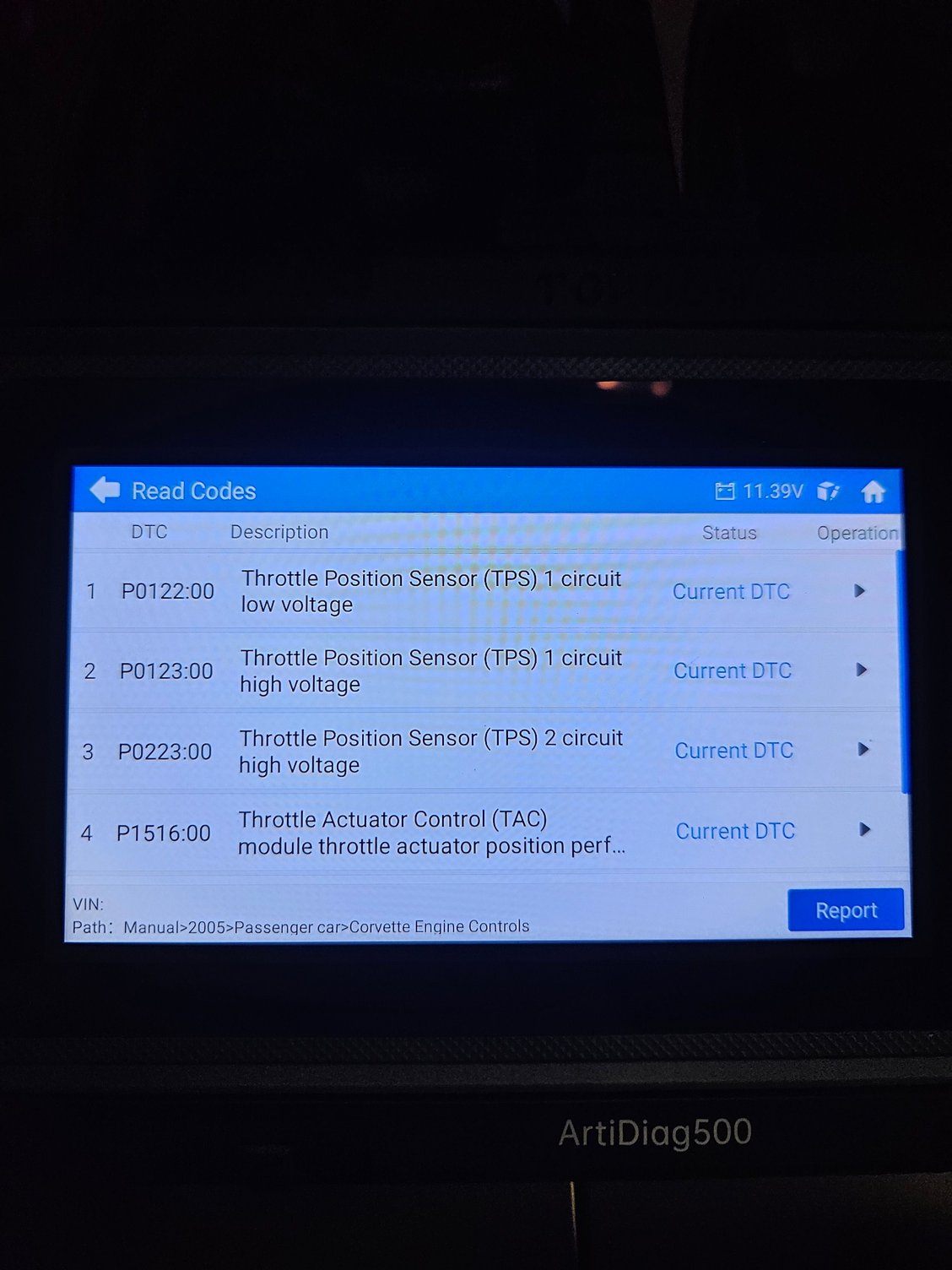

hoping someone can help me with this. 2005 c6 manual 45k miles. Had the engine rebuilt recently. Got her back in & everything was good on first start up until it warmed up & went straight into "reduced engine power" mode with a cel. Scanned codes & they came back with 6 codes initially. Cleared the codes & the second i started her up it came right back. Did a throttle relearn procedure that's in the scanner & did the same thing immediately. When the car is in acc mode the throttle body & acc pedal have complete signal to each other but as soon as it starts up it'll throw the code & run rough. The throttle body loses complete signal from the pedal. If it's cold it will not do until it's warmed up. I've checked all my ground wires & they are all good. I cannot wrap my head around this. Battery was out of the car for roughly 6 months while the engine was being rebuilt so it didn't get any power for that period of time. Battery is practically new & was on a tender for a few days before going back in. Any ideas? New accelerater? Throttle body? I'm stumped!

Silver Blade TBs are a bit notorious for this… TPS becomes erratic when warm/hot. I’d recommend opening up the cover and spraying contact cleaner on the potentiometer whenever you get the error. Otherwise, you’ll need to replace it.

ok so i ended up buying a new dorman throttle body. Was cheap enough to justify the purchase & figured if it didn't work i could just return it. The issue still remains though but now when it goes into reduced engine mode the car isn't stumbling just has reduced throttle & will actually stay running like normal. It's opening up too 100% throttle position when the accelerator is pressed just takes a while to raise the rpms. Also I'm only throwing one code (P2135). I did read somewhere that it needs a throttle relearn procedure done & it consists of driving the car up to 44mph, idling for 3 minutes, shutting it off for 60 seconds then letting it idle for another 3 minutes. I also read that there is no relearn procedure for these. Either way I feel like I'm in the right direction with it atleast running "normal" when the reduced engine light is on. Would you think that the accelerator pedal could be bad?
