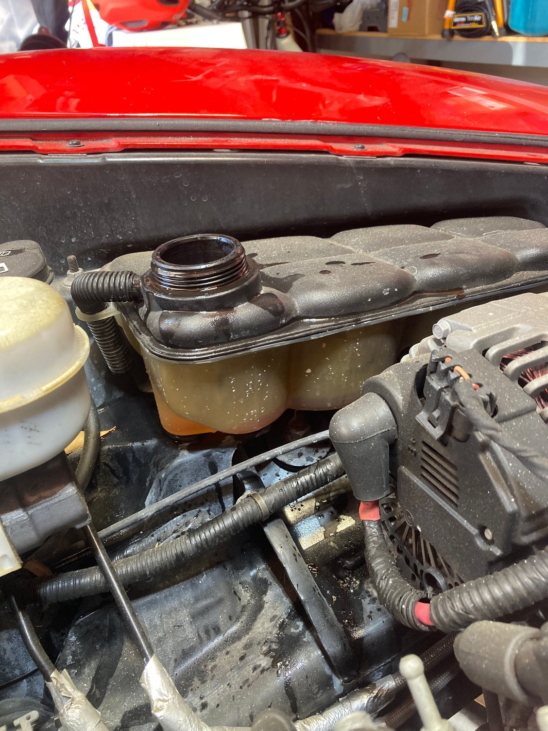

Hello friends,
im working on my brothers car that is overheating and I’m a bit lost.
he has a Dewitt’s radiator and lingenfelter oil cooler and when I replaced the valve on his radiator and tried to fill the coolant reserve it emptied a couple times then on the 3rd it started to overflow a bit so I turned the car off and now the tank is almost empty. Is this normal?
God Bless,
-Will
Coolant tank almost empty after turning car off

It is. You've got a big slug of air in the system. It should burp out if you keep running the motor with the cap off, adding coolant when it runs low. You can prevent the problem in the first place by using a vacuum filler.
You say it's overheating. Was that before you worked on the car, or after? How hot is it getting?

thanks for the tip! I had meant to respond earlier but I wasn’t signed in, the car was overheating before I worked on it and I got the air bubble out by adding coolant then closing the cap and it worked itself out. The car was overheating before I touched it and my brother had reported it hitting 260 but I think he may have exaggerated a bit. Under my car it only got to ~250 while I was giving it fluids and after I got the bubble out it was idling just under 220 for 15 minutes straight in the hot garage. I’d call today a success!
