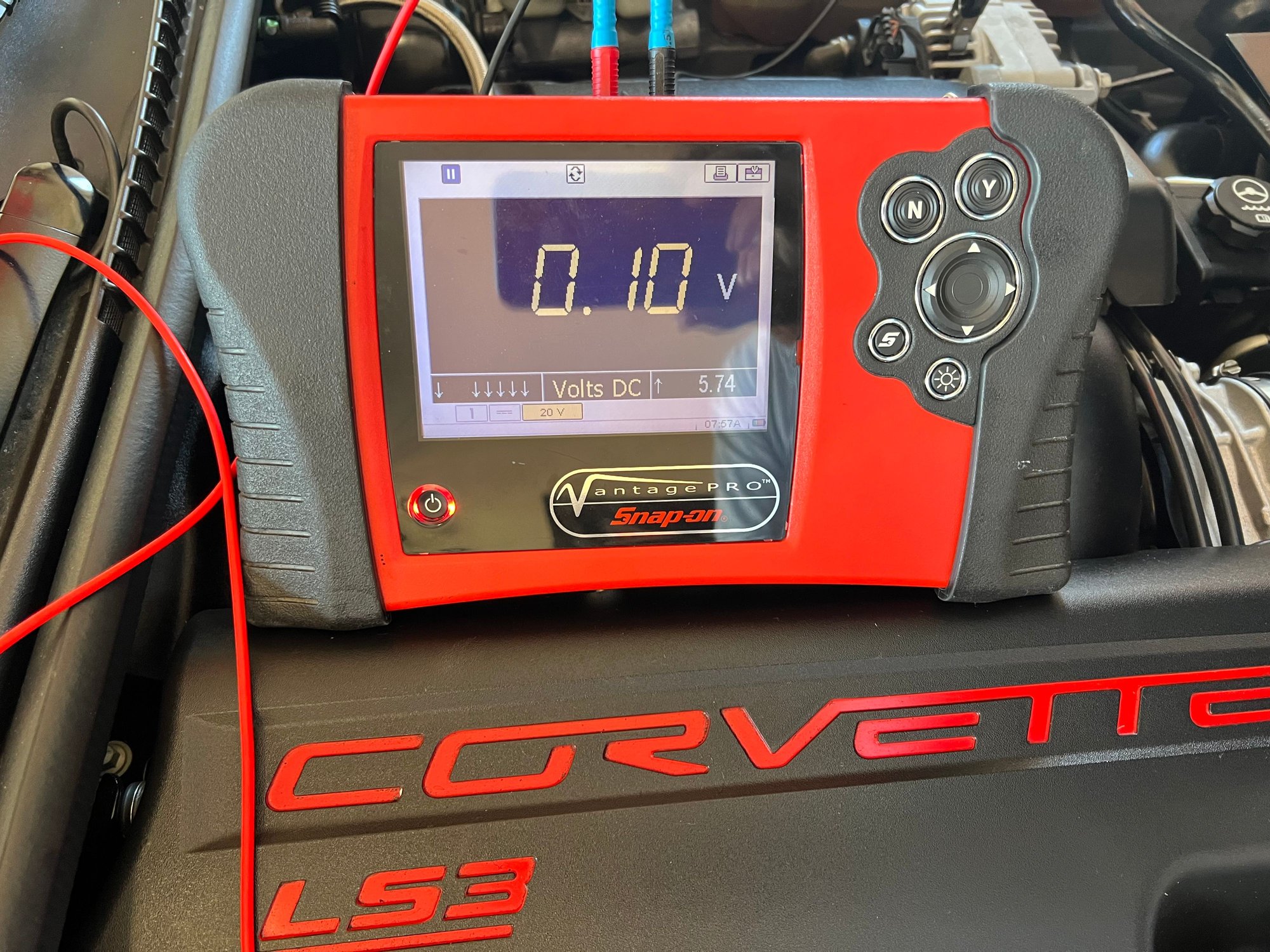

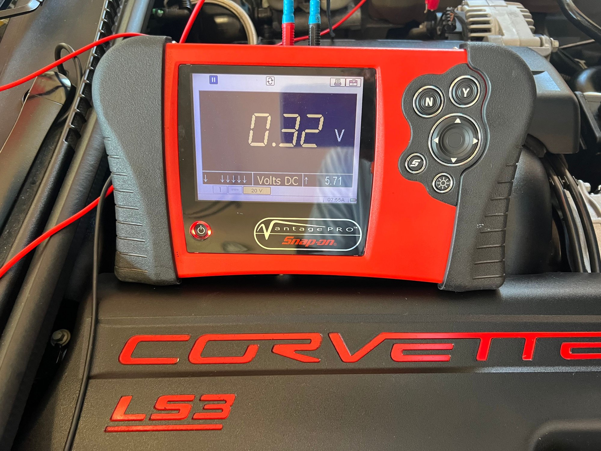

To do the charging system voltage drop check run the engine at 2500 RPM and if you don’t have a scan tool to set the RPM a 2x4 wedged from your seat to the gas pedal can do that…put some loads on the electrical system such as high beams, AC, blower on high, seat heaters…place DVOM on a low voltage setting because you shouldn’t see more than a 0.5 volt drop on positive or negative side…place positive lead of meter on the alternator B+ and the other lead on battery B+….shouldn’t be more than 0.5 volt…now place black lead of meter on the alternator case and red lead on battery negative…still no more than 0.5…I will post of picture of my reading below…I would also make sure you don’t have a parasitic draw on the battery when the car sits…disconnect the negative terminal and place meter on amp setting and place meter leads in between (in series) the disconnected cable and battery terminal…max current draws depends on the RC of the battery…use RC divided by 4…100 minute RC is 25 milliamp max…it may take 15-20 minutes for the cars modules to go “to sleep”…you will see it slowly decrease.

.32 on positive side
.10 on negative side.

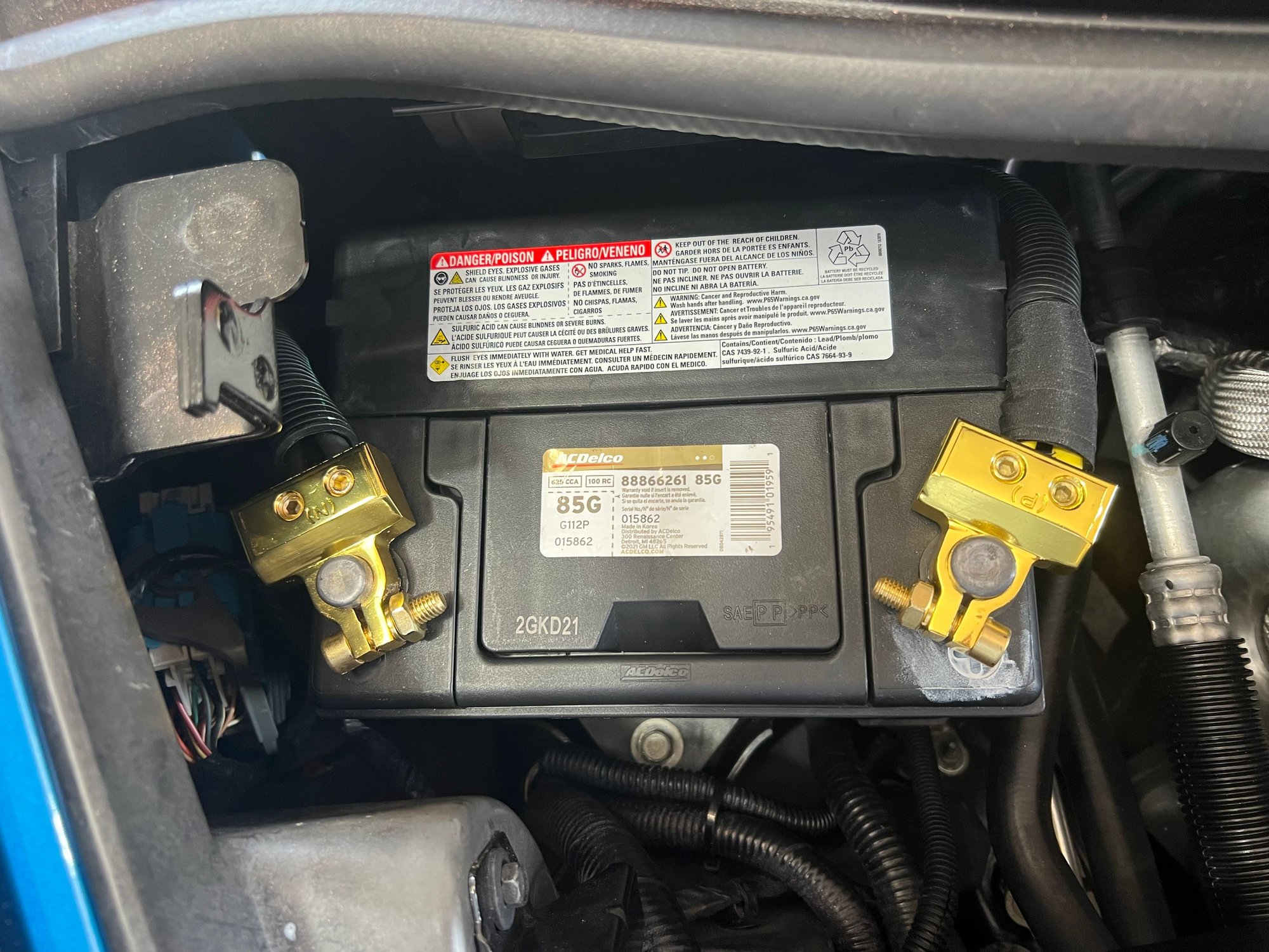

new battery in and charging circuit test ok... Haven't done terminals yet as I need to find a good solder iron for that size cable.. will do a parasitic check this week, but don't think that's the issue... old battery looked to be bulging a bit on the sides...

After I installed mine I found the same ones on Amazon but with the plastic covers…the covers fit perfect and now I have 2 extra terminals…around $15.00 !!
