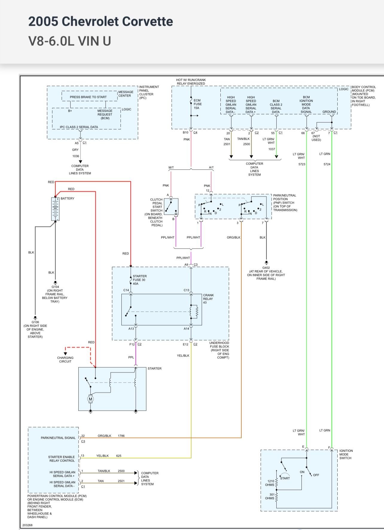

Old Feb 16, 2025 | 01:10 PM
cs641's Avatar
cs641
Joined: Feb 2025
Posts: 39
Replaced the reverse light switch. Car is acting up again. Will not crank. Error message saying shift into reverse.
If I crawl under the car and jumper the wire at the sensor reverse lights don’t come on and dash still says shift into reverse.
tried manually putting voltage to the starter with the car in run and no luck.
stuck on side of road. Need help
Old Feb 16, 2025 | 01:15 PM
cs641's Avatar
cs641
Joined: Feb 2025
Posts: 39
Wanted to add that with the starter jumped it cranks but will not fire even though car is in run

Old Feb 16, 2025 | 01:29 PM
C5 Diag's Avatar
C5 Diag
Moderator, Tech Contributor

Do you at least have a 12 volt test light and a DVOM and know how to use it ??..unfortunately we can't diagnose your car for you over the Internet...if the car cranks jumping the crank relay we know the "load" side of the starting system is functional...you have to worry about the "control" side....will it start with the FOB in the glovebox "slot" ??...that backup antenna where you put the FOB has to work whether the FOB is good or not for the car to start...if testing is over your head find an auto electric shop as they are the most knowledgeable.

Old Feb 16, 2025 | 01:43 PM
cs641's Avatar
cs641
Joined: Feb 2025
Posts: 39
Fob is in the slot.
12V+ at the reverse light switch on the trans. In theory the computer is seeing the reverse light switch as good
Old Feb 16, 2025 | 01:55 PM
C5 Diag's Avatar
C5 Diag
Posts: 15,600
Likes: 4,060
From: Cape Coral, Florida
Originally Posted by cs641
Fob is in the slot.
Can you remove the connector at the clutch and see if you have continuity across the switch when you engage it ??...just because you have 12 volts going to it doesn't mean it's going across.

Old Feb 16, 2025 | 02:02 PM
cs641's Avatar
cs641
Joined: Feb 2025
Posts: 39
The reverse light switch or clutch pedal switch?

Why you messing with the reverse light switch ??...it has nothing to do with the car not starting.
Old Feb 16, 2025 | 02:03 PM
C5 Diag's Avatar
C5 Diag
Posts: 15,600
Likes: 4,060
Clutch pedal...look at the wiring diagram....we can see if you are getting power to the ECM fuse at the BCM when the start button is pushed...you will need 2 people to do this...use a test light at the fuse....we may need to check if the backup antenna is good...you will need a voltmeter for this using the AC VOLTAGE scale.
