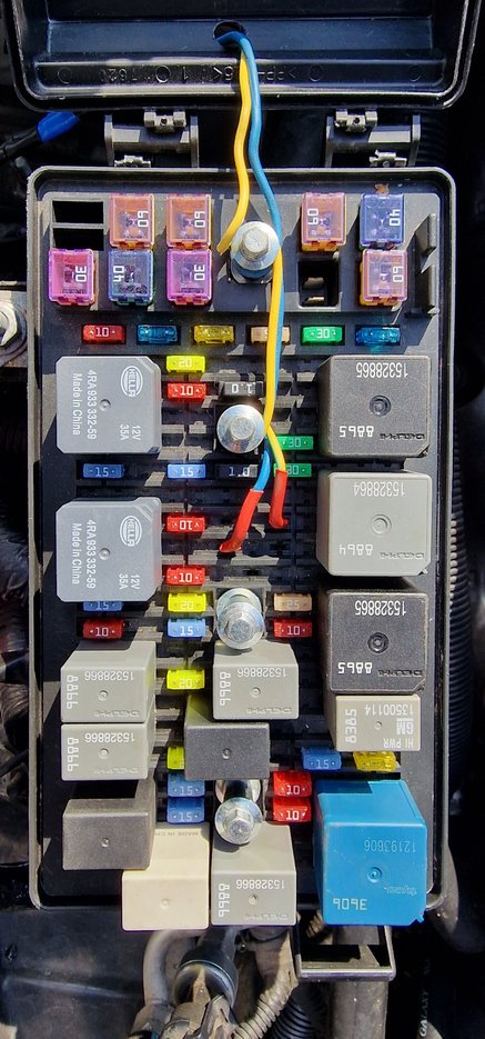

As for the relay, I installed a really bad solution. First I had a switch in the glovebox to turn on the relay manually. And Off when parking. Very cumbersome, and sometimes I forgot to do it alltogether. After a while I had the idea to take power from the heated seat fuse in the footwell which incidentally gets power when the start button is turned on and loses power when the car is turned off. So I put that to the relay side after checking that the power draw is somewhat minimal (Below 1 amp I seem to remember) Voila - car starts and turns off as usual. I still see it as a temporary solution, but it is really hard to find anybody here in Germany who can properly diagnose (or even program a new) module for that car as it is as exotic as a Ferrari over here. This summer I will disassemble the whole thing again and check if there is perhaps a broken cable coming from that module behind the right fenderwell to the fusebox. I am not 100% sure I checked the correct cables last time.
OK, sounds good…we can address that relay issue again once this starting issue is fixed….I’d have to reread what was done with the relay…don’t remember if it was a power or control side issue.

Control side didn't get ground signal.

Was it crank relay 43 in the underhood fusebox or the run/crank relay underneath the BCM ??

It was relay 44 Powertrain ignition 1 in the underhood fusebox
btw, the long cranking started long before the relay 44 modification, so I would rule that out as a culprit.

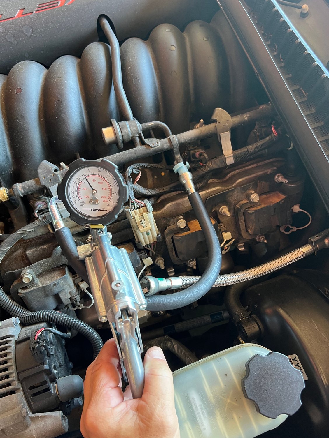

I would still want to check that an injector is not leaking before confirming that the check valve is bad…there are 2 ways to check but I use my Mityvac and pump 15 psi into the fuel rail and see if it bleeds down as shown below on a C5 I did last year…you may be able to pick up the 2 hoses with shut off valves on them and this is the OEM tooling from Kent Moore who supplies GM with this type of equipment..you can make this yourself with some fuel lines and shut off valves with the 3/8 and 5/16 fuel fittings.

Oh no, replacing the fuel pump again will kill my mechanic and my wallet...... I wish it would be on my C4, so easy to reach, but on the C6 it's a nightmare.
i will try and find the hoses for the leakdown test, somebody must have them around here......
