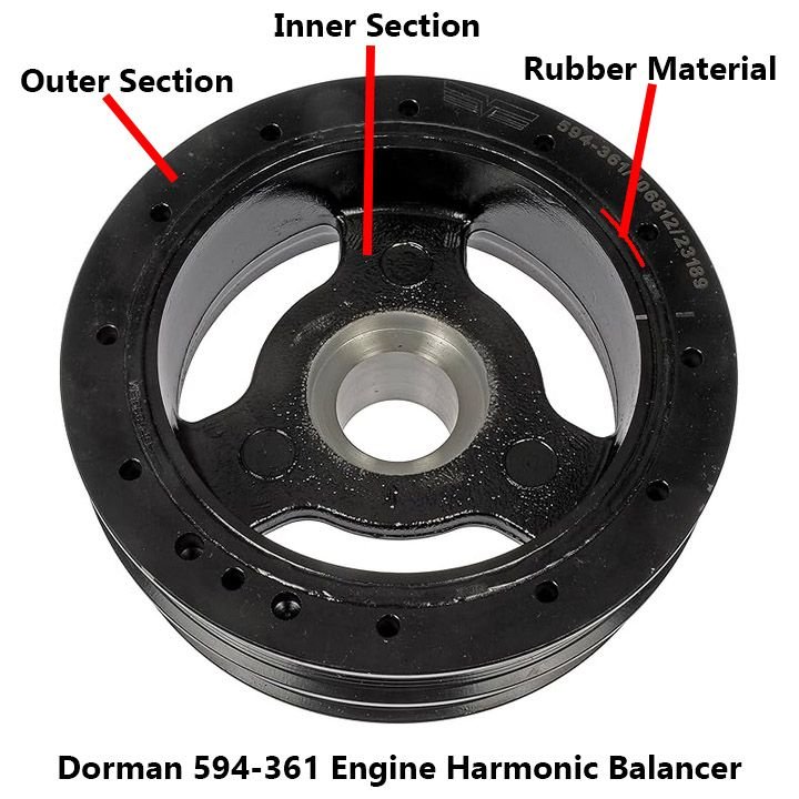

Finally, the Harmonic Balancer (HB) on my 2007 100k+ mile Corvette is starting to wobble. I've read a few of our treads about it and have come to some conclusions. Helpful comments are welcome.
There is a center and outer section to the balancer, joined together with a rubbery material. It's the only thing holding the center and outer sections together. When the rubbery material deteriorates, the outer section with the 2 belt pulleys gets loose.
When it gets loose, it will start to wobble. There are many reports of squealing, which is probably the outer ring spinning on the inner section, since this outer ring, with the pulleys, carries the heavy load of the accessories connected to the 2 belts. If this spinning goes too far, the outer ring can fall off the inner section (at whatever RPM) and cause serious damage.
Now, another assumption on my part.
The service manual indicates that the HB is balanced to the crankshaft. I think this is baloney. First, there is no key-way to align these parts. If GM was to balance the HB and Crankshaft together, they would have no way to align these parts again after assembling the engine. They would need a scribe mark on each part and there hasn't been any mention of seeing that. It would save more time and money to put a key-way in! I believe that the HB itself is balanced alone, like the aftermarket ones, but that the size and weight of it is designed for each type of crankshaft to dampen the harmonics (duh). The HBs were smaller and lighter on the old 327's. I built a small block 400 cu. in. and put the 327 HB and flywheel on. Wow, did it vibrate! Found out that the 400 SB needed special "unbalanced" HBs and flywheels to fully balance the "unbalanced" crankshaft. Perfectly smooth after that.
To sum this up, The Dorman HB, I bought, looks very high quality and has obvious balancing drill holes. It's a big job, but plan to install the Dorman HB, with a new seal and bolt, torqued to specs, and enjoy a no wobble HB for another 100K+ miles.
