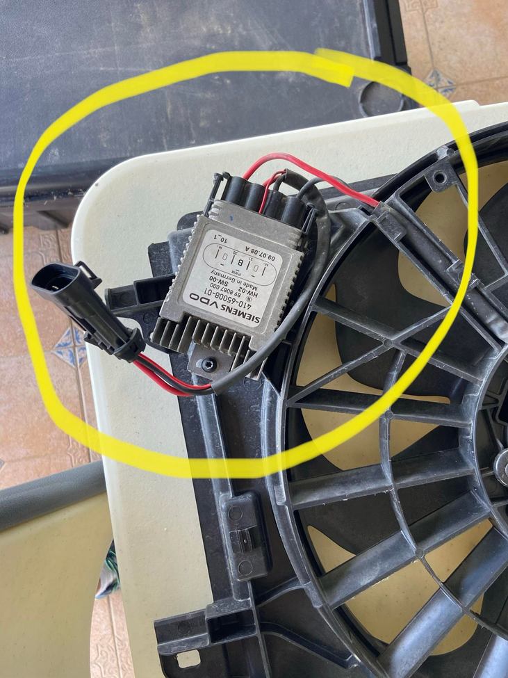

Start motor, make sure A/C in on and radiator fan should come on right away.
The HVAC system needs air moving through the condensor in front of the raditor when car is stopped, and so will kick fan on even with motor is not up to temp yet.
If fan does not come on, then check fan connector on side of radiator to make sure it not melted.
red dot it on the connector,
And when you have it apart, then check to make sure connector is not melted,
If upper connector is not melted, then need to check lower connector to PWM that may be melted down there instead.

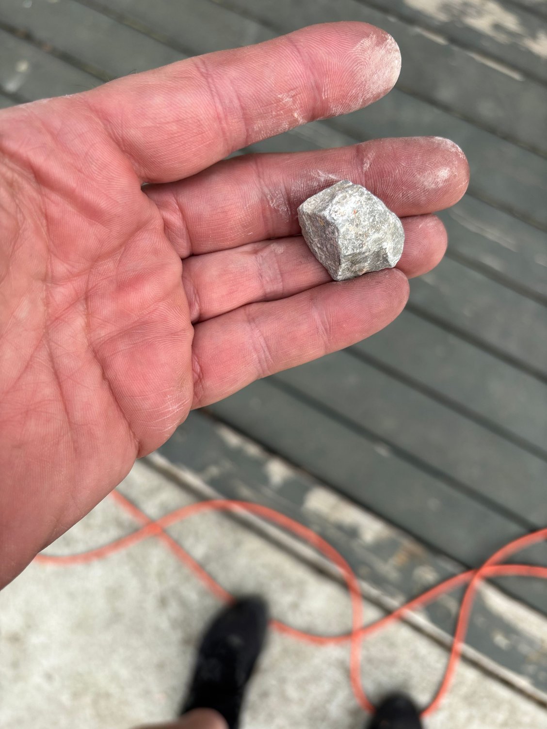

SOLVED!! A rock was jammed way in the radiator fan, where I could
not see. Fan was not turning on with AC on. Tried moving it by hand, wouldn’t move. Rocked it back and forth, thinking maybe a stuck bearing or something.
A rock dropped out and fan spun freely, then with back on, ran fine. I let the car run with coolant level good, occasional rev to 2509, temp was great, about 110 or so.
2 test drives, one for about an hour, was about 108 and 114 sitting at stoplight. No problems at all.
A damn rock

start to make sure engine fuse box fuse is not burnt out for fan. also check the connectors at the side of the raditor, since it a always hot, and should have 12 volts across the large red and black wires, If good there, then check the pwm connector for the same power.
From there, Check the ground for the pwm to the chassic, then jump the radiator fan ground wire at the PWM connector still connected to pwn. to ground on the chassic (how the pwm controls the fan via the negitive side, with hot directly to the fan at all times) and if fan kicks on, then maybe burnt PWM.
https://www.corvetteforum.com/forums...g-diagram.html
If fan does not still come on with power to the fan and its ground directly to ground to bypass the pwn, then problem with radiator fan, and with car off, just reach in to see if it free spins by hand, or is bindy as hell from it brushes worn out,or bushing starting to seize up
Note, You can rebuild the raditor fan motor on the cheap, but may just be easier to just replace the entire fan assembly instead.
Short of that and PWM still good, then negative control wire off the ecm to pwn has problems, or aftermarket tune that screwed up the control voltage/temp setting in the tune instead.
So to check for that, again, start motor, turn on A/C, and the voltage from the ecm negative control wire(green) through multi-meter with negative probe on it, and other probe of the meter to 12V positive at the battery, should have the voltage at slightly over 5 volts. You can start with the connector on the side of the radator, but make sure to check it as well on the PWM connector too.
Again, when A/C is on, it will control the fan to turn on (increase the negative voltage on the Green wire to slightly over 5 volts on the digital meter to the pwm, for it to start to pulse the fan on.
Or fan stuck due to rock wedge in it, as you found out the case instead.
