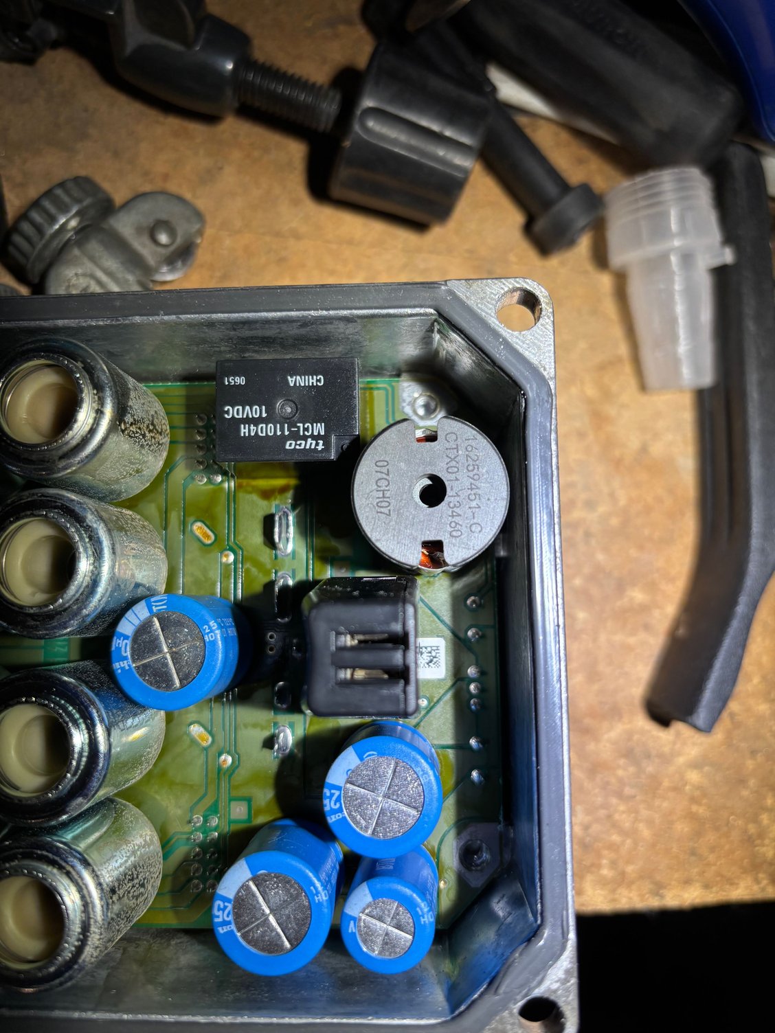

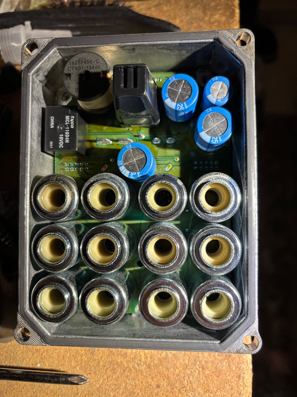

I’m currently taking apart my cars ebcm to resolder the connections to hopefully fix its abs vault. I’ve gotten this far but cannot get this first circuit panel off to get to the second. I took out the 3 torx screws and the board still is stuck. If anyone has any expertise with this please let me know how you got them apart. Thanks in advance for any help!

There are soldered interconnects between the PCB you can see and another one below it. In addition, there are pins from the external connector with soldered connections to both boards. All those pins need to be de-soldered to get the boards out.
Whenever you read someone say that you just have to remove the screws, it's a dead giveaway they're guessing and have never actually done the job.
This is what you're up against: https://www.corvetteforum.com/forums...post1607068544
